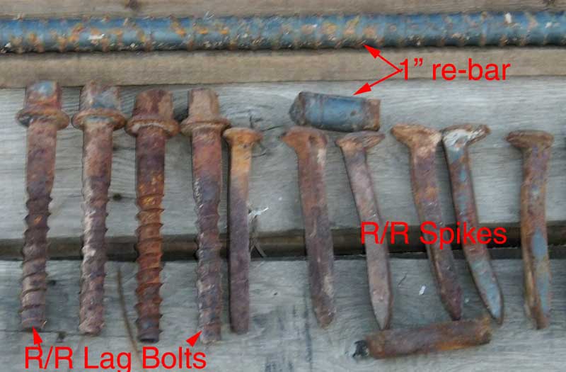

Hi Alan,
The "feet" will be made out of cut off R/R spikes & R/R Lag bolts. I have a few hundred of them. Should I run out ;) I have some 1" re-bar. The old boiler has quite a few knobs on it already.

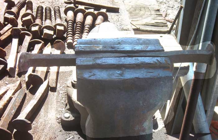

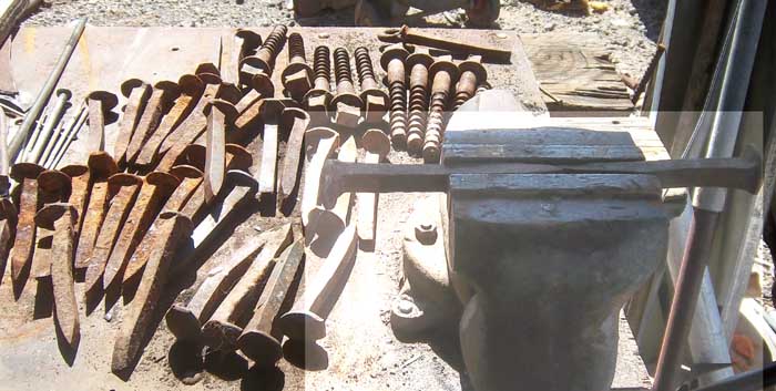

Sorted out 50 to 70 R/R spikes & lag bolts to cut off for the feet. Have a lot more if needed.
Round head UP or Down?? Not sure yet, What do you think??:confused: How does 1" long sound to you???

Not real happy with RR spikes for the feet. Contact area, 1/2" square too small, afraid that they will rip off when turning or worse yet rip the tank.
