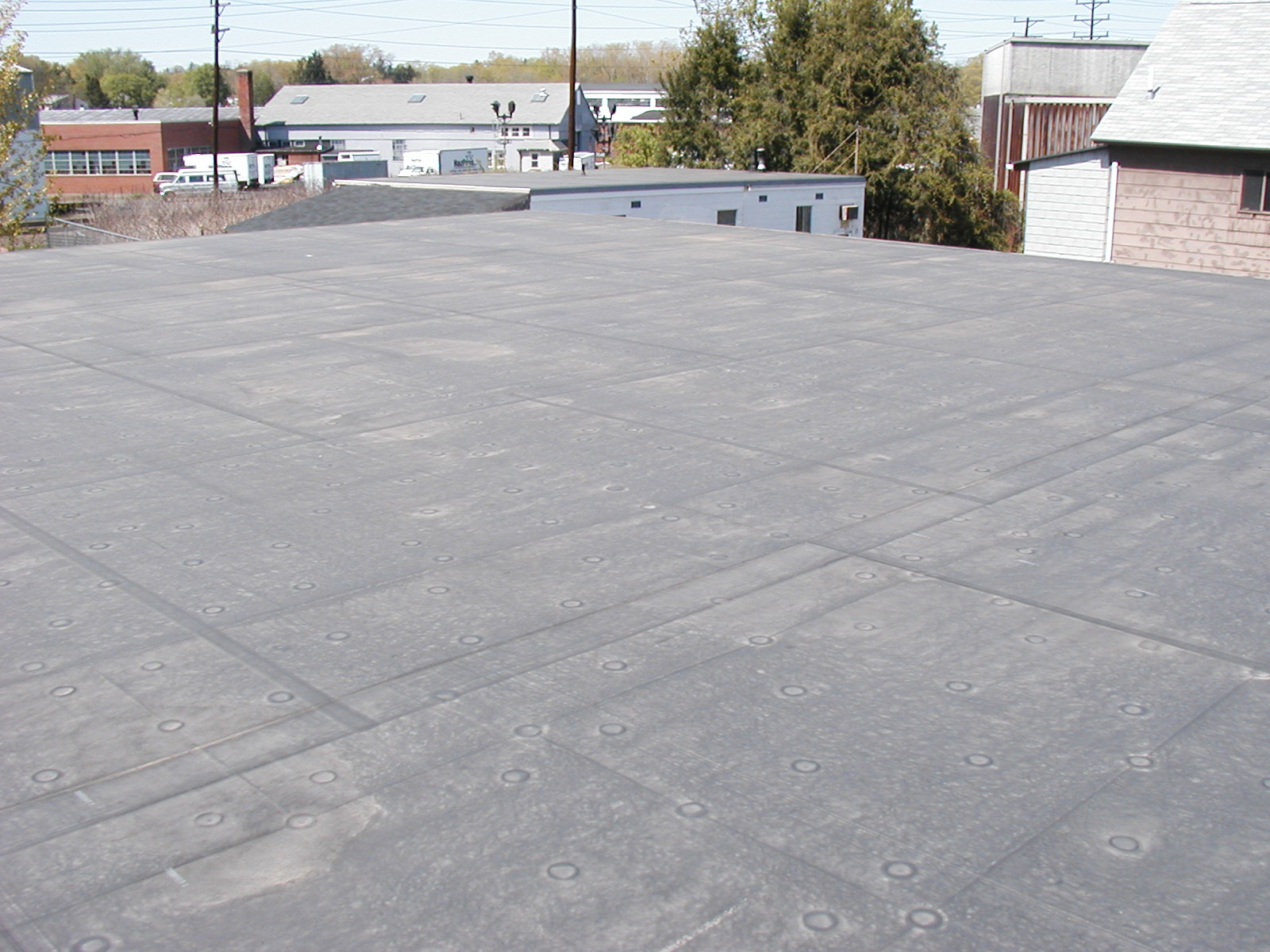

The problem is the epdm is nothing to look at, just flat black rubber, but in your case if you can't see the roof, it might work out.
The incredible thing about all these new single ply materials is that they come in rolls as wide as 20' and 100' long so far less seams compared to other materials, did my old 3000 sq ft shop roof with only 5-6 seams. Also it's impermeable to water unlike asphalt shingles or rolled roofing. those attributes make it the first choice for flat (the proper term is low slope) roofs.
JB.

The EPDM samples we have are colored. I have to find the brochure, they still weren't very pretty, but there was white, brown, silver and black as I remember.
   / New roof - Light or dark shingles #28
we put a whit pvc roof on a roof at work and the surface was amazingly cooler than the black rubber roof beside it.
The only problem with you need a #10 welding shade to work up there in the summer with the reflection.
