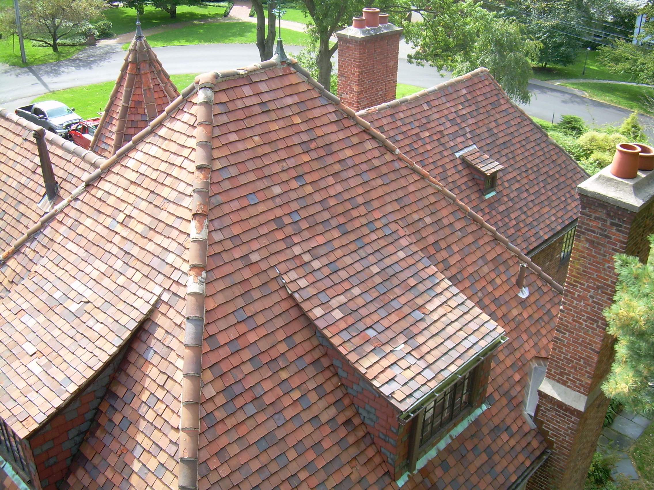

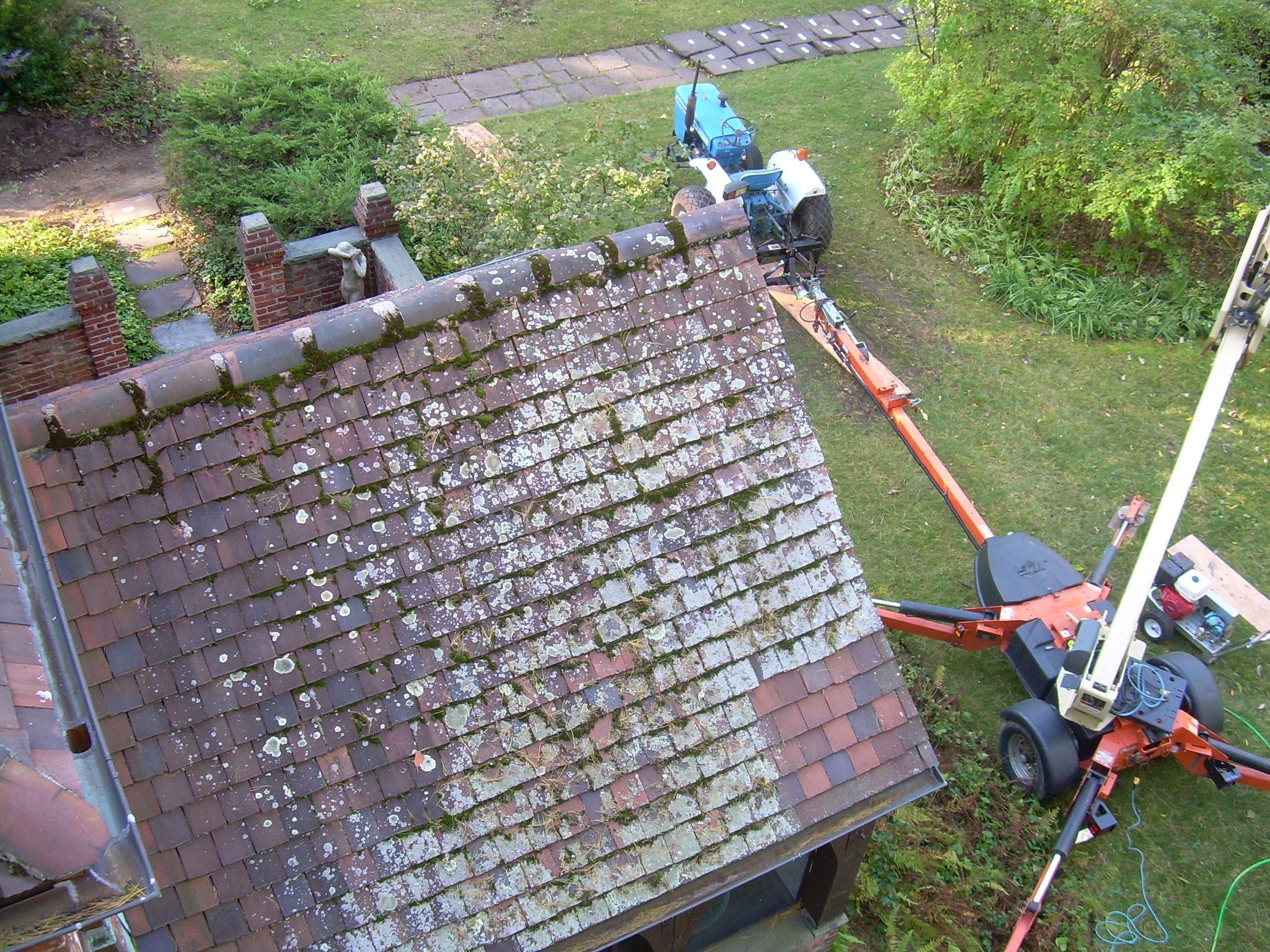

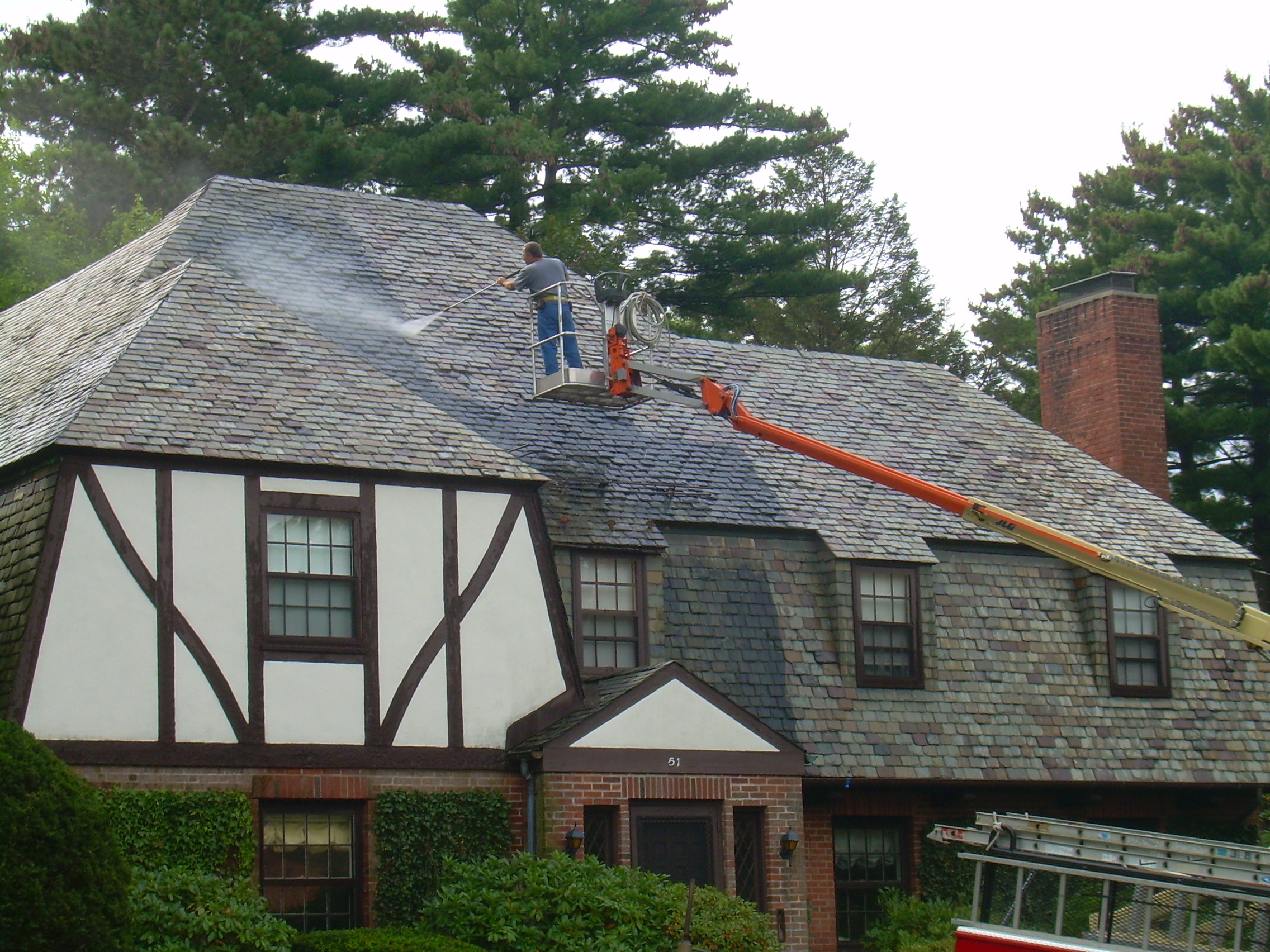

I mentioned that my white shingle roof was stained but I started looking at roofs while driving around, all the roofs are stained this year, even black ones. we had alot of rain this year so maybe that is the cause. Bobrip mentioned the zinc in the shingles, never heard that but I now they put a zinc strip across the peak, not sure how good it works.
This black roof I worked on today had stains and there is no trees over the roof! I made some decent money cleaning these 2 roofs.
   / New roof - Light or dark shingles #37
nice pictures from your Hyda lift. How high will it lift a worker?
   / New roof - Light or dark shingles #38
Good grief, that's not a house, that's a hotel. Nice pics.
