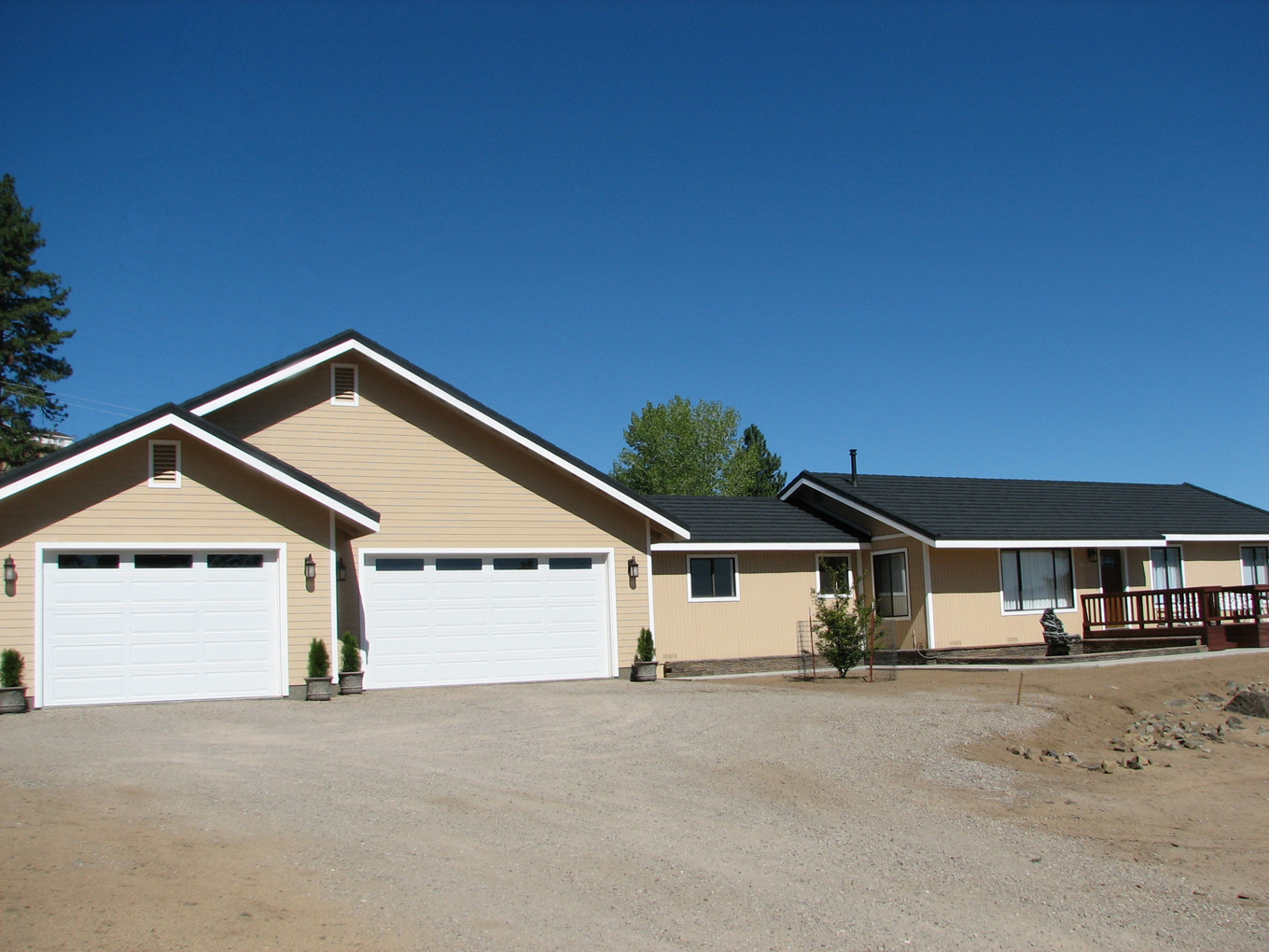

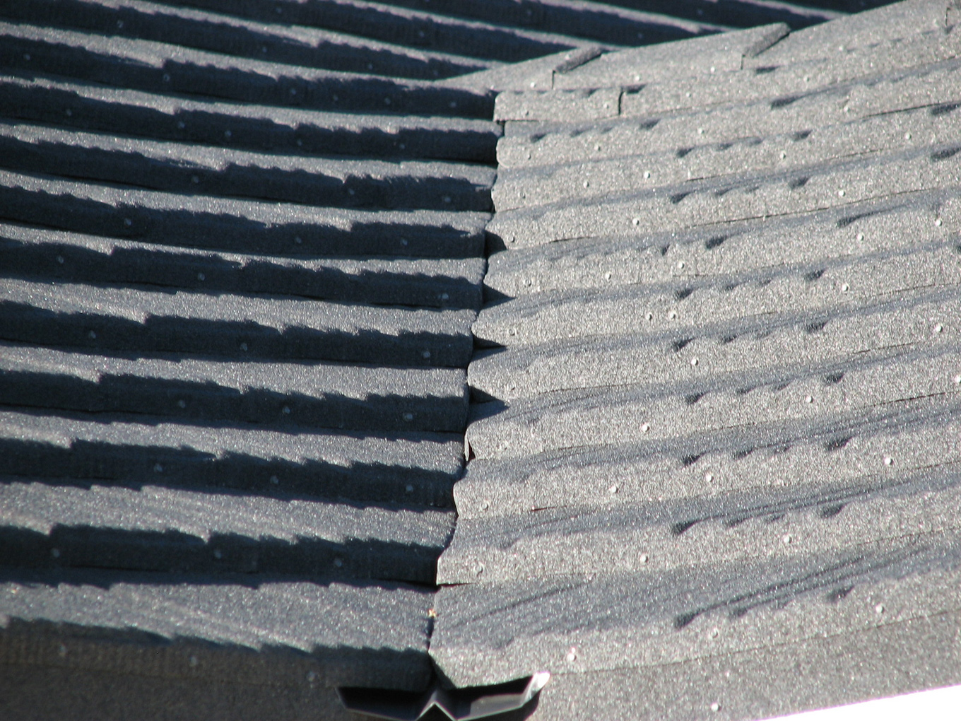

I'm partial to dark shingles. When I built my addition, I installed stone coated metal shingles. Pricey, but if you do it right the first time, it only hurts once. :D

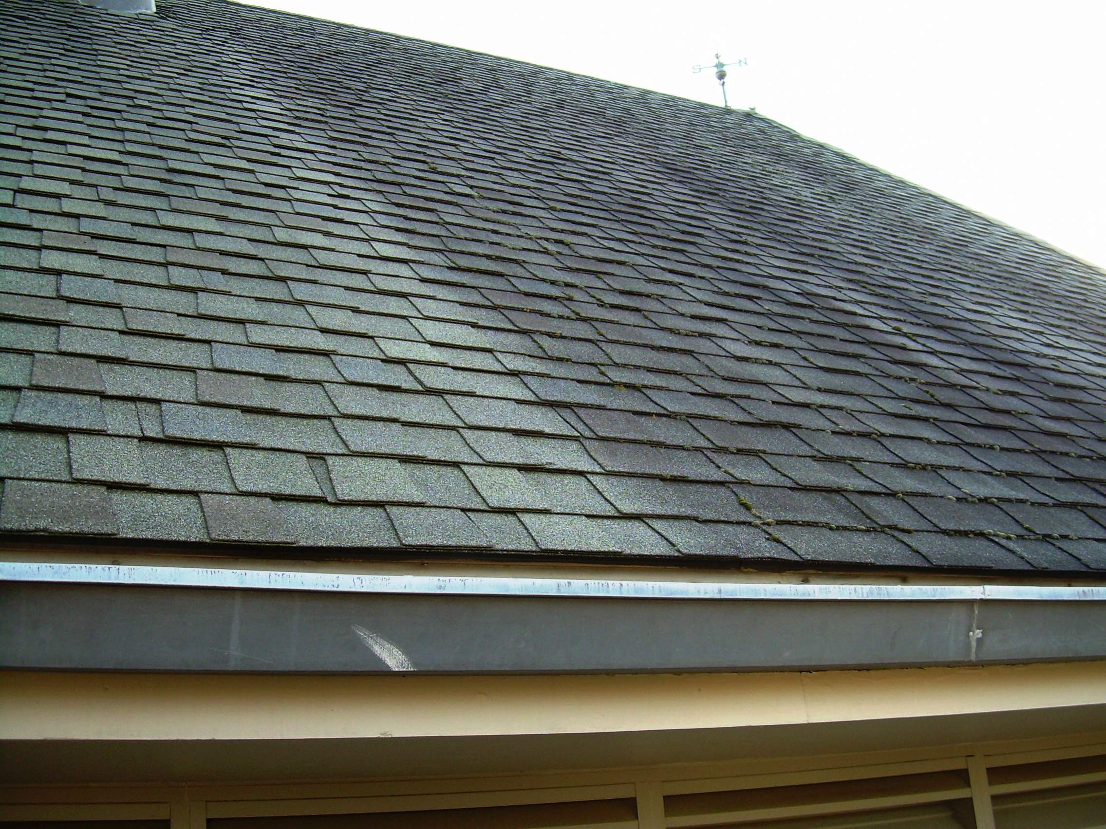

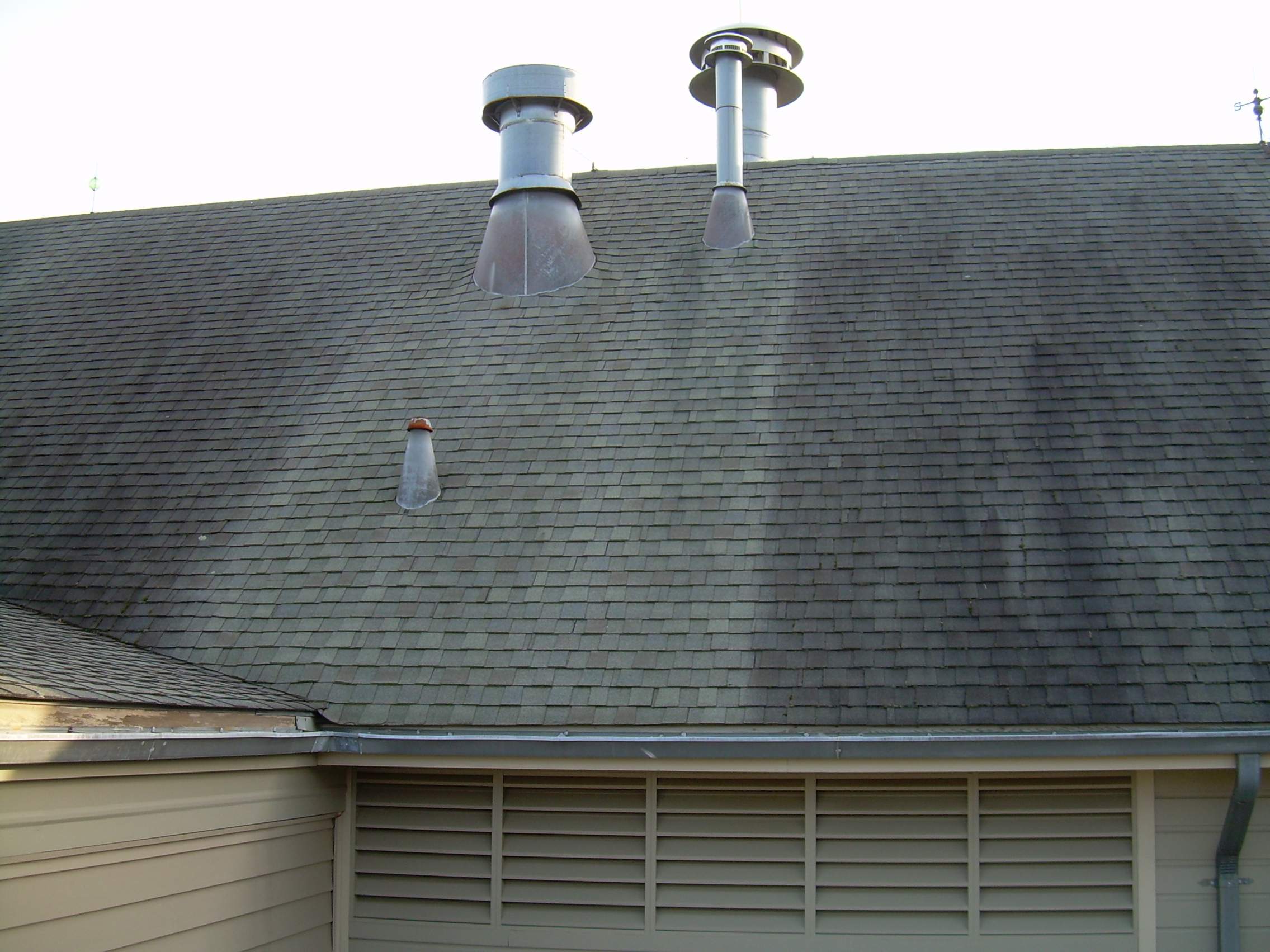

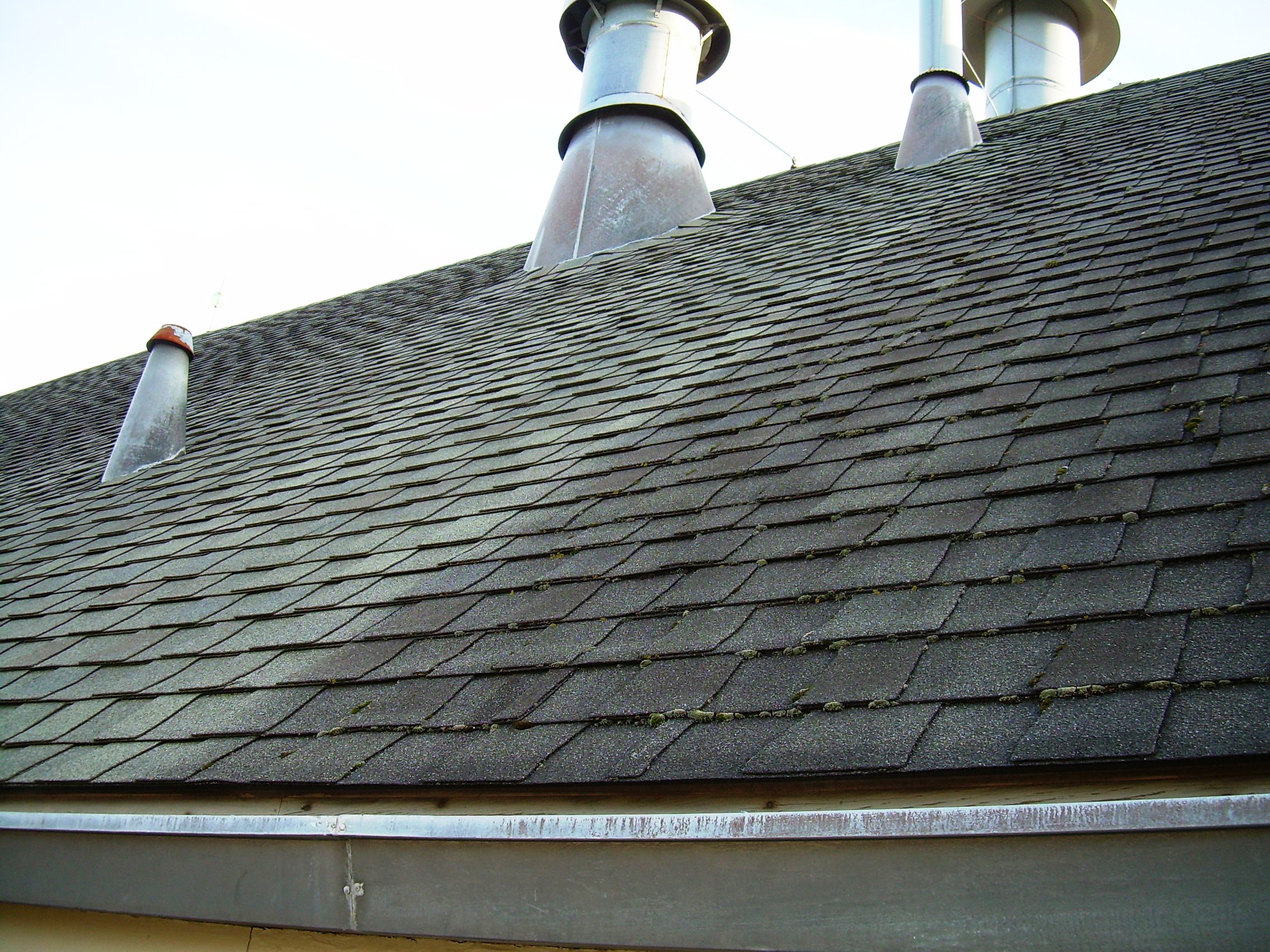

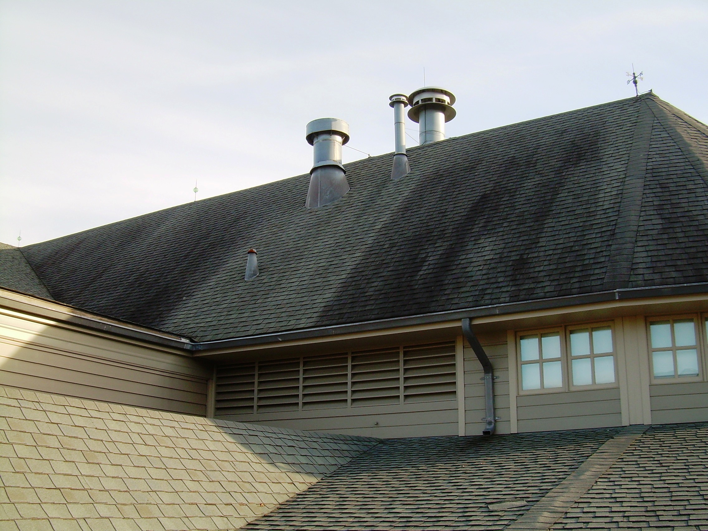

Just bringing up this thread to give a visual of the effects of certain metals on keeping roofs from staining and growing moss.
Was looking at a job on a school yesterday, they want to clean the roof and install zinc strips, they were convinced at the effectiveness of metal strips by the fact that the roof was so clean under the large air vent stacks.
I always noticed that on certain roofs it would be clean in areas under metal flashing's etc but never put 2 and 2 together.
I'm convinced now, look at the difference, not only no moss but no enviro fallout stains, the shingles are pristine under the metal run off.
I can understand that moss might not grow with whatever is coming off the metal but how does it prevent the staining which doesn't seem to be a growing type stain but more of just dirty.
These metals are lead coated copper, galvinized and stainless. this is the north side, south side is clean.
Any chemists know the answer.

I think it's mold. I have heard of doing this, but my roof is hipped and this will not work very well. New shingles have zinc built into the shingles.
   / New roof - Light or dark shingles #44
Zinc is a natural anti-plant anti-bacteria metal, the metal oxidizes and kills pretty much every thing it washes onto that has any king of live micro logical type growth going on. The pics above seem to have copper staining on as well, it acts similarly and keeps down most growing plant life. (also can kill trees if you were to nail a copper/bronze nail into them.)
