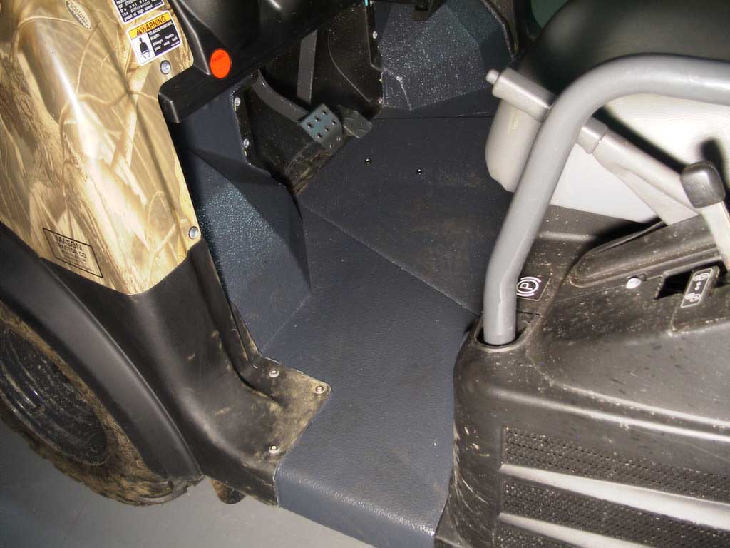

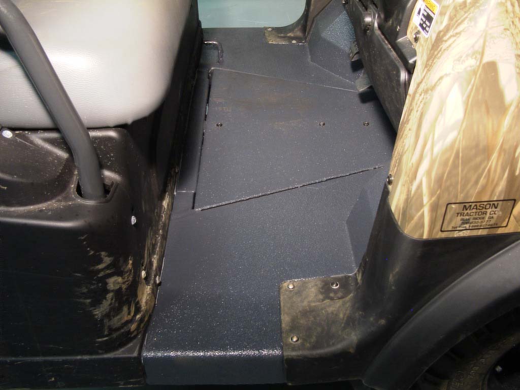

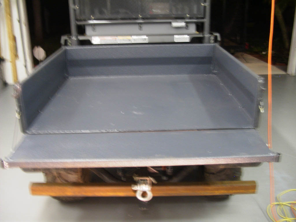

Here's a few updates on accessories I working on. I sprayed my bed Monday with a Perma-Tech Spray in liner. (Color Matched to Kubota Grey) and also sprayed the cab floor after removing the factory mat. (Found water and mud already collecting under mat)
I also removed the bed and under coated the bottom side. This will help quiet down the bed rattle.

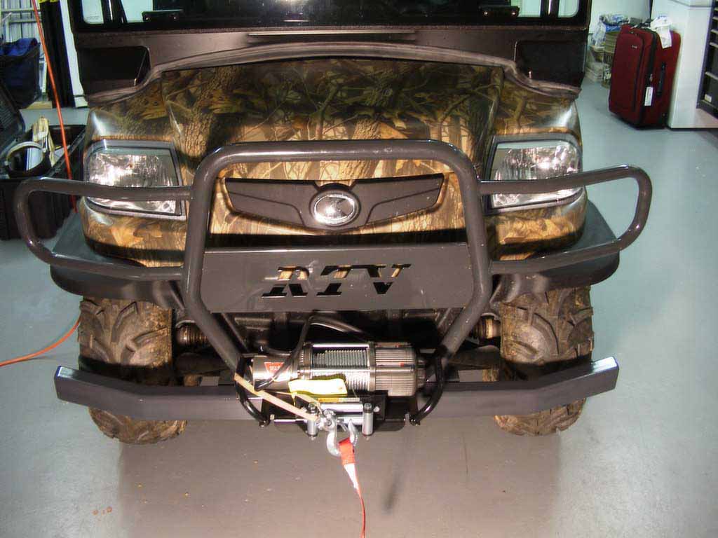

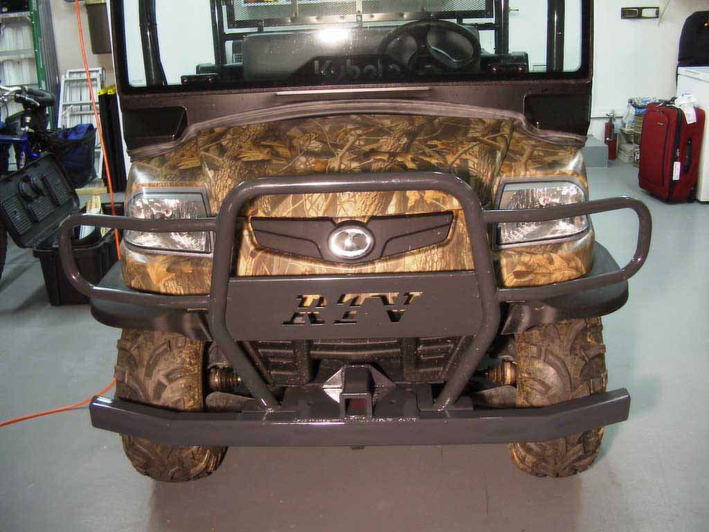

Brian,
I made the Front & Rear bumpers today but ran out of time on the rear so it's only laid out and no supports yet.
I built a 2" hitch into each bumper so I could use the Warn 4000ci with the multi mount system.

Front bumper with Warn 4000ci
Notice how it's now 20-22" off the ground !!!

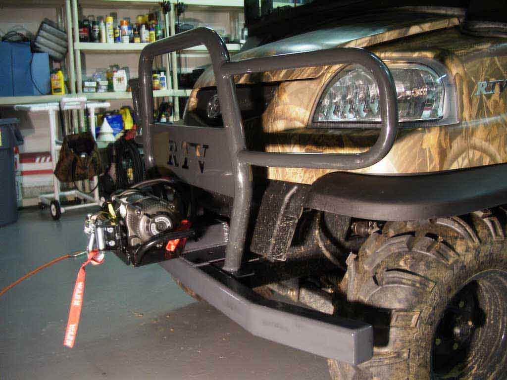

Another picture close up w/winch

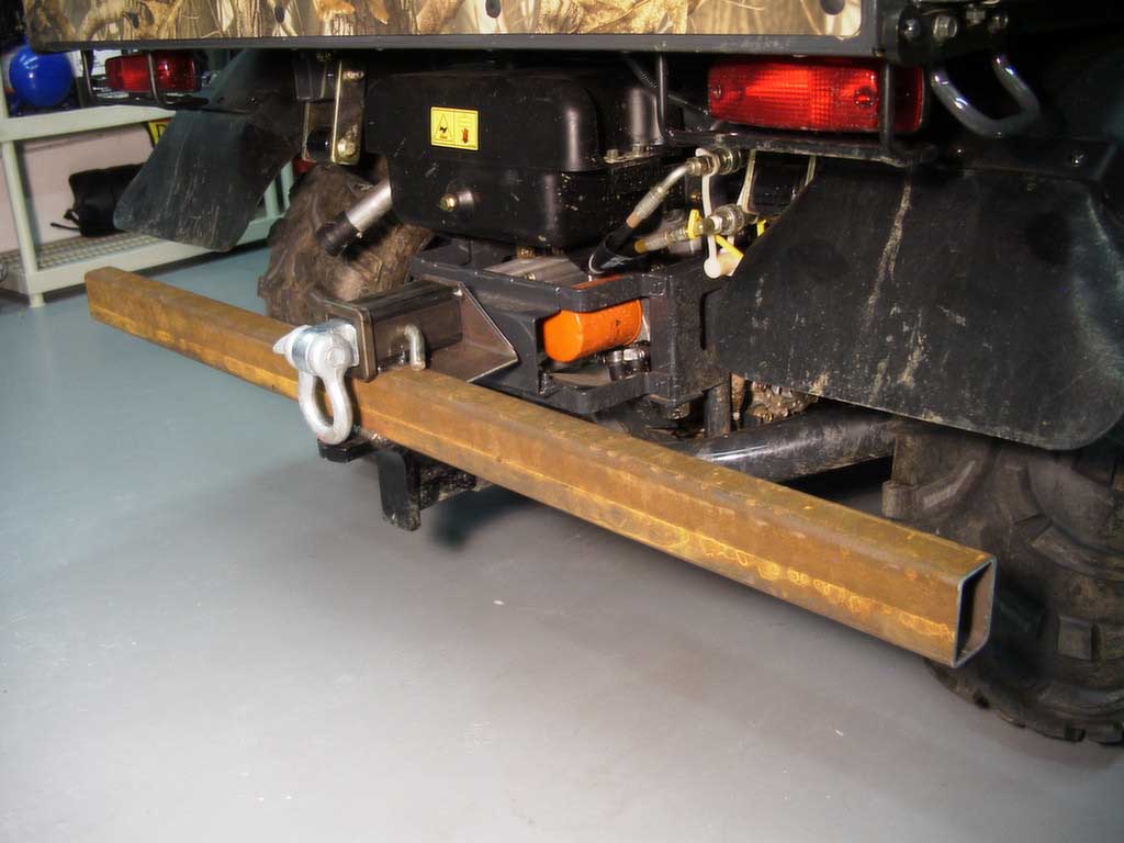

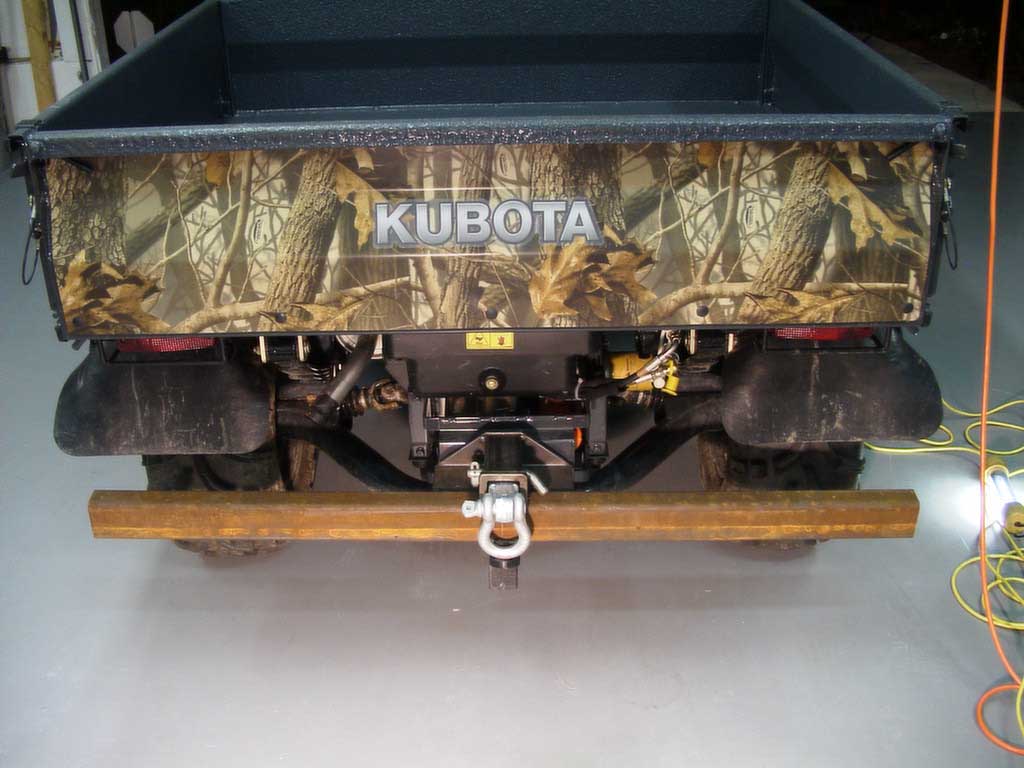

Rear Bumper (Not Finished) But you can get the point.

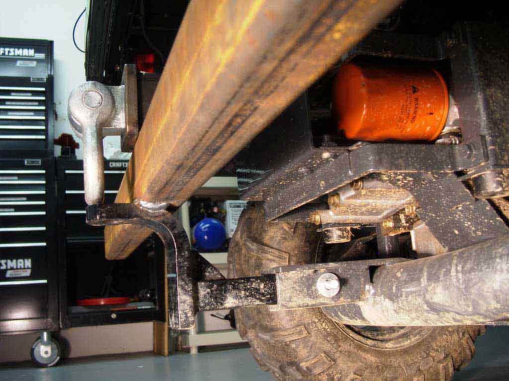

Rear Hitch from below showing use of 1 1/4" hitch to mount bumper. I will add two supports back to rear axle before I finish. I left the end of the ball mount sticking out past the bumper so I could use that to pull a finish mower without using a 2" ball mount in the high hitch.
