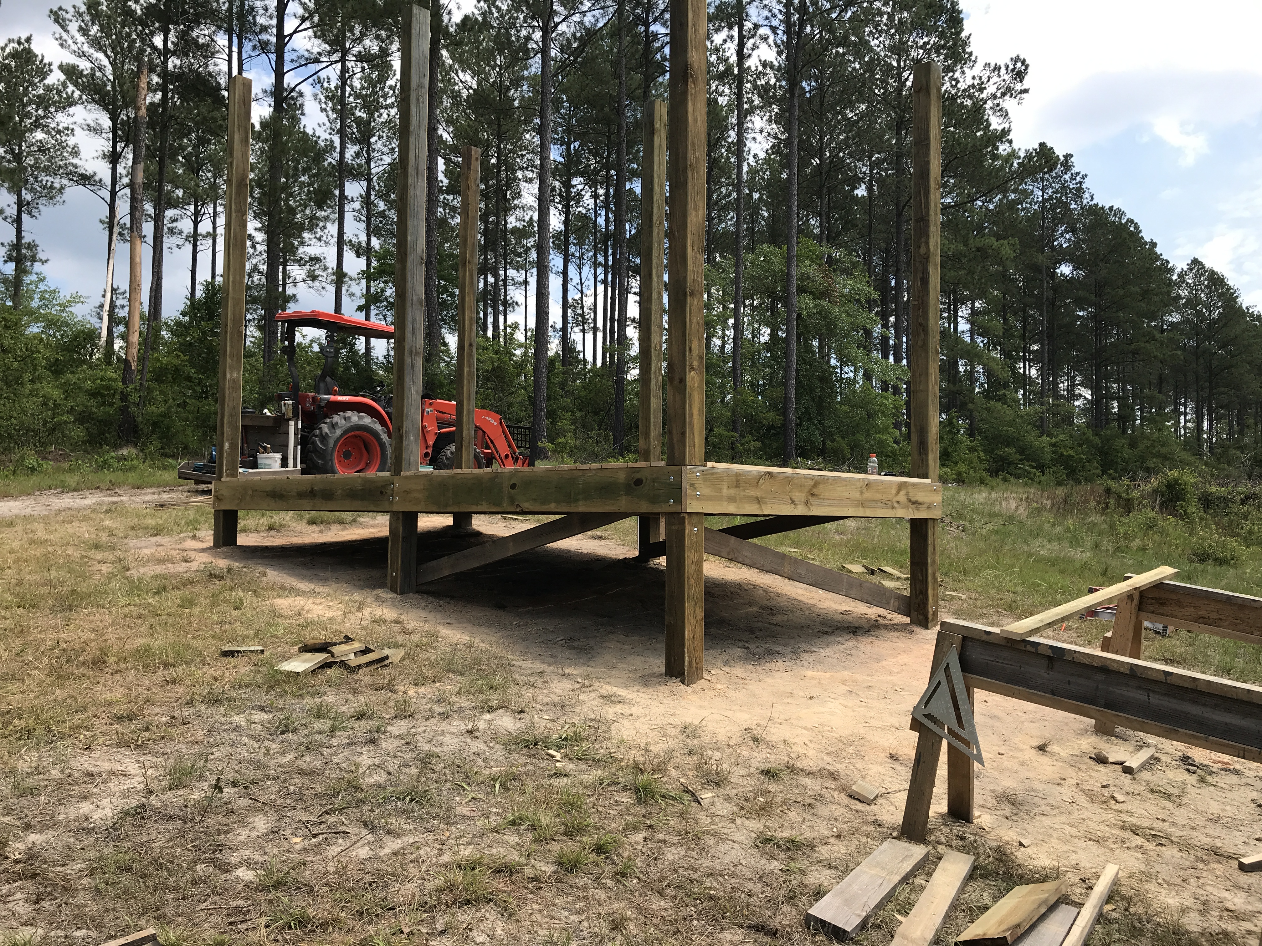

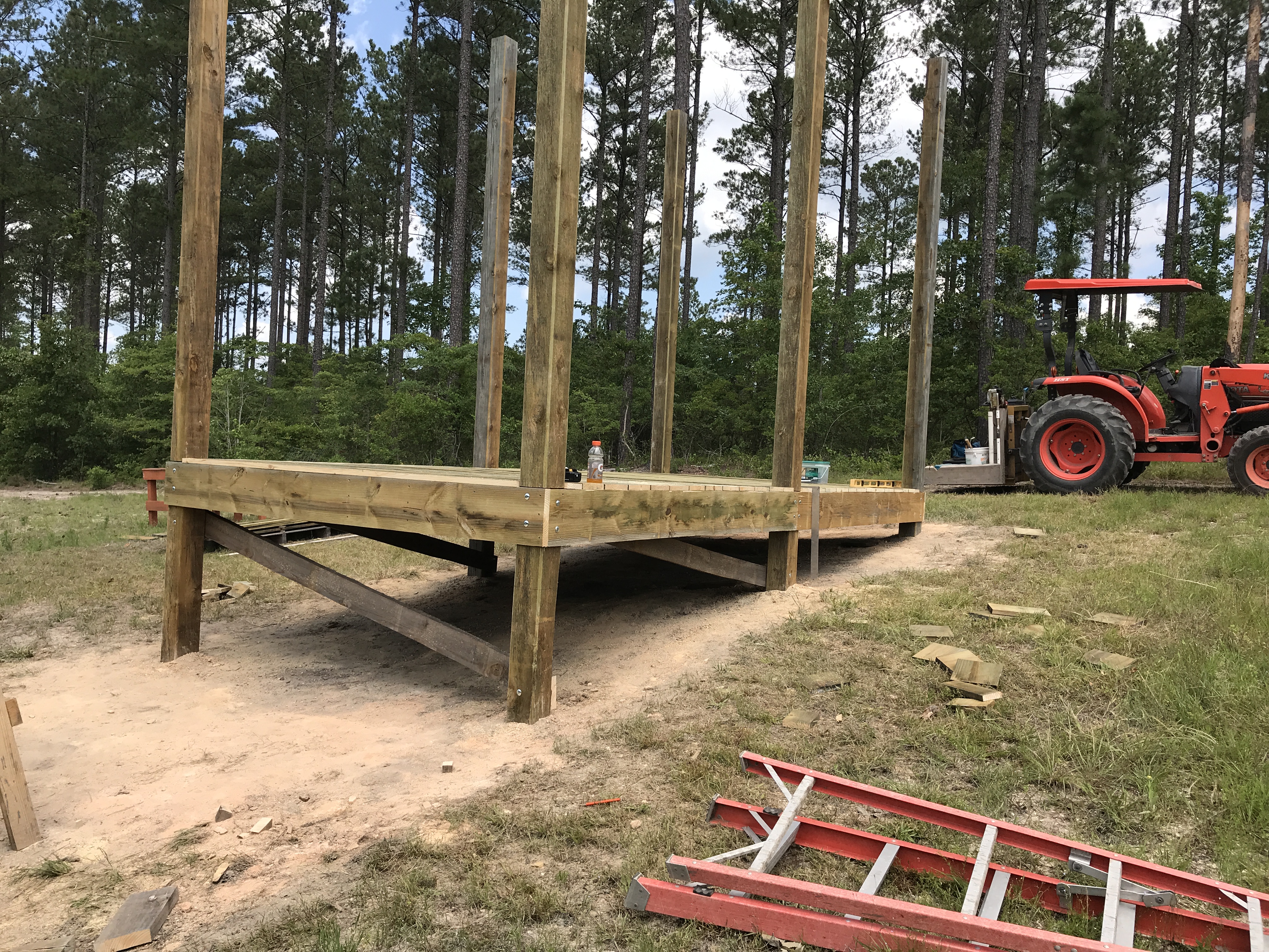

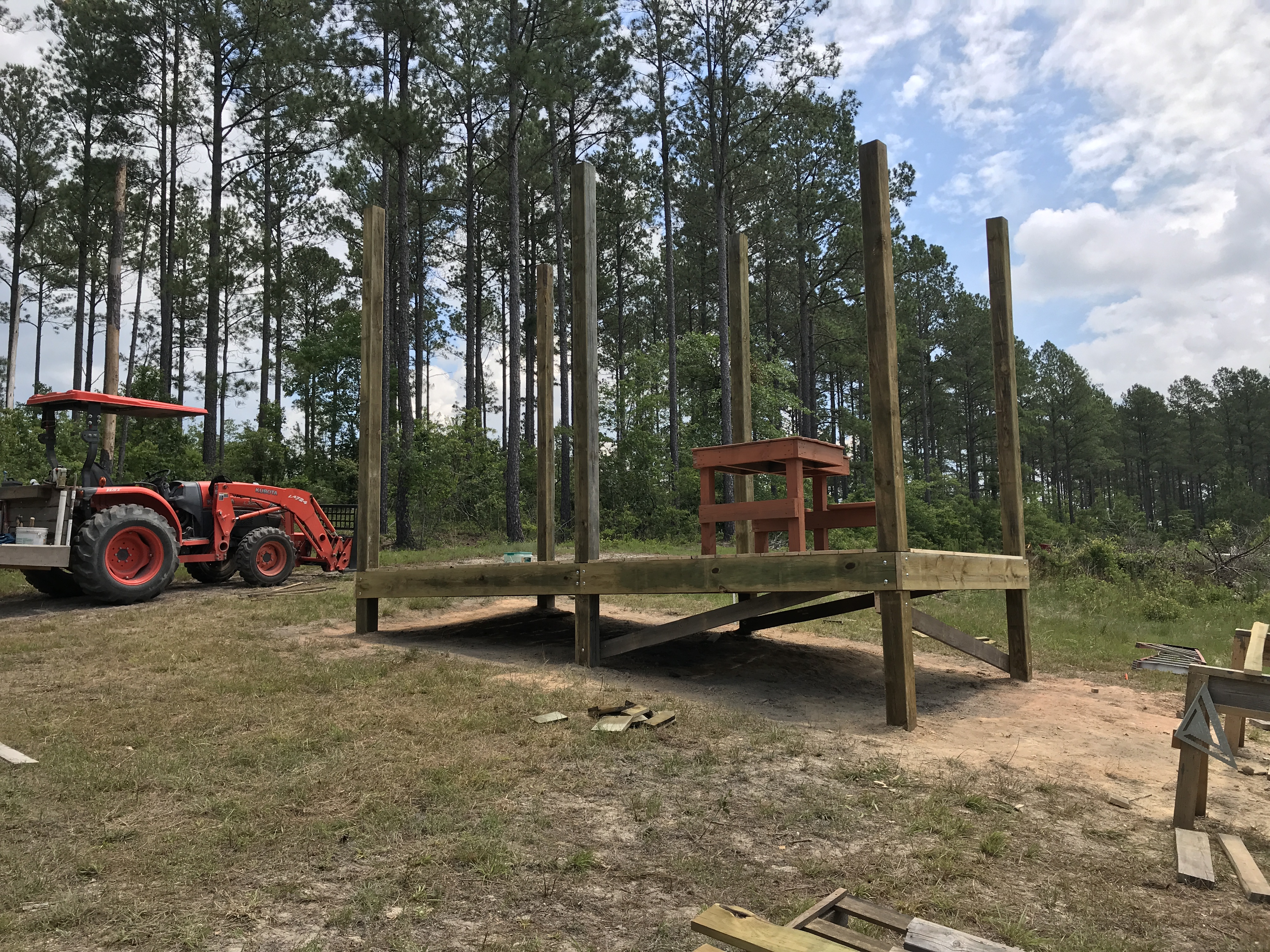

Ok, got the base structure done

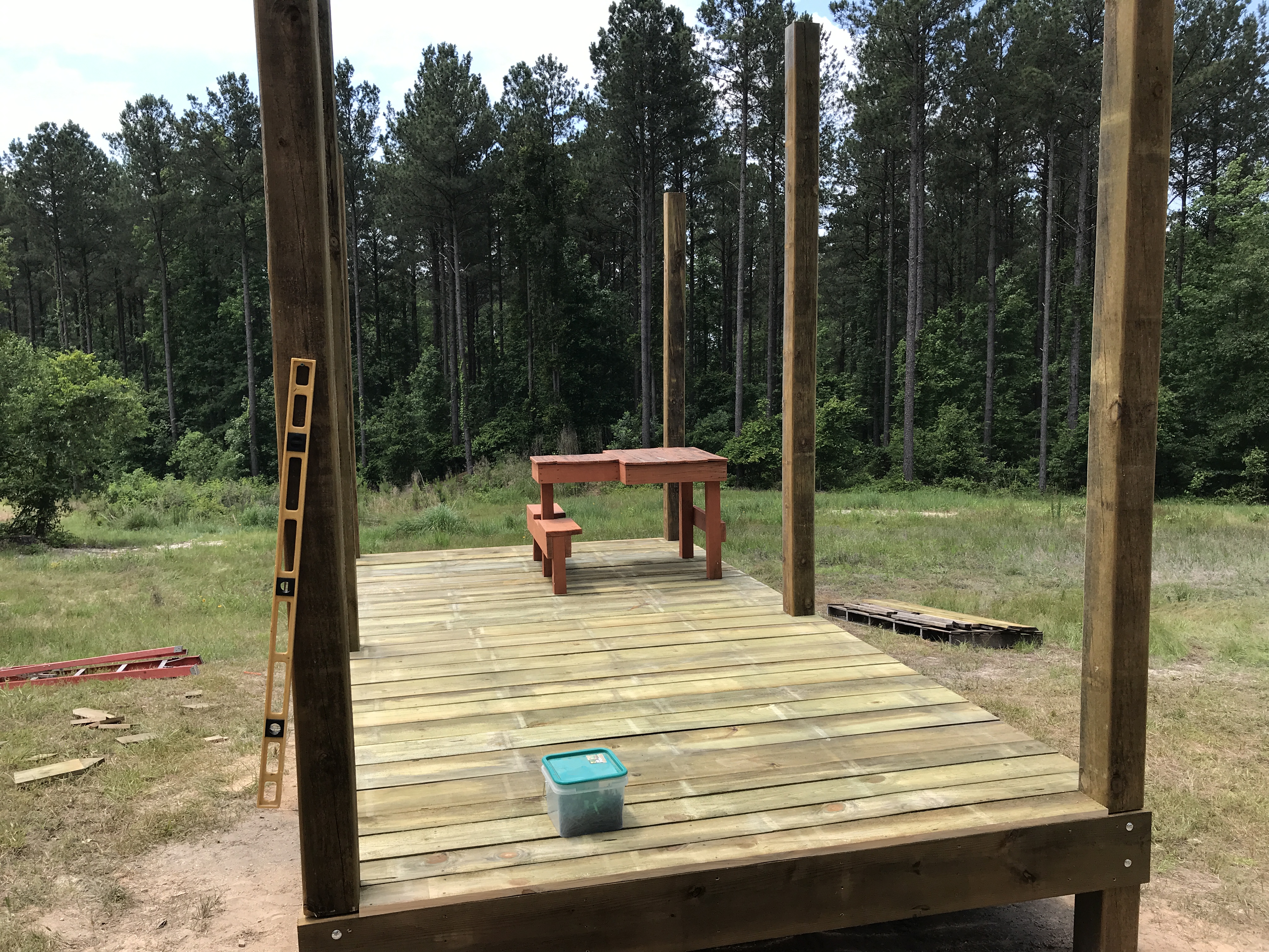

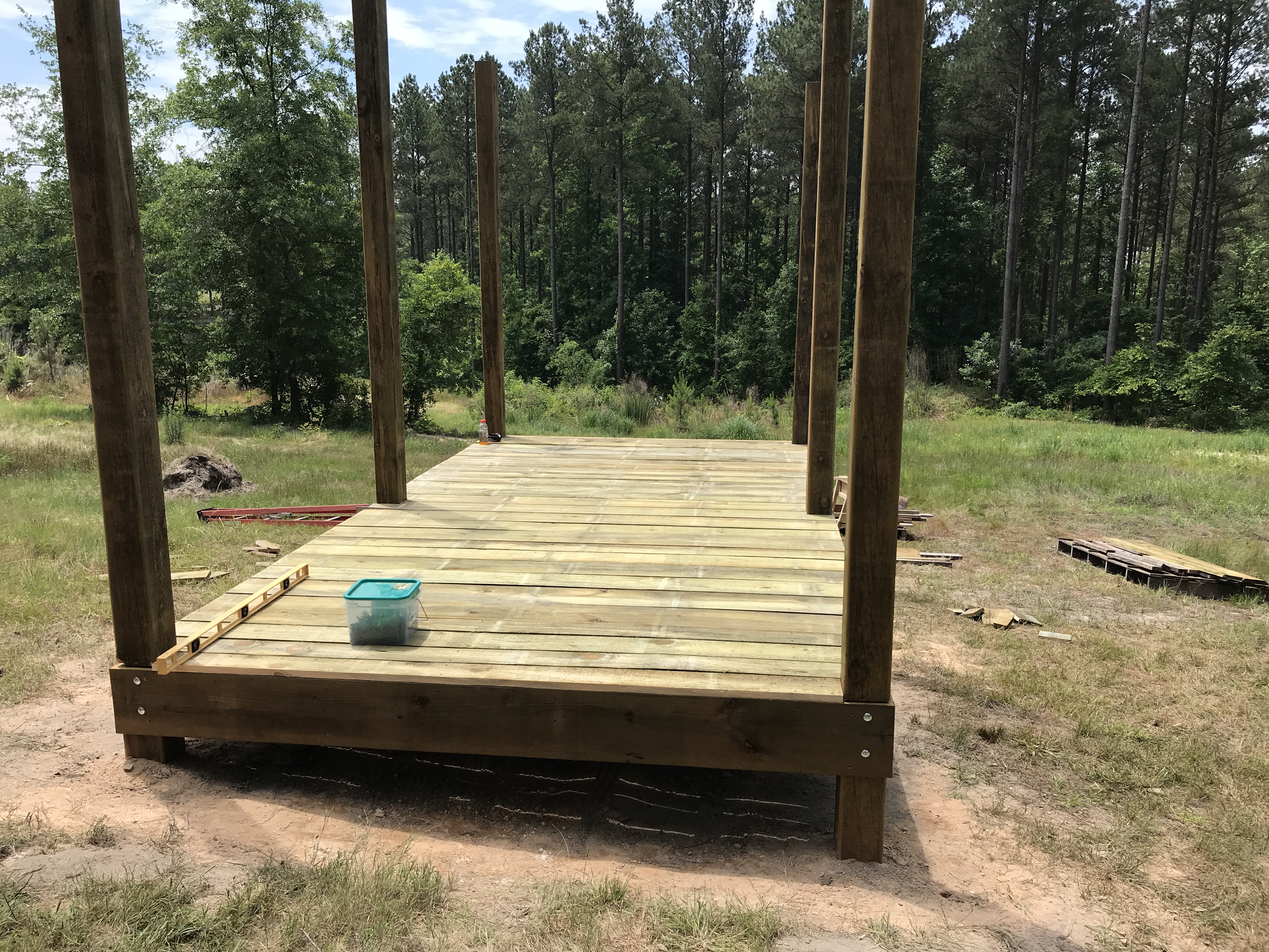

How bout a little decking..
And one of my little shooting benches to verify rail height.
