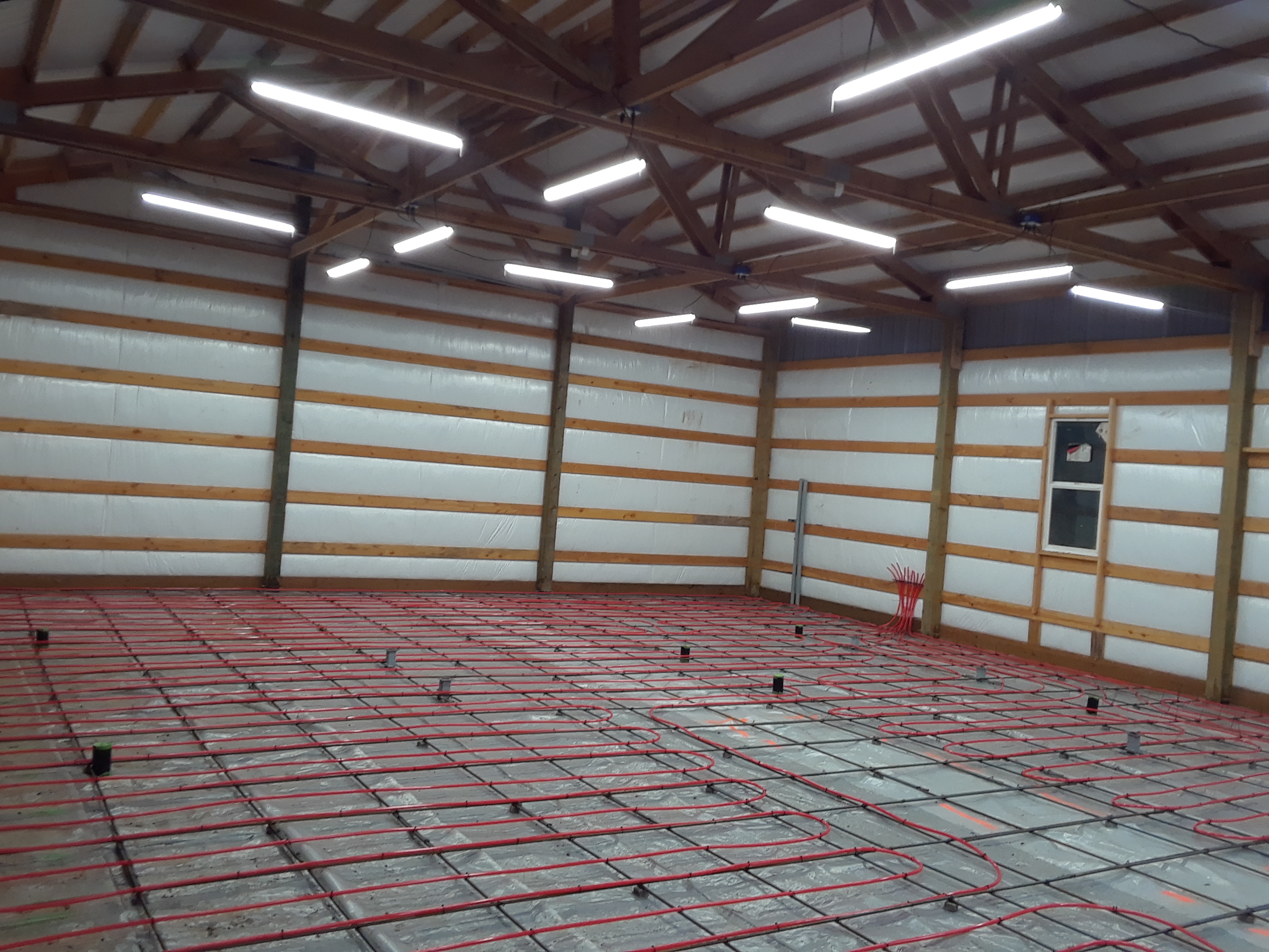

Consider labeling your loops. Then down the road if you need to increase the flow in any one loop or notice cold spots it will be easier to make sense of it.
   / New shop build, beginning stages with questions
#222

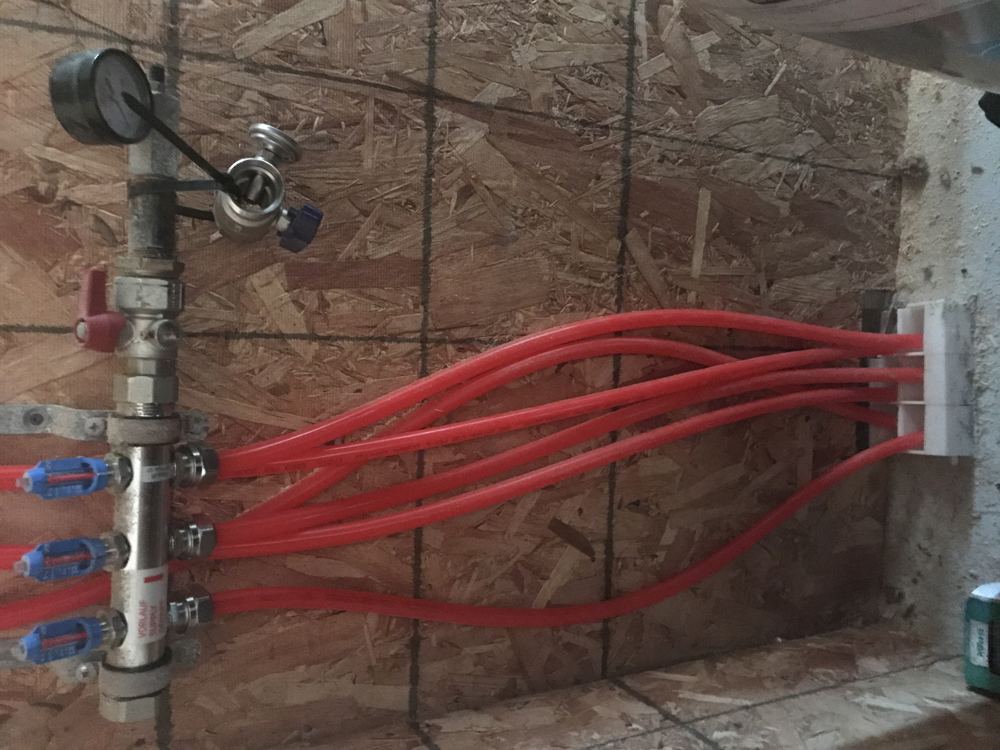

Yeah, I zip tied the loop ends together but I'm going to sketch out the areas to document better, I'm not going to be using the floor heat in the near future (probably at least a year out, there's much more important things on the list). I'm likely going to take a couple 2x4's and tie the in and out that far apart to give room for manifolds, right now they're just zip tied to a rusty piece of rebar I found...
I thought about paper, maybe I'll get a roll of butcher paper or something... but it might not be too hard to clean off the insulation backer.

That looks really nice. Where will you be bringing your water from? Does that line go through the slab too?
#224
Pump house is ~75' away, eventually I'll run a line from there to the bathroom area. The two conduit's by the manifold area are electrical and likely internet.

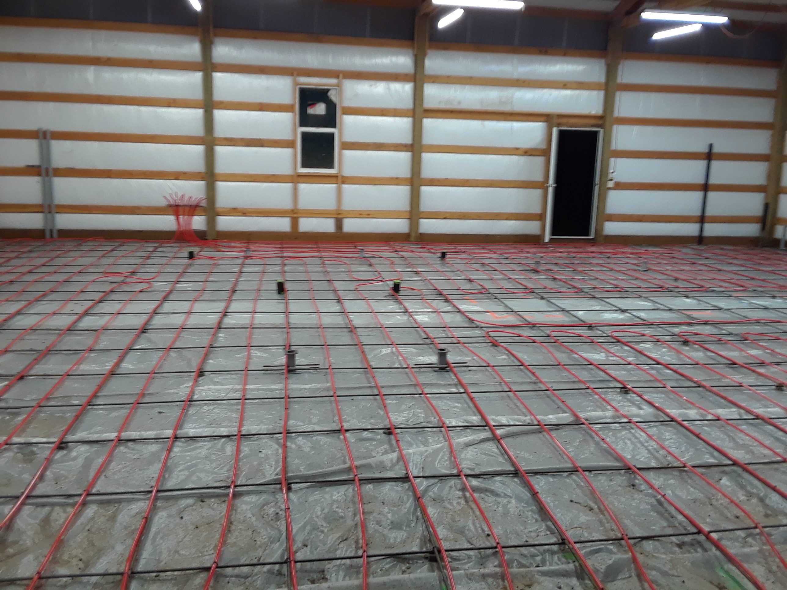

Before you pour concrete, I would put grey PVC conduit sweep elbows over each line where it comes up through the slab (and possibly add a 1' piece to extend them up). That way the concrete guys cant accidentally run the power trowel into them and make a mess.
If those are 1/2" lines, 3/4" conduit sweep elbows will slide right over them IIRC.

How many loops and how many feet per loop?
ANd save be from going back through the thread trying to find it again...how big is the shop?
Based on pics,I would have put the loops tighter together along the outside. Then progressively space further apart toward the middle. Instead of all evenly spaced.
Also, did you do insulation board under the slab?
#228
I'm in the Northwest, so my winters are vastly different than the central and lake effect area... if it's below 30F for a couple days that's generally a cold winter :), about 10 years ago it got down to 6F for a day but that's rare. That said, I'm not going for perfect... I'll have a wood stove at some point for the majority of heating.
The shop is 36'x48', there's 5 loops 300-320' long, no foam board
