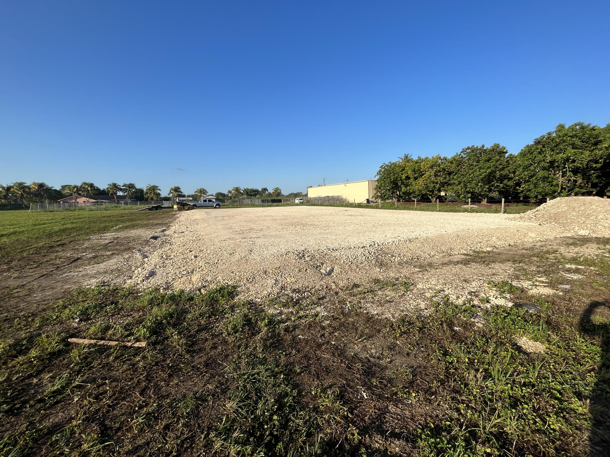

Branson 4520r 5520C- Yanmar FX235-D - Bad Boy rogue mower
36 x 120 with a few windows. The yellow one in the back round is our old building (1993) 70x100
More pictures coming as it goes up.

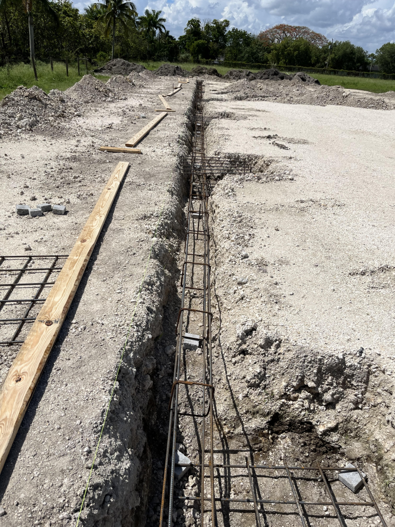

/ New shop going up!
Hurricane reinforcement before the mud goes on. The large craters are where the beams go up, its rated for 180 mph wind
/ New shop going up! #8
Exciting and EXPENSIVE in today's building materials market, labor not withstanding...
If you can do the work yourself, which YanmarFever seems to be doing, you'll still save a lot of money in comparison.

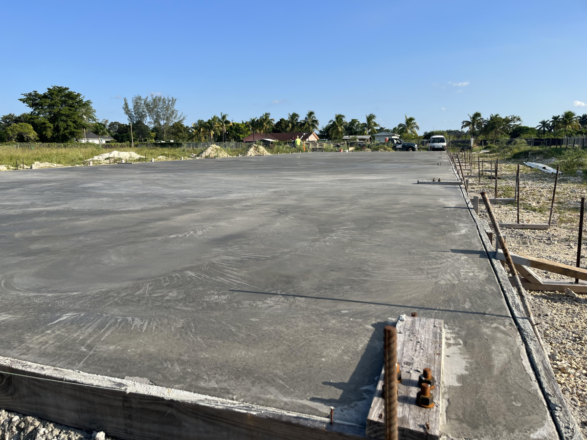

Turnip, the beams are held in place by J bolts that are 24" long, they go in the concrete, J down, threads up and the beams are bolted to them.
That way they are anchored onto the slab, it makes for a great anchoring system. I will put them in the next picture, when we pour.
The trees are palm trees with coconuts, we drink the coconut water now & then.
#12
Turnup, see the J bolts sticking up (with nuts on them) they go 20" into the concrete, then the beams get bolted onto them.
The boards are like guides to hold them during the pour,
They are a royal pain to set up because if they are a little off you're skewed.

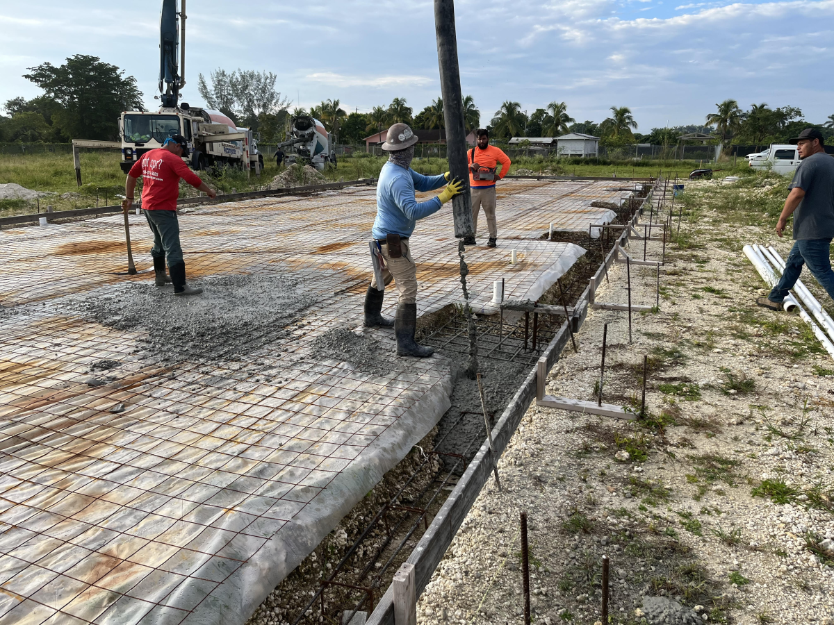

/ New shop going up! #17
Why the pump truck? Looks to me the trucks could get all the way to the slab.I would have saved the pump truck money if the mixers could get to the slab. 30 years ago I drove a cement mixer for a few years and about the only time we poured in a pump truck was for multiple storys. If the trucks could get to the pour they never had a pump truck. But I will say as a mixer driver having a pump truck is the easiest day at work ever.
#18
There were to many piles of soil and rocks to move, and the ground on one side slopes to much.
That's why the pump was called
It took 16 trucks loads to pour that floor !
