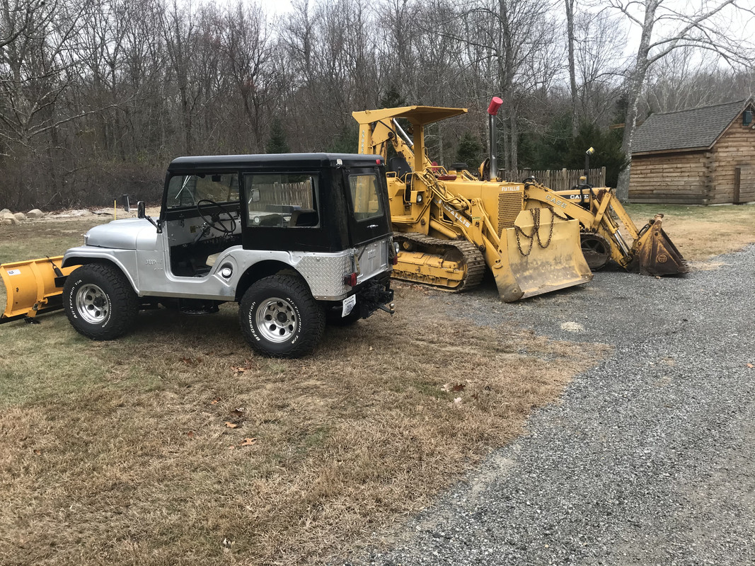

Took “black” and “blue” (seat color) out for spin also to keep carbs clean

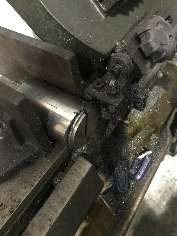

So I’ve had this ?heat treating? Oven for 20 years. PO had piped it directly from his inside NG line. I guess it worked but I needed to use on LP. The 18 orifices were almost 5/16”
I couldn’t get any heat or good flame. So time to make a more appropriate LP orifice(s).
18 brass orifices, 5/16-18 and #14 drill, added 2 flats (quick and dirty) for 1/4” wrench.
Size F drill to clean up and tap.
Easily went up to 1400 deg F. I probably could get a bit more out of it fiddling with a mixture, but anything above the tempering temperature is fine for me.
