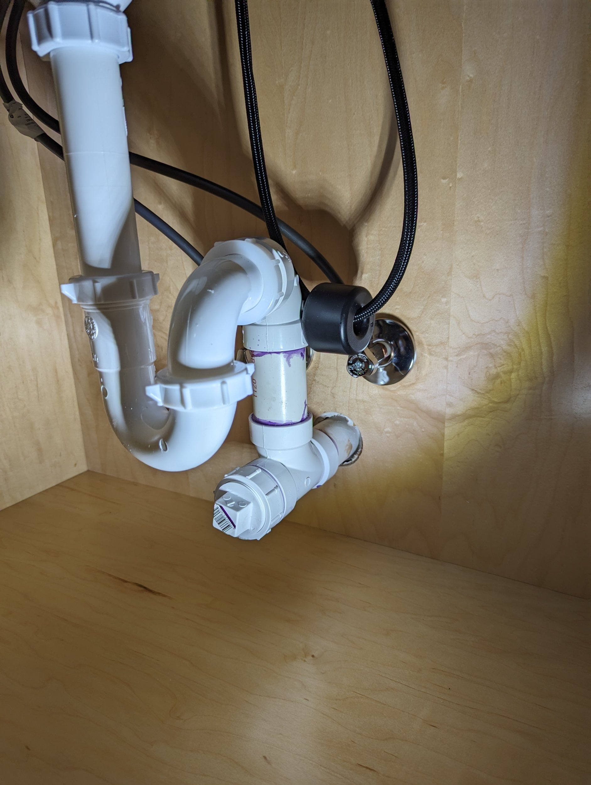

Can you remove the cabinet? I had a similar issue with a bathroom vanity. Every fix that I could come up with made me feel guilty doing that to my client. The only thing that I felt comfortable with was removing the cabinet, cutting out the sheetrock, and raising the drain pipe. Once I got past the metal issue of doing it, the actual work only took a couple hours.
   / New sink drain trouble
#25
Backsplashes already fully glued to the wall and cabinet, so no way I was going to pull it out. But I did get it done today. Added a cleanout for peace of mind. Here it is and the cabinet and countertop I made for it. Upper cabinets will be next.
