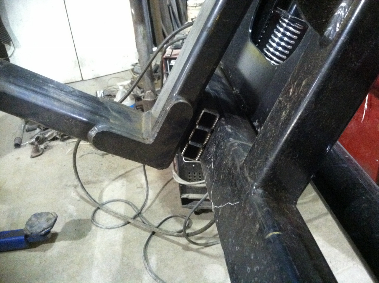

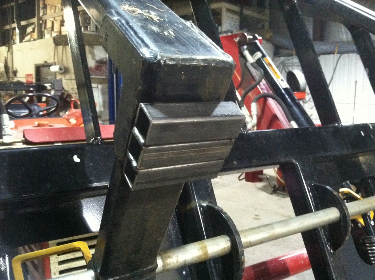

Finished the fork mods yesterday (California gave me this good idea :thumbsup:) and figured I better finish this thread also. Thanks for taking your time to follow along guys! :)
I took these pics with spacers just spot welded they worked ok and were welded in good once I did my trial fit and painted them also. I didn't take pics sorry but you get the drift. :D (turned out to be less of a wedge than I originally thought hence the sq tubing.)

   / New skid steer change over on Koyker 160 on its way #44
Looks good Car Doc.. I don't know how I missed this 4 months ago... Oh well better late than never I guess... Congratulations on a great build.

#45
Thanks James! I am using it quite a lot now even more than I figured I would. I can switch from pallet forks to bucket in just a couple minutes it really was a good investment I think.
