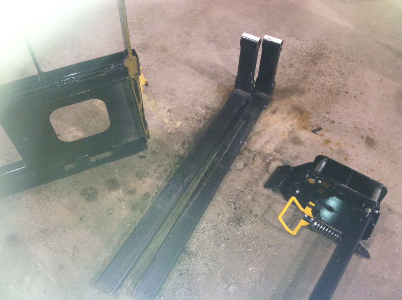

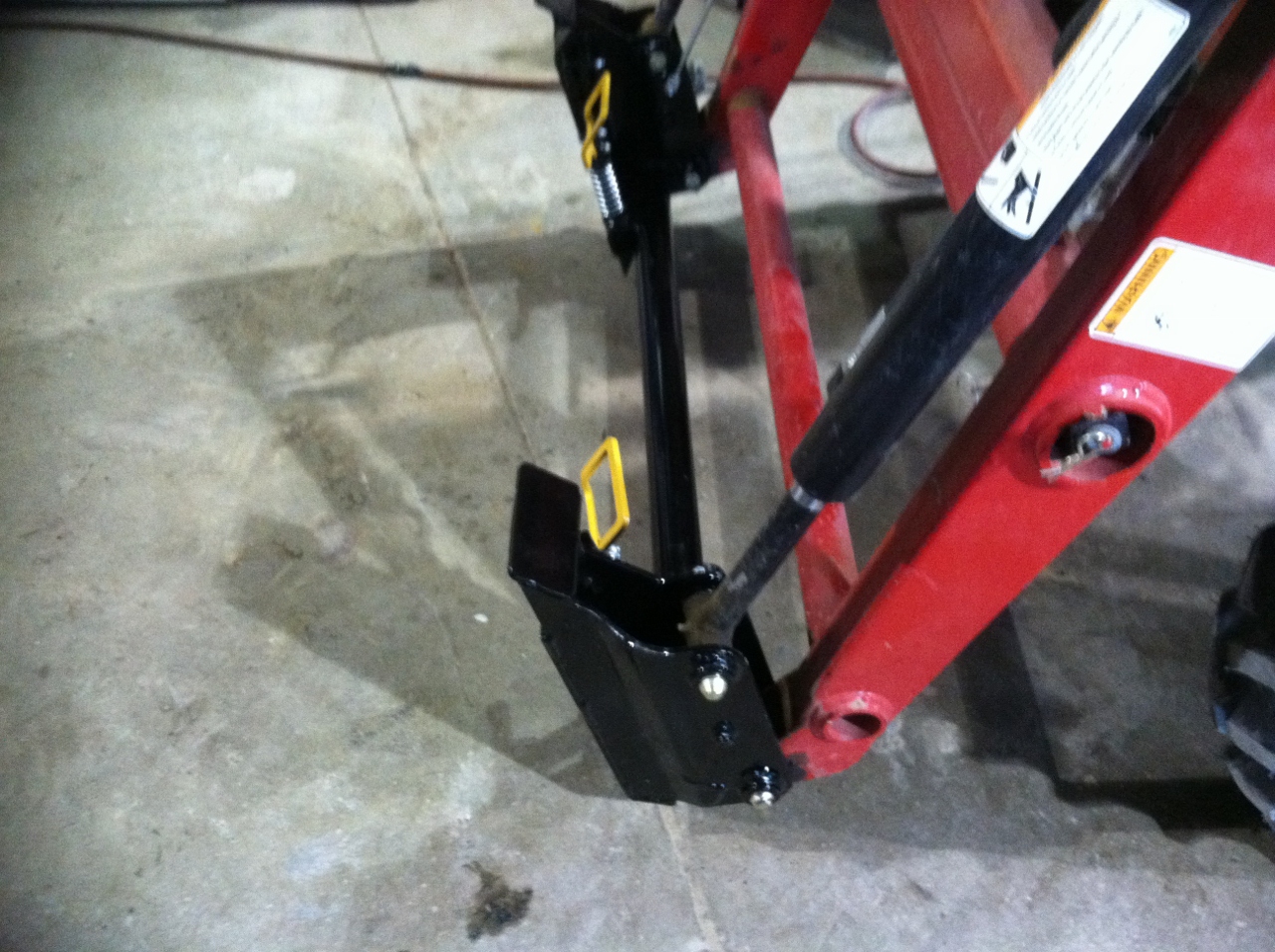

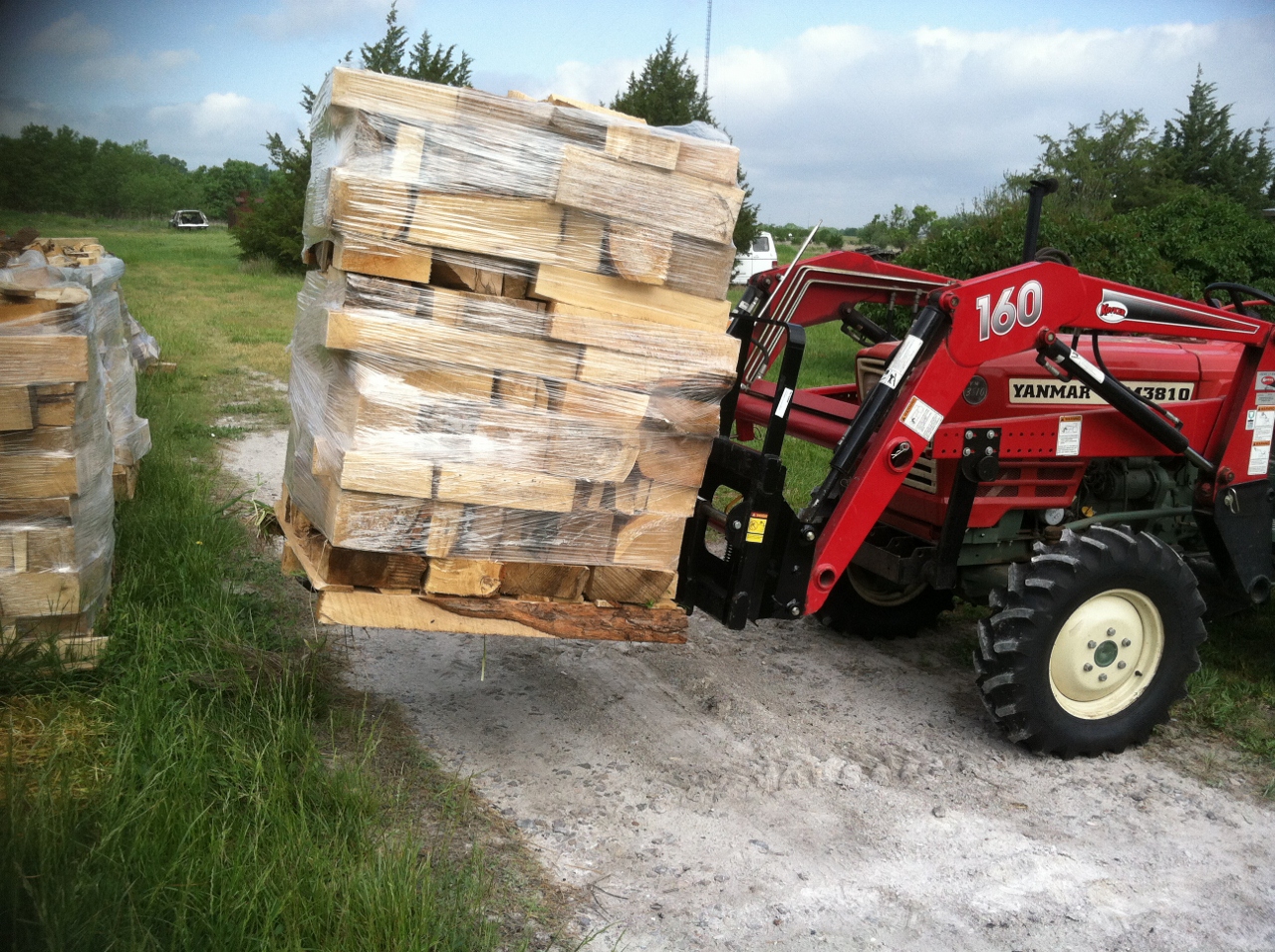

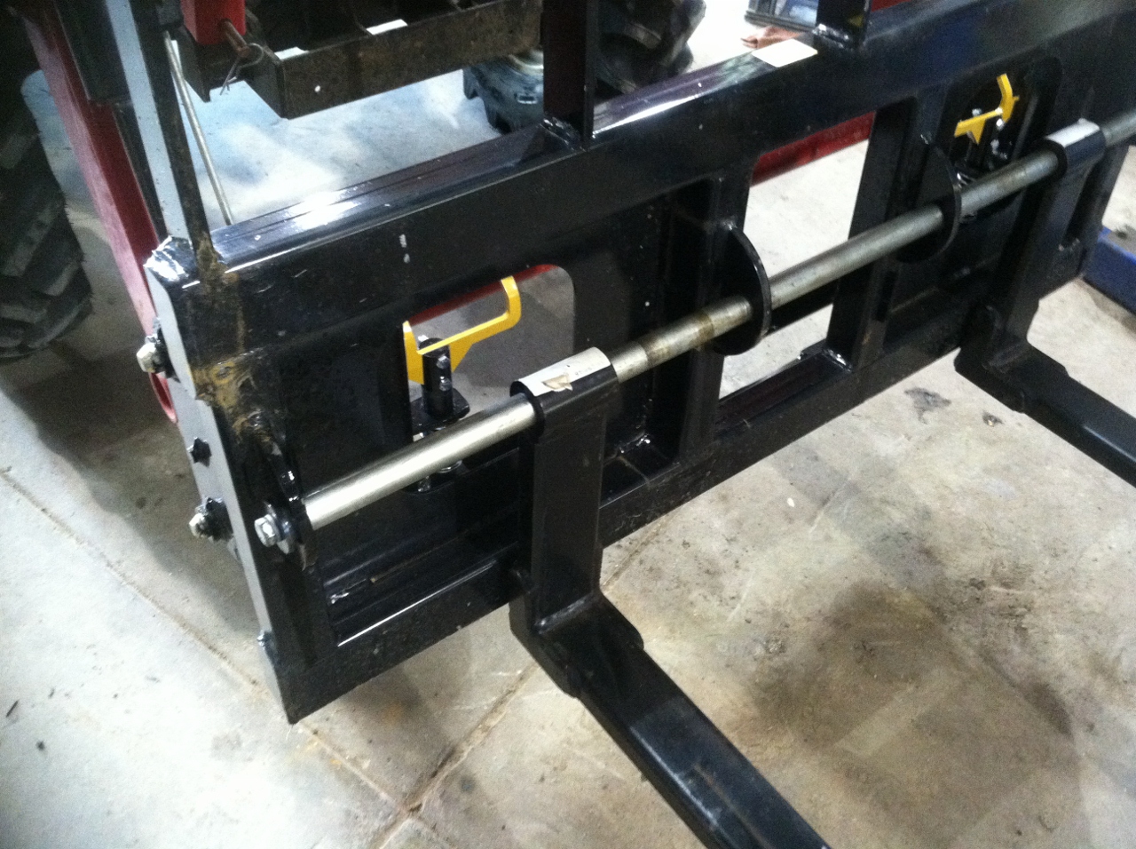

Well as promised here are some before and after pics of the QA skid steer attachment with pallet forks. :D
Of course the first job was to see if I could lift and move those big pallets of firewood. :thumbsup: (and thats about all the weight this tractor wants to lift safely)
Cutting the mount off my bucket is next and them welding the skid steer plate on it. I have concerns about whether I will lose some of my rearward curl if the plate is mounted flat to the backside of the bucket.
Reason I say that is the forks have no rear curl as is and I dont know what to think about that...designed in or what. It lifts at a slight negative forwards angle and about 1 foot off the ground levels out so thats why I am reserving my thoughts on it for now.
And will do the head scratching on the bucket later today or tomorrow I need to cut the bracket off first, I definitely want to keep my full arc.

... the forks have no rear curl... It lifts at a slight negative forwards angle...
Could you weld a 'heel' to the back of each fork, down where it rests against the QA plate? That would raise the tips of the forks.

Now thats good thinking California a great idea I just may use it thanks! :thumbsup:
