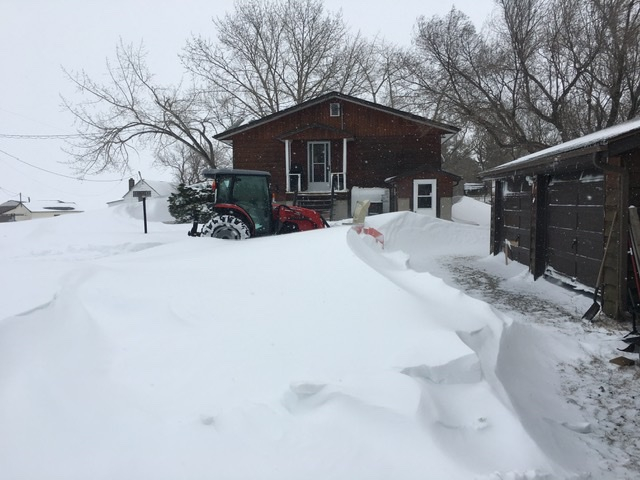

#13
Still snowing and blowing. Three ft drifts around buildings, couple ft in the driveway. With the wind direction change I'm sure my drive to the highway is blocked. I'll get to it after breakfast. Lots of highways closed.
/ New snow
#15
Wind was on my side with the road to the highway, just a few finger drifts. Beside the house was a different story. Had to put the blower back on.

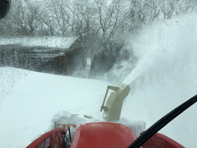

#20
Finally quite snowing and blowing. Worked the blower pretty hard, blew out the bearings where the shaft goes through the ssqa plate. Wondered about the bearings being too close, back to back at the short shaft with the drive sprocket. A bit more sittn' n thinkin' is in order. Couple of options come to mind. A support in front of the sprocket seems like the best way to balance the stress.
