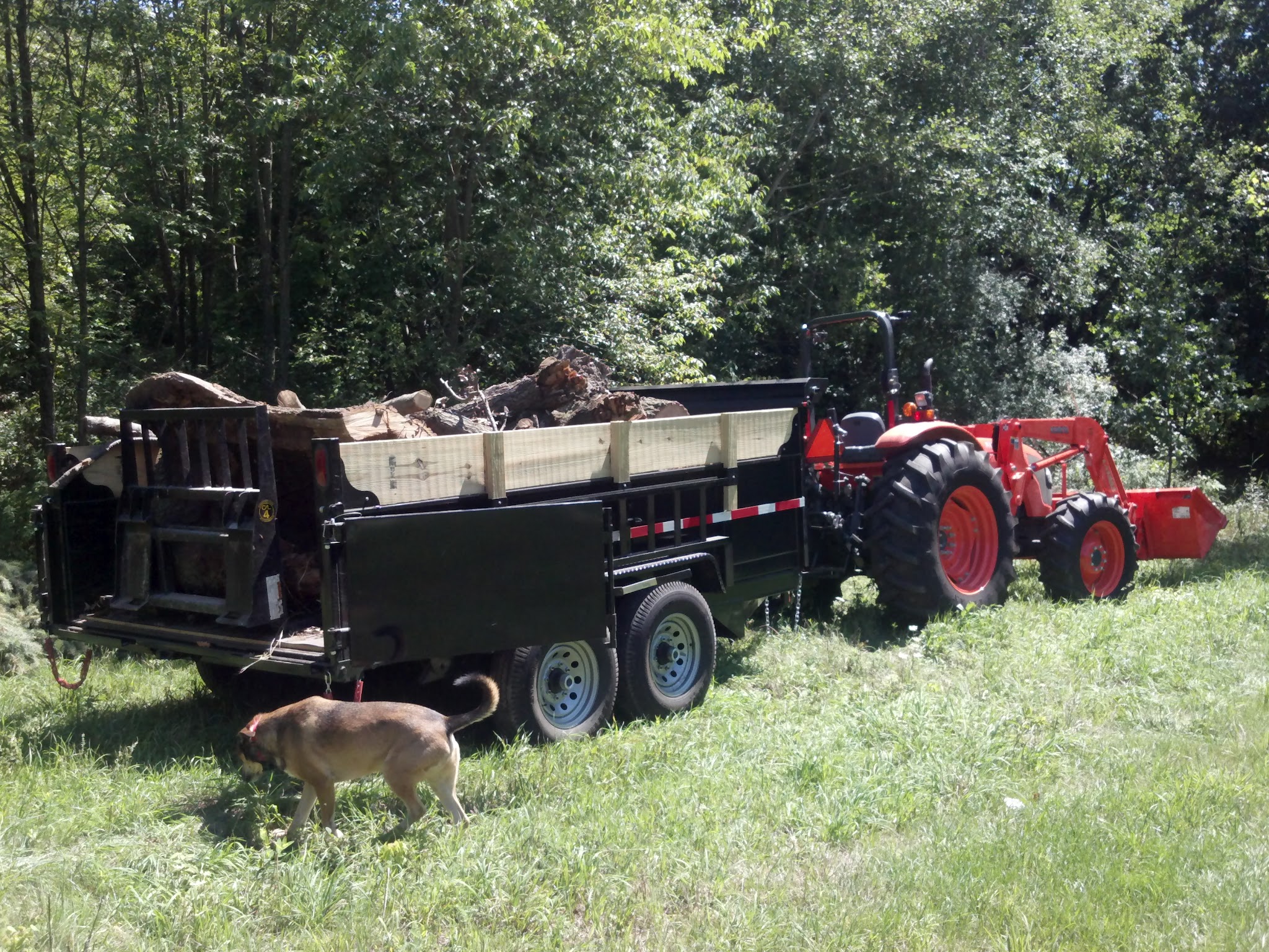

How i Haul wood The trailer will easily hold 4 face cords split and loosely thrown or dumped in. My Carry-all and loader will hold just shy of two face cords

Xring you have very nice equipment. I'm envious of that dump trailer and I really admire your carry all. Is it homemade? I need one for my mx in a bad way. It seems like it would be handy when it its to nasty to get the trucks to the wood pile.

That is a really nice dump trailer you have there!

Dbaer / Matt. Thanks I generally like to buy nice stuff. I went without a tractor for about 7 years because i would not have been happy with the performance of a smaller tractor it did help though that i had access to a 24hp tractor and 40 pto hp tractor. The Dump trailer is sadly not mine, its my next store neighbors we generally gather and process firewood together but i have access to the trailer when i need it.
