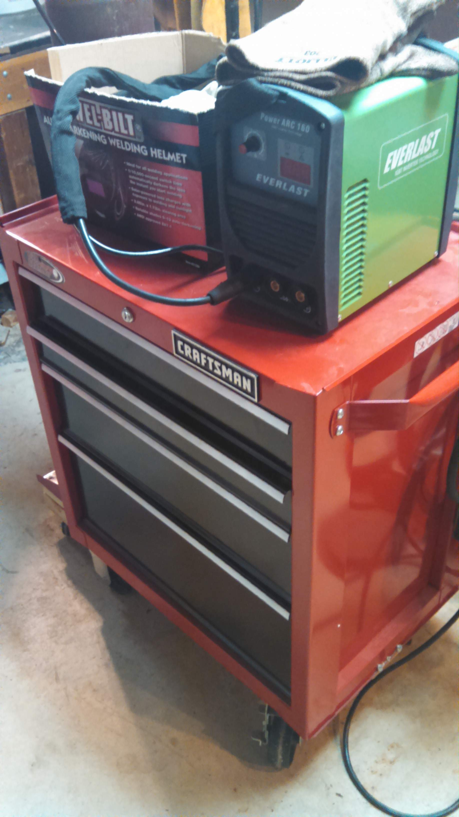

Here is my little Everlast PA160. Welds smooth as butter with 125 amps 1/8 7018. Tiny little thing, pick it up and walk off with it. Also fits in the bottom drawer of that cabinet.

What’s the duty cycle on that?

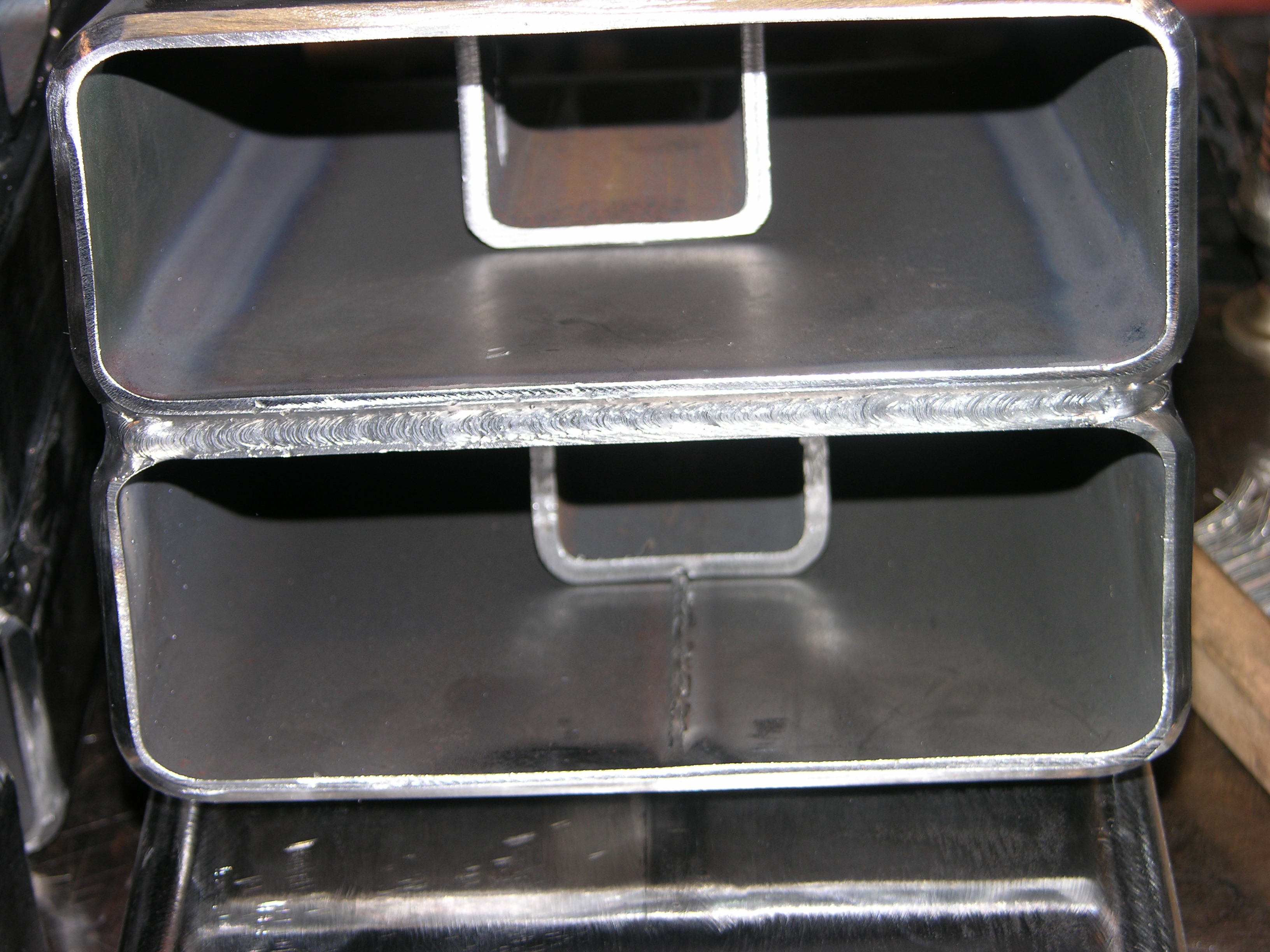

Yes, but Shield Arc could make great welds with any decent welding machine.
:laughing::laughing: Yes he can
but SA's comments like this speak well of the PA inverters
(PowerArc 200ST is a very impressive welder! Mine will stack 6010 like my Lincoln SA-200s. It is also a dream to run 7018 with it too.)

60 percent. Unfortunately you cannot buy one any longer.
Whether it was really 60% is anyone's guess. The most I have pushed it was burning 5 7018 rods as fast as they would go at 125 amps. It never broke a sweat, and no duty cycle light came on. So I have never had to wait on the welder. It's replacement is only rated 35%, but it has provision for TIG solenoid and even a pedal and has HF start for TIG. My tigging is just scratch start with a manual 17V torch. It works well though.
