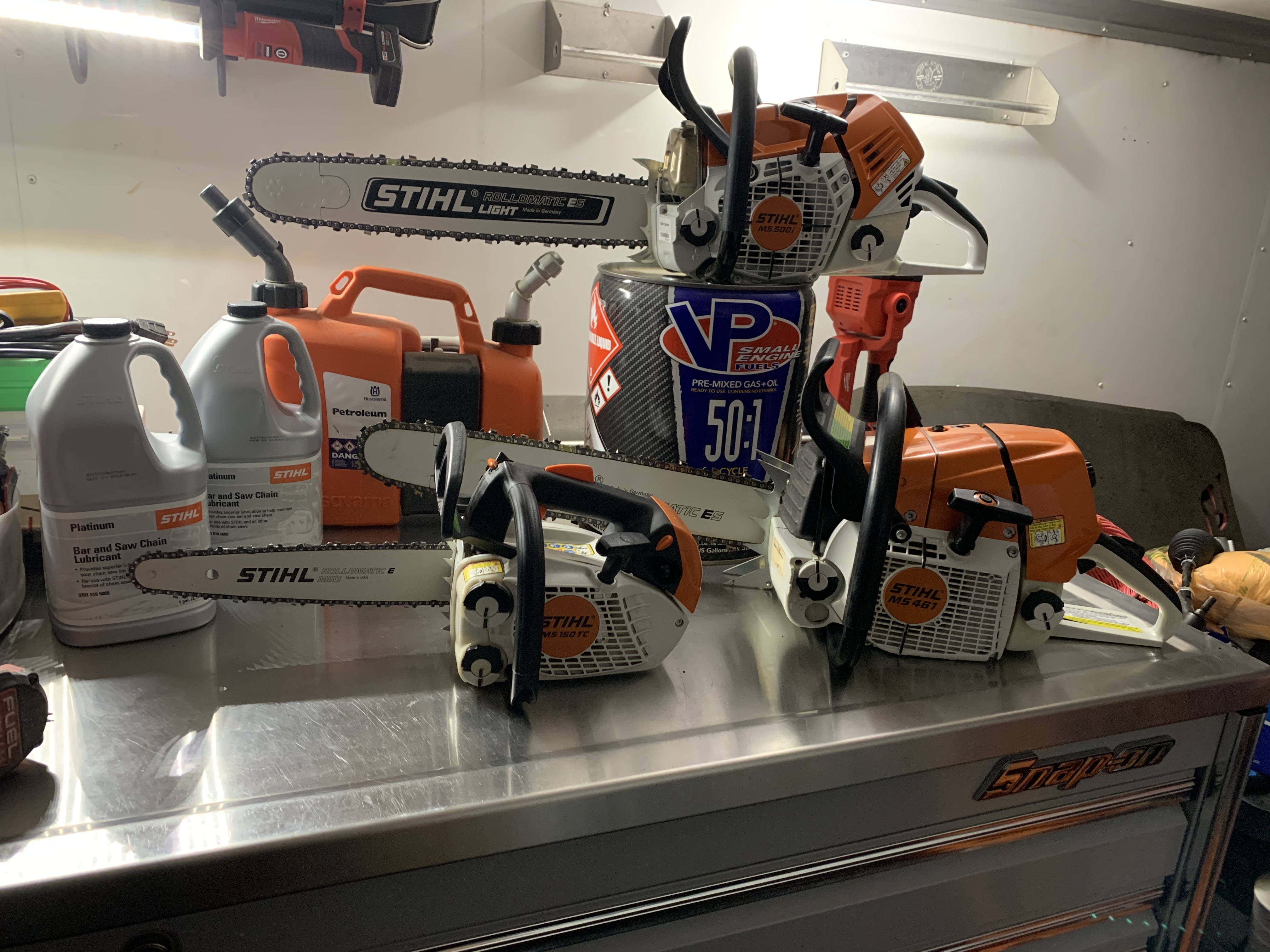

The 500i has quickly become my favorite saw. Setup with light bars, it’s light and powerful, definitely a pleasure to run. IMG_1918.JPGMy 461 will be seeing a lot of shelf time. I’ll never part with it, it’s tried and true and never let me down.
I have a few goodies for the 461 to install. A larger jet, magnum muffler and unlimited coil, so it’ll get some attention this winter.
