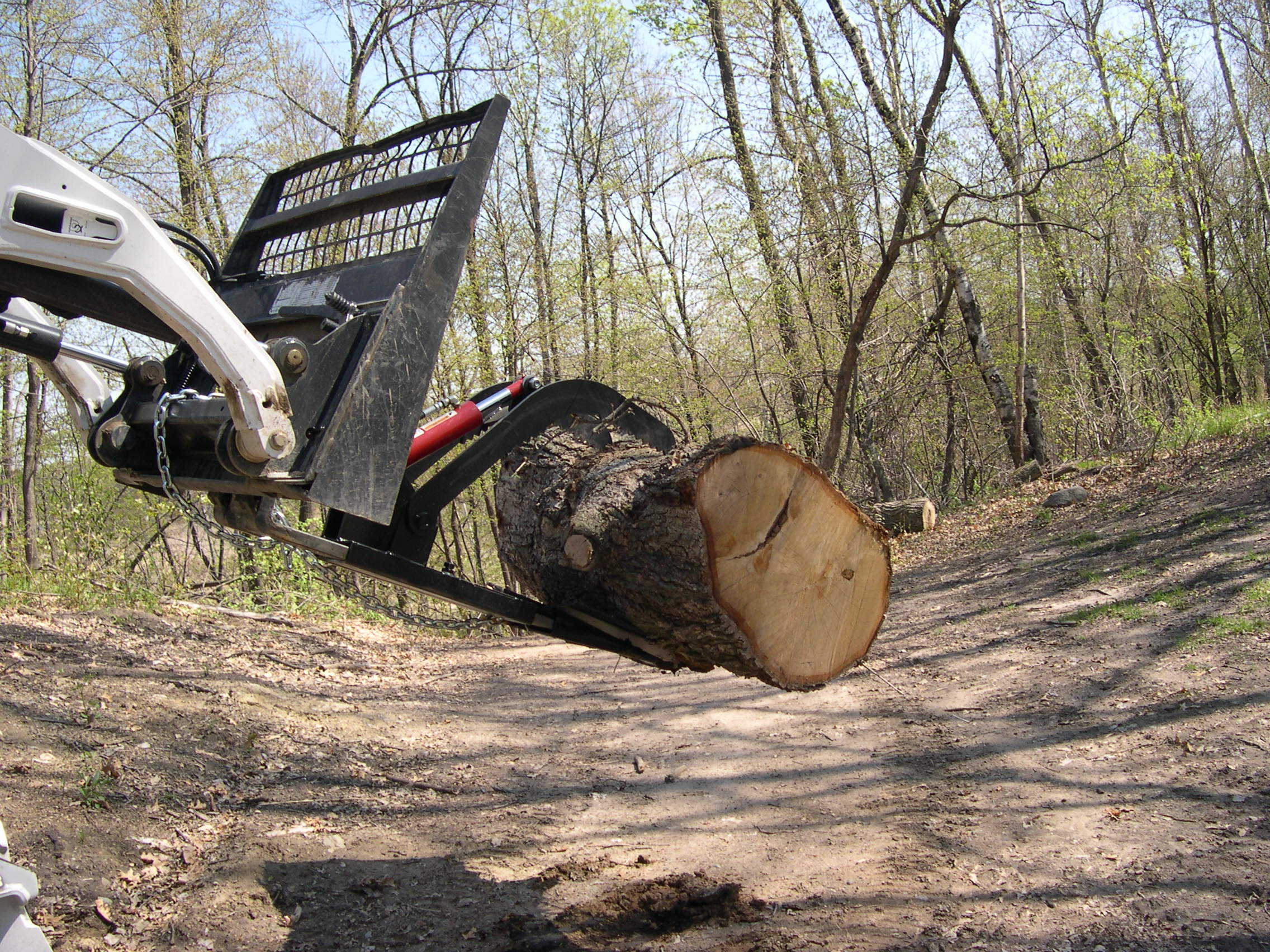

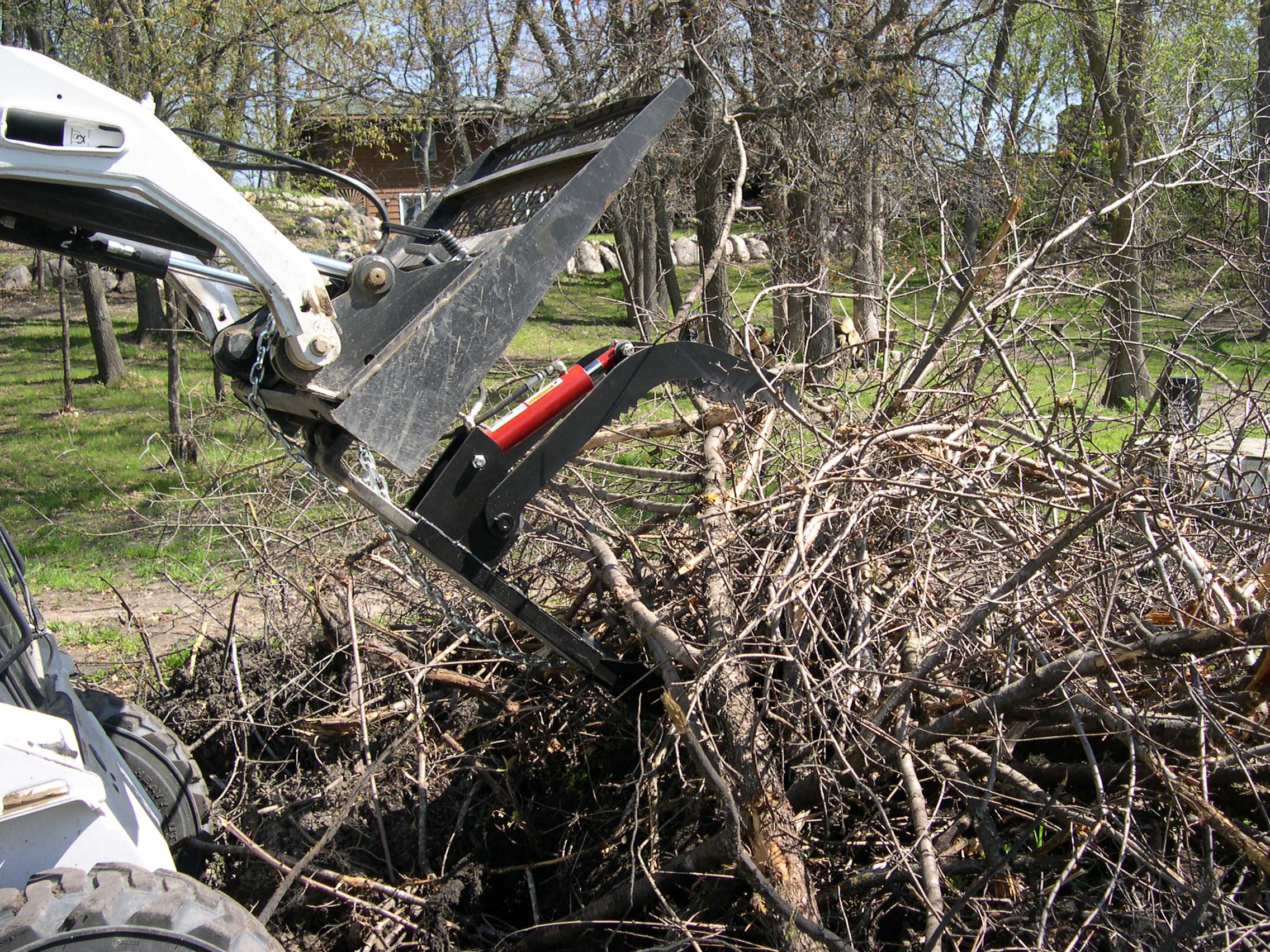

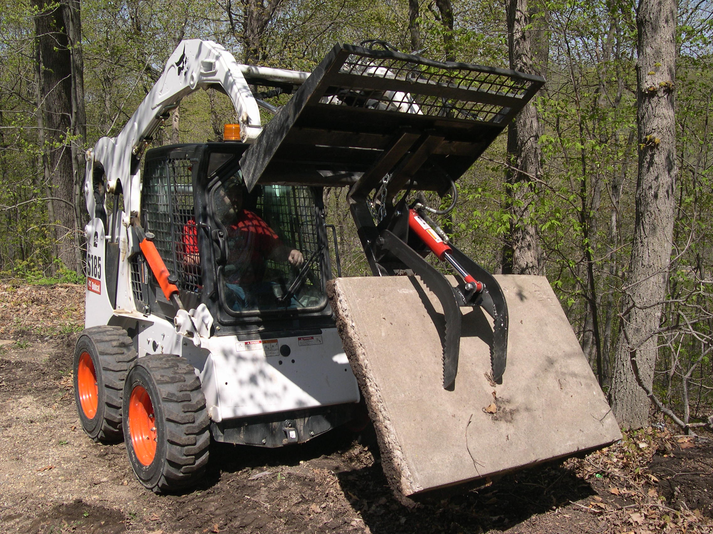

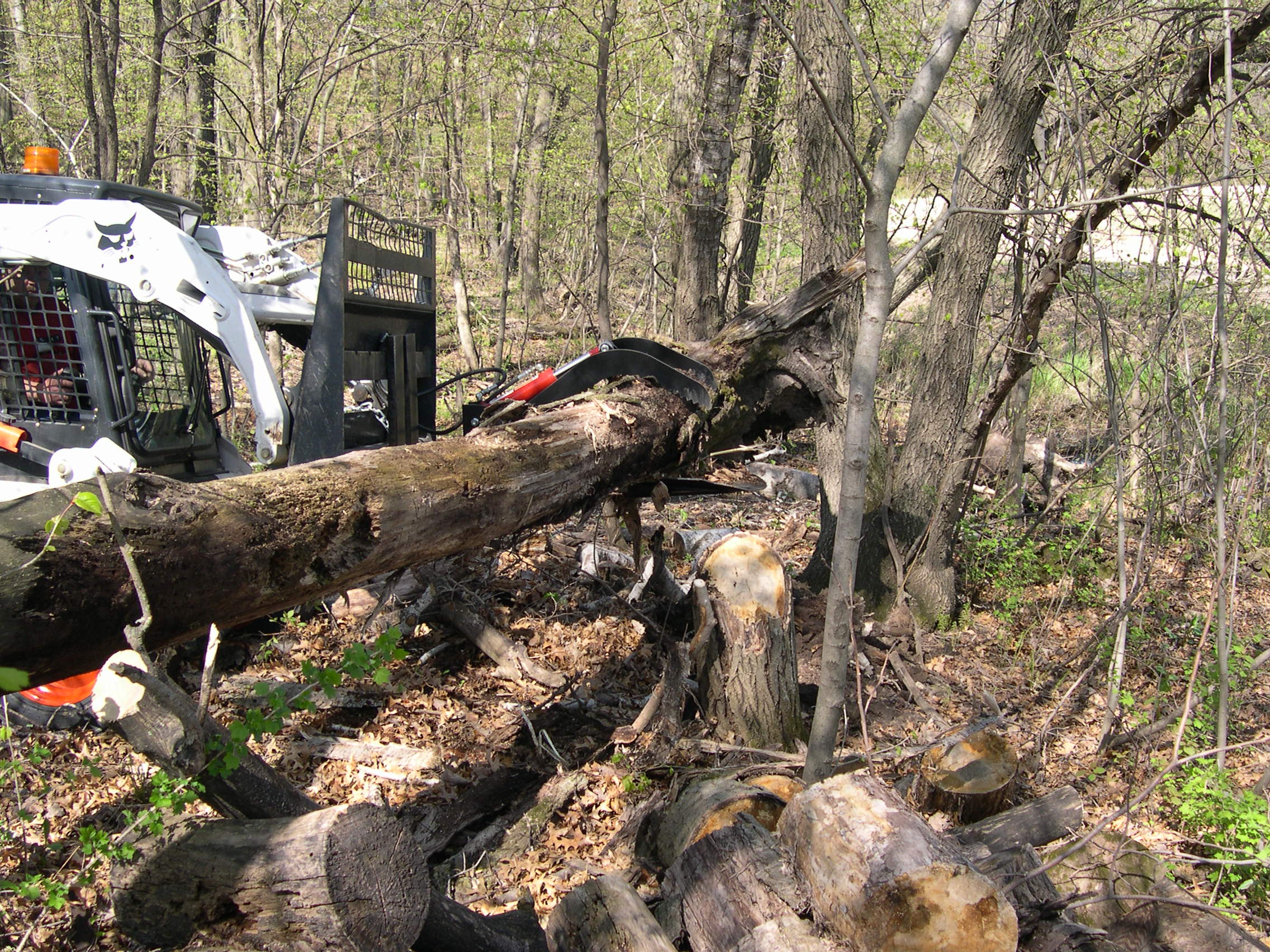

Hello to everyone.
I would like to see what you think about the new style Grapple we are carring. This product hit the market with a bang. Sales are out standing but want to see what you think. Please feel free to ask questions.
7,000 pounds of pushing power. Built from 1'' high strenth steel. Also has extra supports welded on to the jaw's to allow you to rip out brush, tar and so on.
I have a lot of good reviews from people that already brought it and say they love it. I asking what your thoughts are on it. I'm sure there will be people that just say everything is junk. Just take a good look at it and you will see how well built it is.
Paumco Products, Inc. Click on Paumco Fork Grapple.
watch the video on you tube. Type in Bucket-less grapple
Thanks for giving me your feed back!!!!

My first concern with such a small grip area would be the torsional forces on the loader arms. If you are going to pick up something that is as wide as the fork frame, no proplem, but larger, you could end up with a lot of stress.
In my humble opinion, I would rather use a 48" + grapple that would spread the stesses further towards the arms.
/ New style grapple. #3
I would think that one grapple on each fork and the forks spread out would be the norm.
/ New style grapple. #5
I can't see how this is any improvement on a grappler mounted to a FEL. I do see how it isn't a versatile as a grapple/FEL combination.
