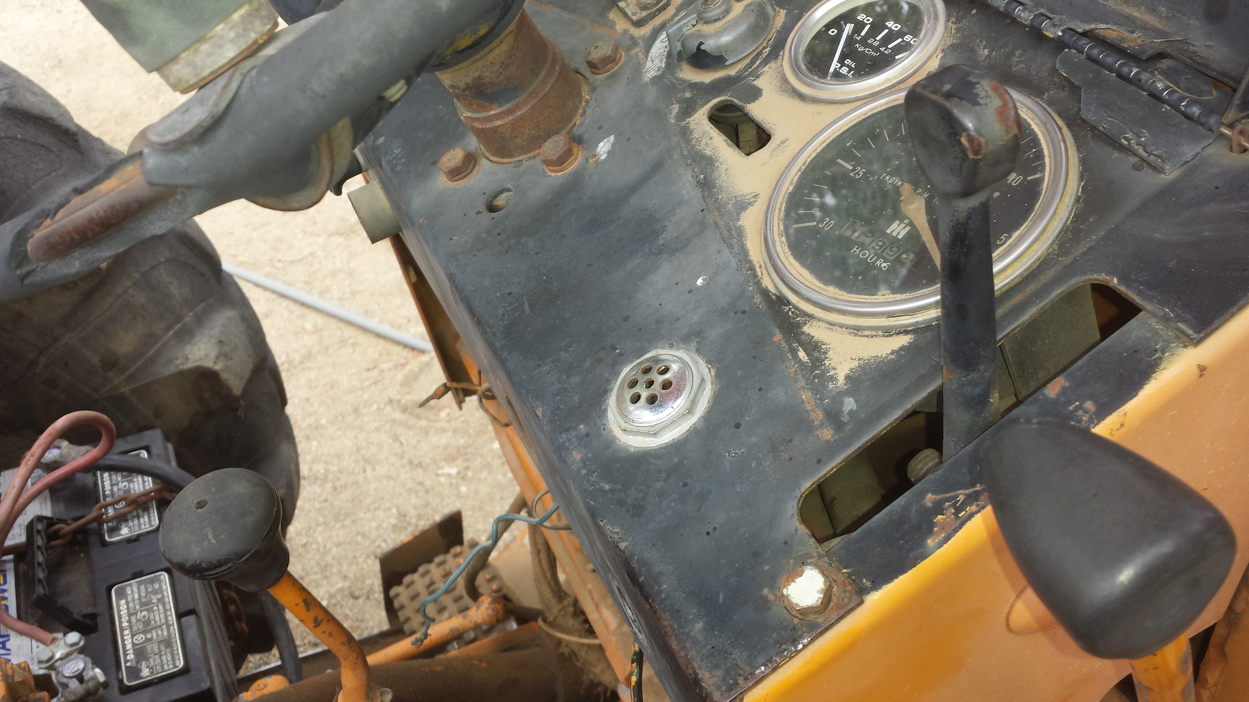

Thank you for the reply and I have found it useful. I know there are glow plugs cause I can see them in the side of the engine but just haven't been able to test them. Problem = glow plugs on left side and glow plug button on right side about 6 feet apart. Wife HATES the tractor so it's going to be hard to get her help. I did find one encouraging thing thou, the charging system does work which I was sure was bad. :cool2: The top link for the ganon (see, I am learning the terminology) which is a hyd. cylinder is leaking like a sieve and besides the glow plug problem is all that is keeping me from using my new (to me) tractor. I've got a couple of berms to build up between my house and the wash running thru my property and also my neighbor who is a widow and can't do things like that.
   / New to forum and new to large tractors
#26
What in the blue blazes is a resistor assy indicator and why is it in the glow plug circuit? Is it suppose to let me know the glow plug circuit is operating at the time?
   / New to forum and new to large tractors #27
G'day mate the resistor indicator they are talking about is the chrome nut with the holes in it, it is basically a heavy wire coil in there that glows as you warm up the plugs when it is orange then the glow plugs should be hot. Some of these system the indicator is in line with the glow plugs and if it is burnt out then the glow plugs won't work.
Jon
#28
Jon
So I can bypass it right?
#29
Well, I checked it out and the resistor has continuity so it something between it and the plugs or it could be the plugs.
#30
It has power to the plugs so figure the glow plugs are bad. How hard is it to replace the brake discs on the beast? It doesn't stop worth a cr*p! My owners manual will be here tomorrow but doubt it says anything about repairs. I have the parts manual engine manual, and hydr manual but no service manual. Found a digital down loadable service manual on Ebay for $30. Anybody bought one that way and is it a good option?
