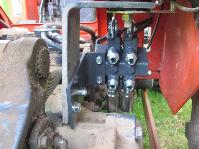

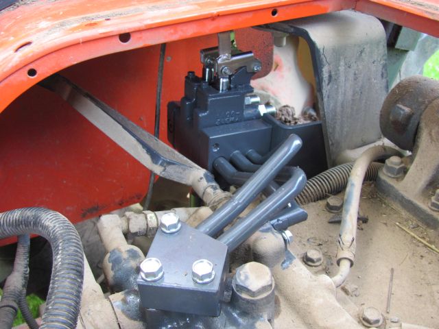

Here's the valves installed under the seat.

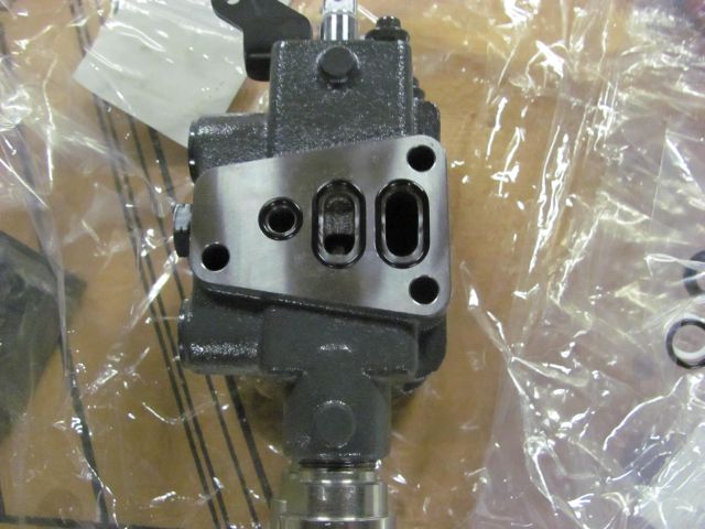

One of the valves with the o rings installed in the slot.

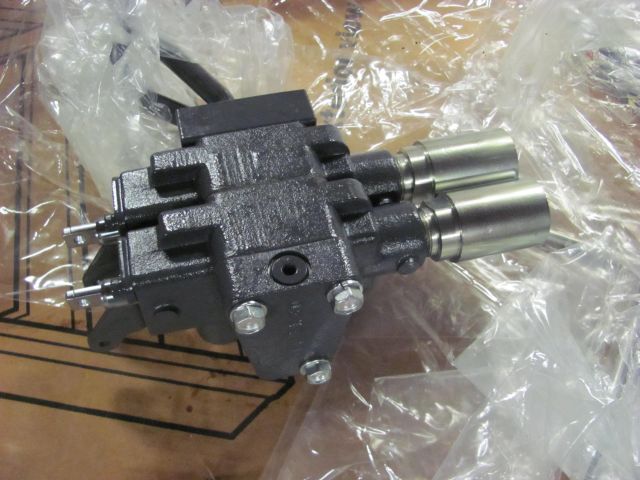

The valves all bolted together.

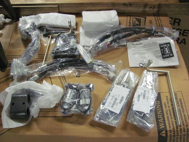

The parts as they came.
Back view before hoses attached.
