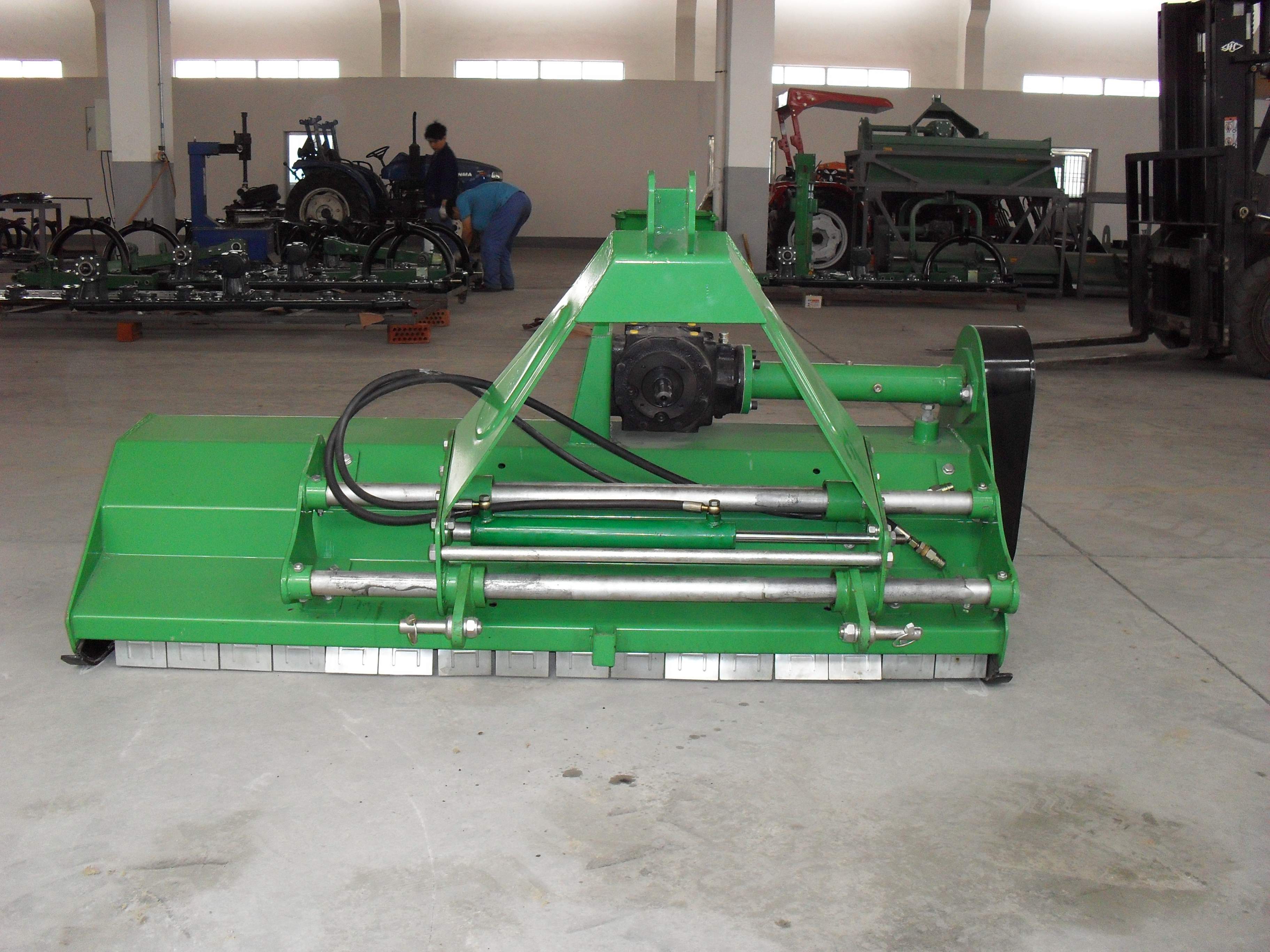

flail mower can make flying debris to damage vehicles????? really? the protect sheet on flail mower cannot prevent the flying debris? SDC10158.jpg
Most of the flail mowers in the U.S. are used to mow orchards and vineyards where the operator wants to cut the weeds down to ground level (scalp mowing). They are considered too slow for field mowing where the operator want a taller cut (several inches high). Brush hogs (aka bush hog, shredder, slasher) are preferred and are much less expensive than flails. You rarely see flail mowers used for highway right of way mowing--these are almost exclusively brush hogs.
The State of North Carolina has gone almost exclusively to flail mowers and have greatly cut down the amount of damage to vehicles from flying debris.
