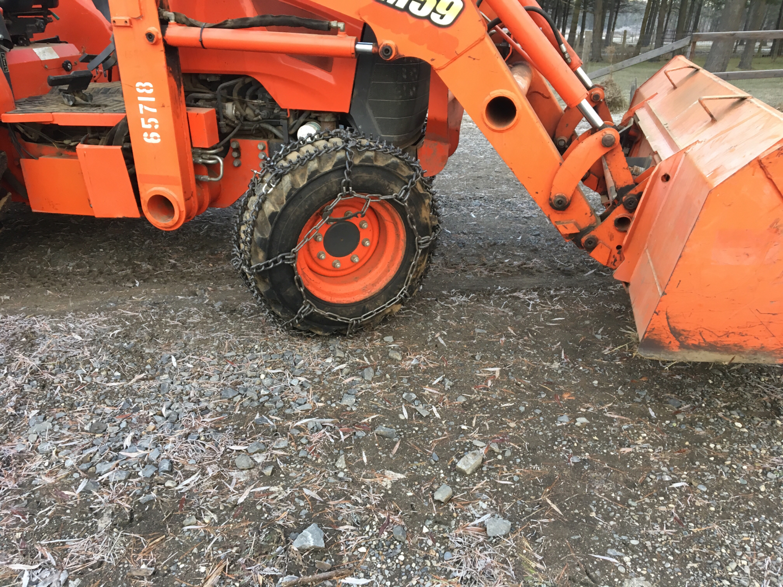

These chains are for the front tires of this machine. Hopefully they won’t be too hard to put on. Loader/bucket to help out.
   / New to me Kubota M59 #95
Front should be easy to put on. The rears are a B#@tch! Yup use the loader bucket to lift the front up Good luck

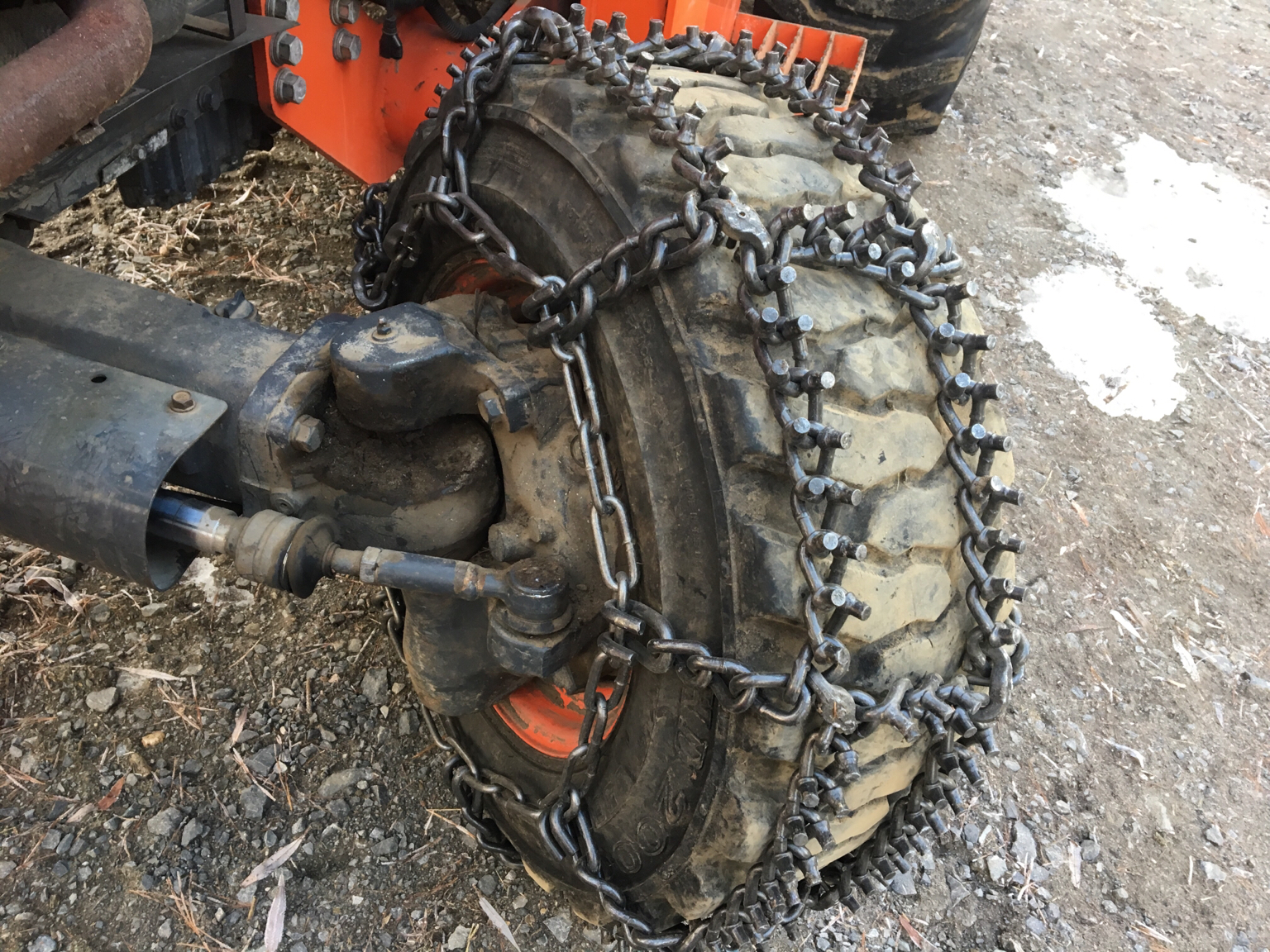

Finally got a chance to install those chains this morning. My neighbor gave a hand and then I had to get cleaned up and off to work. I will hopefully have time to try them out tomorrow morning and do any adjustments that need to be done. I’ll have to tie up the excess with wire or use the couplers that came with them. Looked like things will be close on inside of tire. Will have to see about that. Don’t want them rubbing/hitting anything. I’ll post up some pictures when I get them done. Can’t wait until my next day off to go out on the M59 and do some more work in the woods!

Well my good neighbor/friend helped me by finishing up the tightening of the chains. I’ve been busy working so we did a little here and there for an hour in the morning. It turned out with the fasteners (tension adjusters) left on they and chain were going to hit on the mechanical parts of front drive and steering. So we came up with the solution to take the fasteners (tension adjusters) right off on the inside. Then pull the chains as tight as we could get them and put them together with the four couplings that came with the chains. Then he used a side grinder to cut off all excess chain. Appears that it should work very well. All I’ve had time to do is take it for a test drive and see that nothing is going to hit. We will see how tight they stay when I put it to work this week. I have a vacation and wife and kids are in school. So I’ll be out on the woods cutting firewood while opening up a new trail. Can’t wait!IMG_4619.JPG

Hey gasifer, a big heads up - those chains are going to walk side to side. Get a spider on the outside. Something with HD springs not bungees. You should consider shortening the inside chains to keep them further away from the steering and axel components...they look awfully close to stuff you dont want to hook onto while driving.

I agree. That set of chains is getting there, but go slow until you see how the chains walk when turning under torque. It always took me several tries before I got the chains to fit right. Eventually as you modify the chains for best fit, you may find you get the best fit to the tire profile by using "X" bars across the tire tread instead of cross bars to link inside to outside chains. The "X" cross bars use an "O" in the center to connect the four legs.
Like Mikester says, if you are going to have all that extra chain on the inside then you will want to have very sturdy spider connections right across the outside face so that the chain cannot move to the inside. I've used the heavy rubber bands with hooks to tension the chain on the outside face of the tire. That works surprisingly well, but I never could make myself believe that it would last.....it did pretty good though. I've never tried his spring idea - they might be better.
What I did with my best pair was use the rubber band & hooks to show me the right shape - and then I used them - and then replaced the rubber parts with solid chains all connecting to an "O" in the center of the outer wheel face.
Getting chains right takes a while - but it's worth doing.
