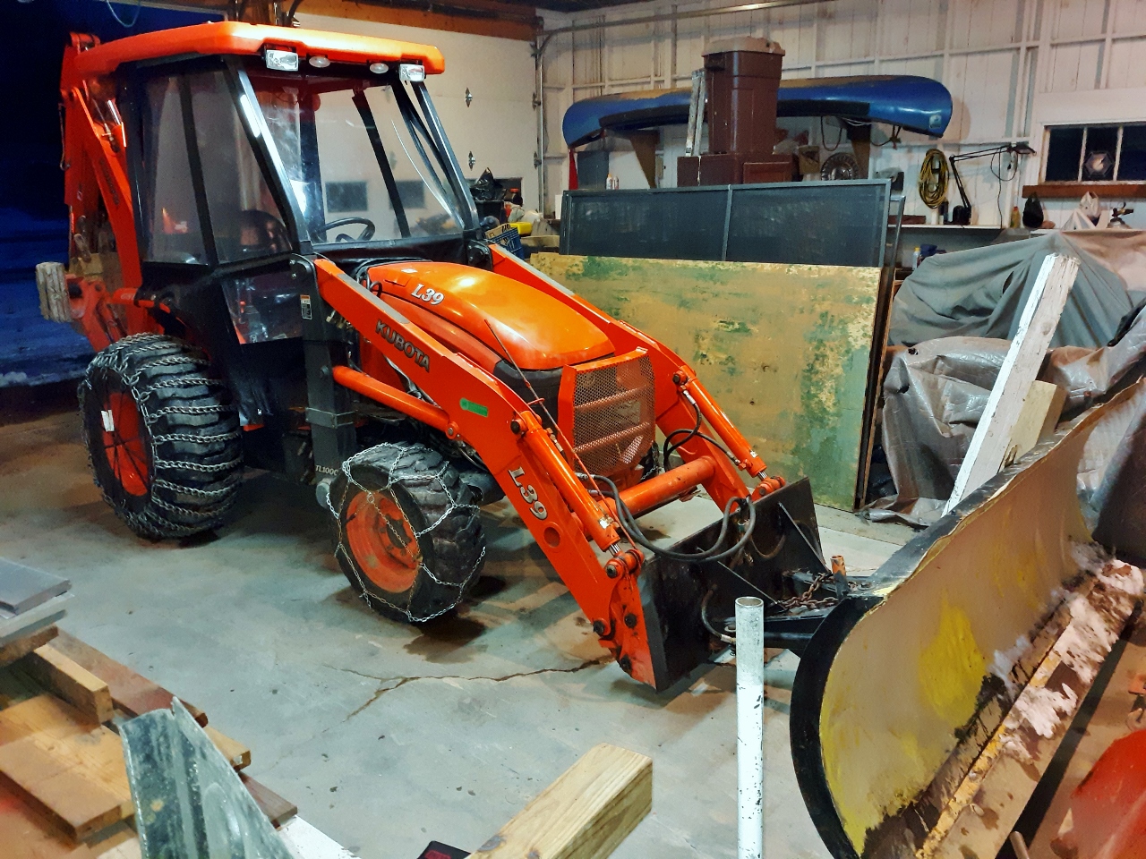

That number sounds familiar. I think $500 is about what we paid to build the front chains for our M59. They still hang on the fence under the eve of the barn. Those chains seem to have taken up residence there and are getting old and weathered. I remember when they were all bright and shiny and new....
I think I tried them on once to see if they fit, and still haven't ever used them for wintertime work. It wouldn't surprise me if getting them right was a similar job to what you are going through. So far we've been lucky that the M59 hasn't needed winter chains. I'm guessing that is partly due to the climate change, and partly that the M59 is more capable than I thought it would be when working in a foot or so of snow and ice.
Our previous 3 tractors all ran chains, two of them front and back both. From what I remember, they were always stretching and wearing. Keeping them tight was a constant process.

Can you exchange them for a set with smaller section chains, those were monsters?
These are light duty, I go thru 2-3 a winter.
https://www.amazon.com/gp/product/B013HDRW98/ref=oh_aui_detailpage_o09_s01?ie=UTF8&psc=1
These are better, but only when on sale.
https://www.amazon.com/gp/product/B0091RCIR6/ref=oh_aui_detailpage_o08_s00?ie=UTF8&psc=1
You will need chains for a 29" tire. Above are are for a 27" Tire

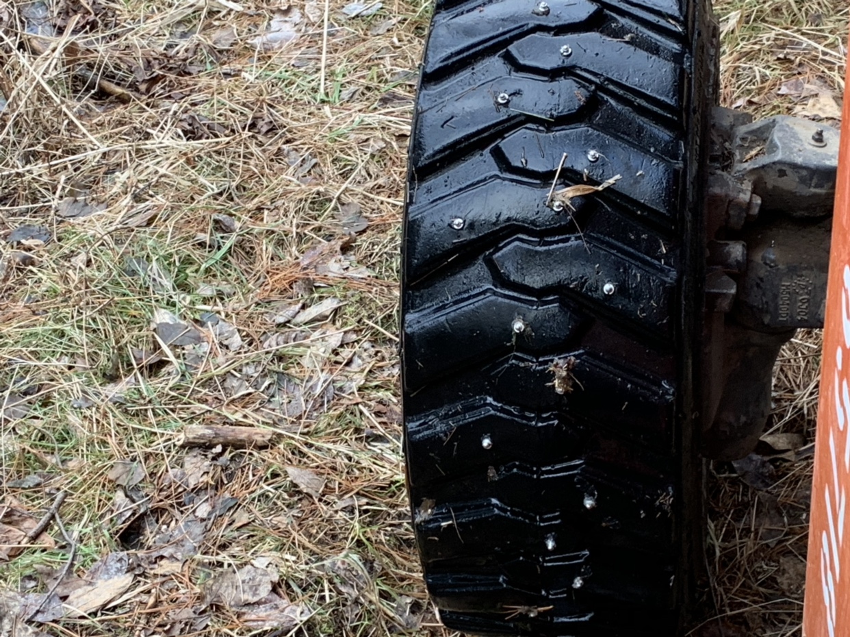

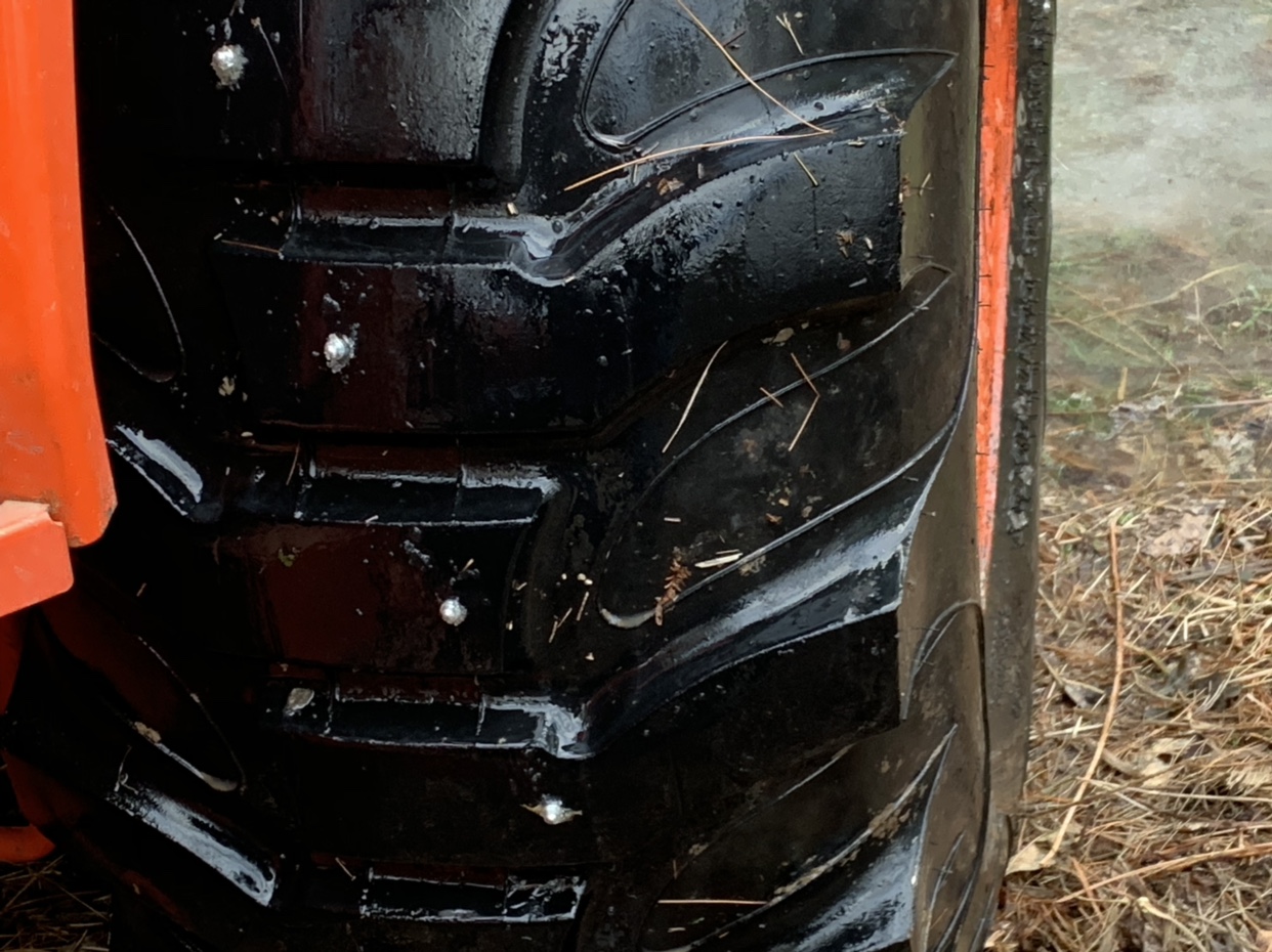

Nice. Just do not confuse them for grease zerks next summer :laughing:
I installed studs on fronts of my little Mahindra. Should have gotten chains. Minimal improvement. Need for steering, not traction as I have chains on rear.
