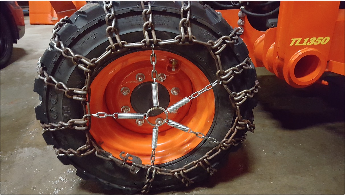

I have seen them 努alking a bit already. I will get some chains and/or springs on the outside. They look closer on the inside of tire in the picture than they actually are. I値l be keeping a close eye on them and improving clearance whenever I can. That痴 a nice thing about front loader and bucket. Pick the front up and can adjust easy if needed.
Here's a photo of a low cost home made spring spider using HD springs from the hardware store.

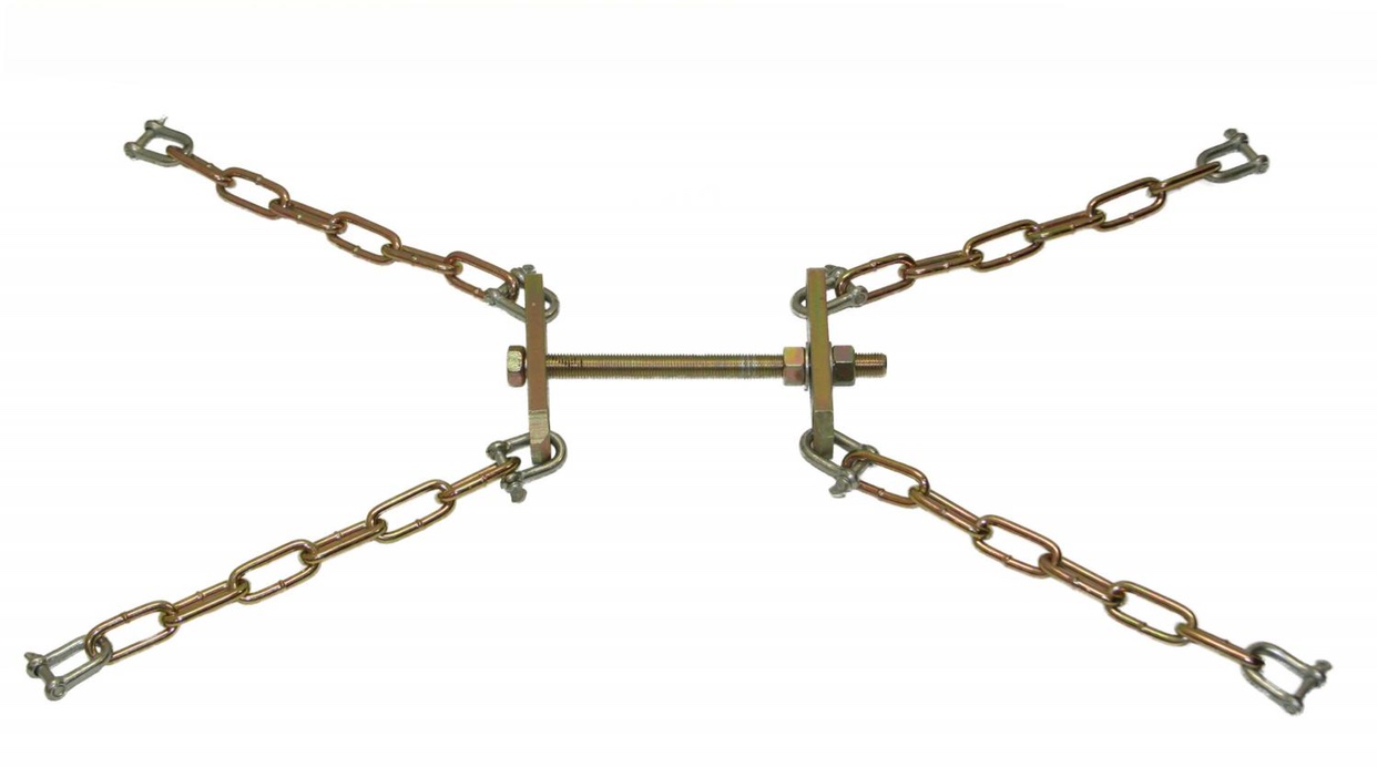

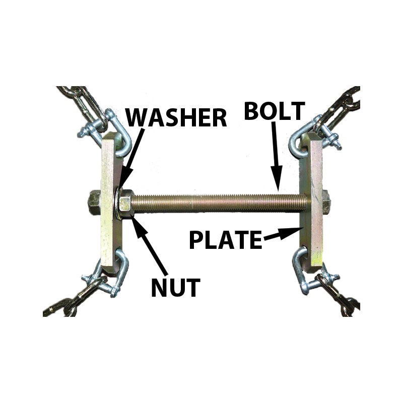

So my neighbor was pretty busy trying to get another project done he had already started for another guy. So I told him no problem and I would take the M59 back and see what I could do with it. I then went and did a google search on heavy duty chain tensioner and clicked on images. I found this product a company sells and decided to put my own together. My neighbor said he would make the plates up for me and we came up with adding the center plate for two more tension points.

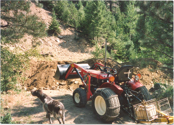

I'm not doing anything this morning - just waiting for the block heater to get things up to temp to help a neighbor later today, so I'll try to post a picture & see what's changed.
Let's see... the segquence I've always used is:
go advanced/manage attachments/add files/choose files/upload/done. Hmm.....that seems to work for me. No difference from before.

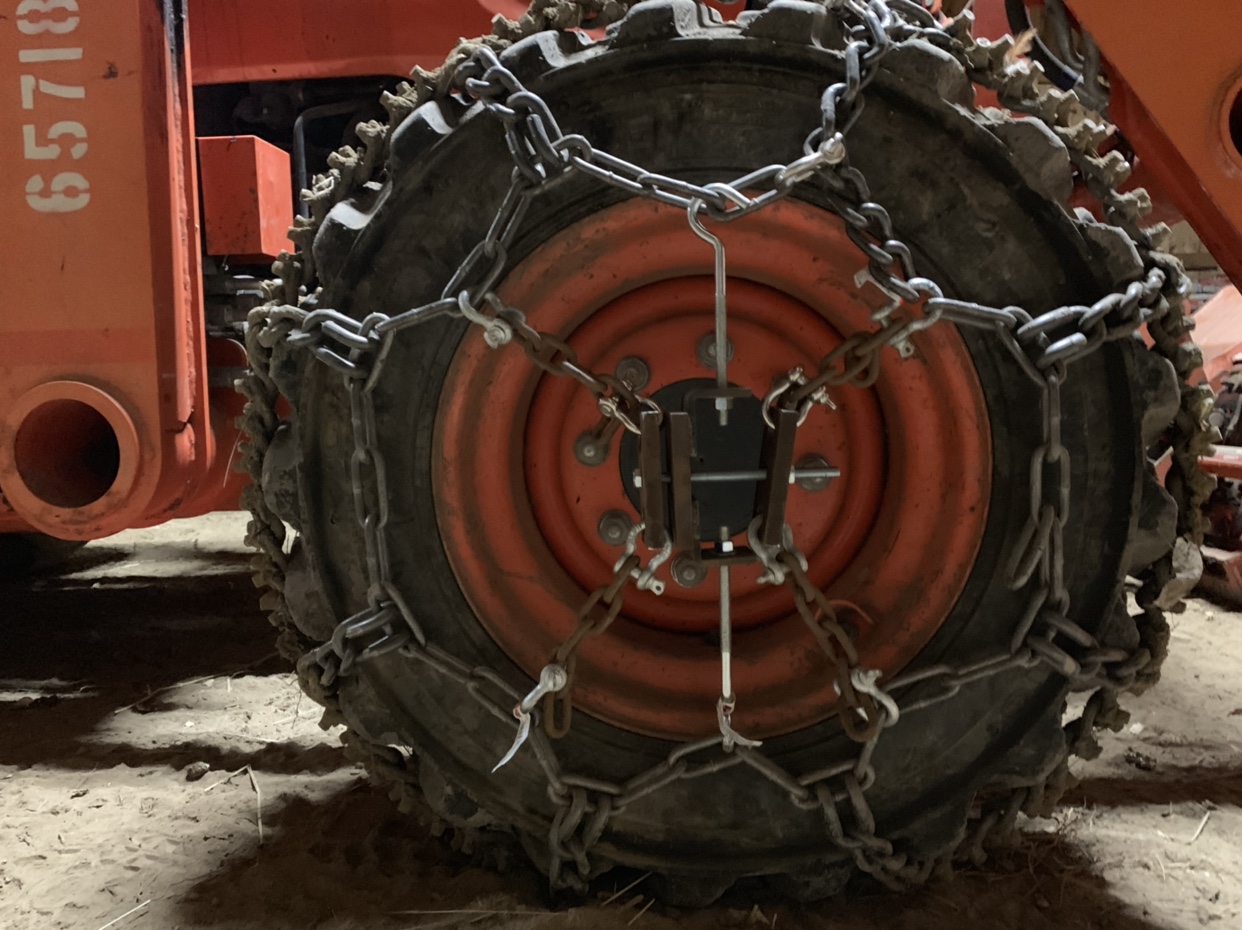

So here is what I found.....
And here is what I put together with my neighbor making the plates and cutting me some short lengths of chain. Things have improved since these pictures.
