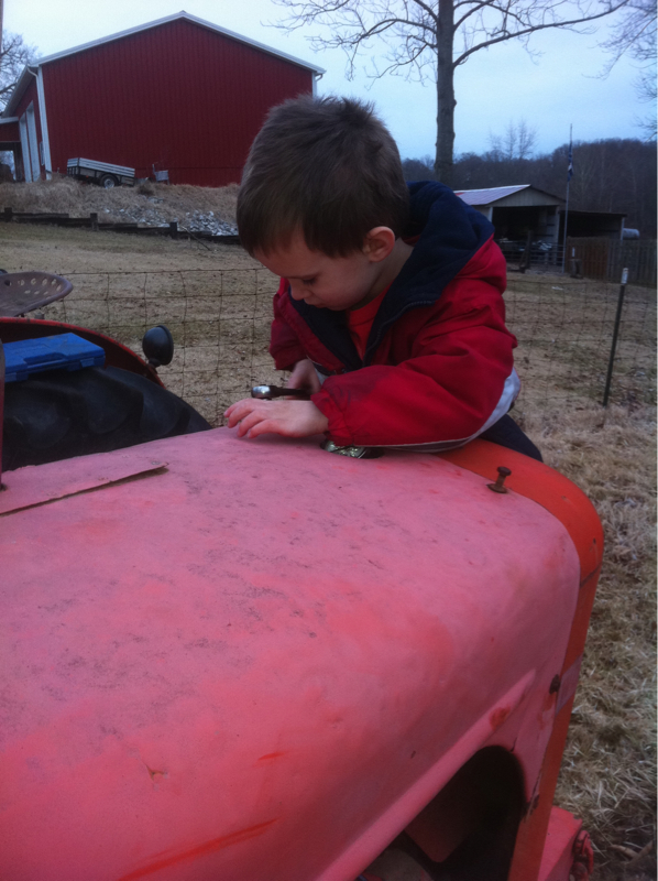

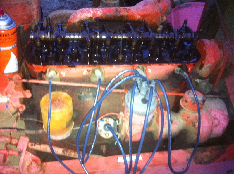

Moved to parts tractor to do a little work. Really glad I pull valve covers and check top end on long sitting engines. I would have a pile of pretzeled parts. Have one stubborn valve on number 2. Cleaned pile of sludge from gas bowl. Fuel was shut off so maybe carb won't look like garbage (really doubt it though). I will probably rinse tank. Will pull plugs and fill cylinders with ATF. Top end received a cocktail of oils. Oil bath air cleaner was a sludge pit. My three year old was really working hard to help and I enjoyed every minute. My chief goat mechanic was also lending help. I get a kick out of the plug wires on this tractor.
