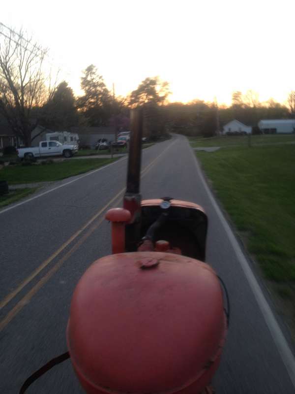

Been a little while since I worked on these. Pulled carb off of the running wd and degreased it. Looked to have had a recent kit in it so I inspected it on the kitchen table. Some one missed an idle jet so I poked it out and tossed in some new throttle shaft seals. Last night I shoved a radiator in and the fresh carb and took her for a cruise. Engine sounds great with good response and not really any smoke except puff of black on a hard fast lug (just right). I do need an oil pressure gage.
