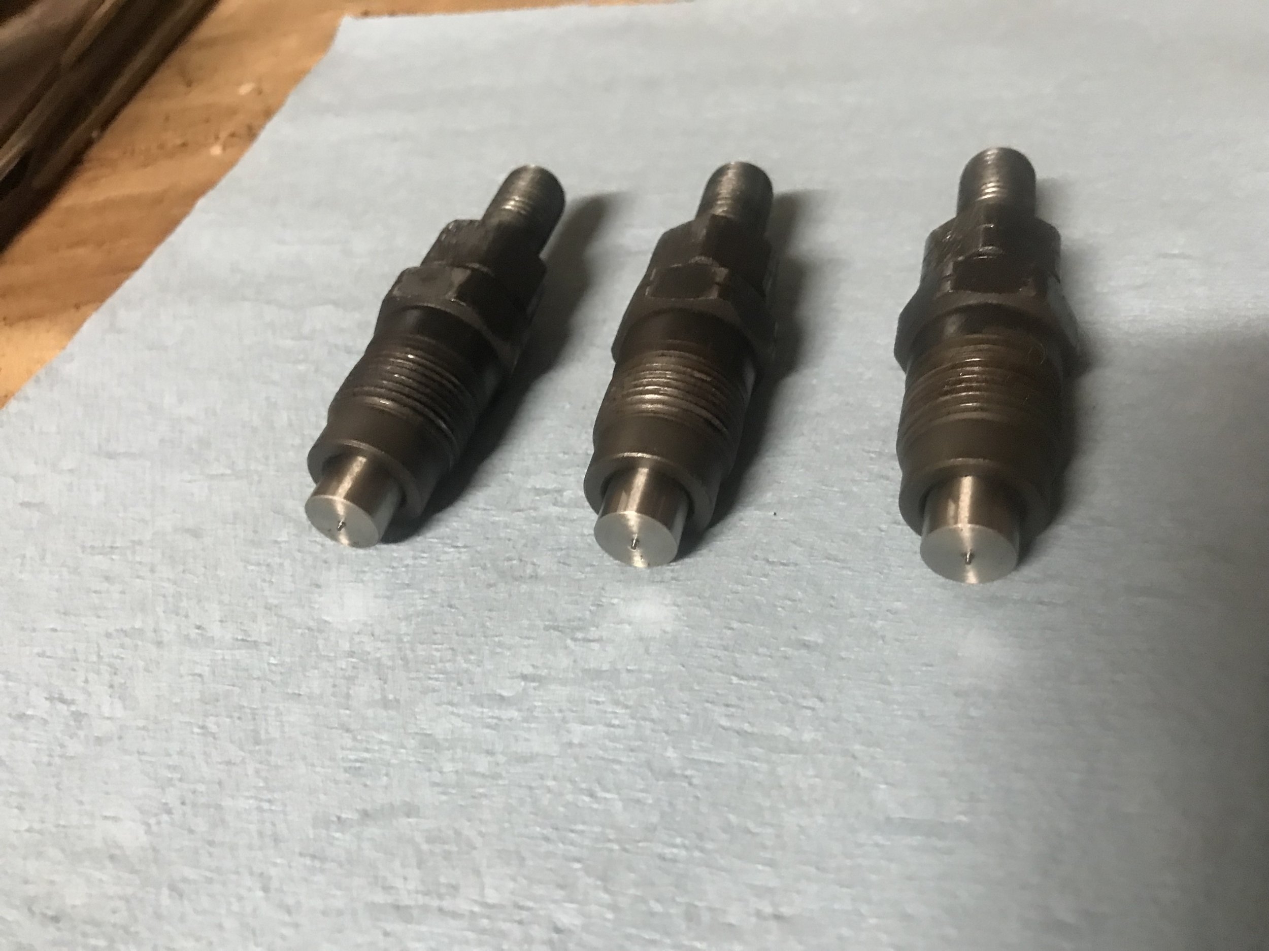

Rebuilt injectors
Probably should have just sent em to “THE PUMP GUY” here for a pro job but my local guy did a fair job it appears
Pop test repeat w/ rebuilt inj will be available soon

Pop test made such a diesel fog it was comical definitely all 3 working LOTS better
