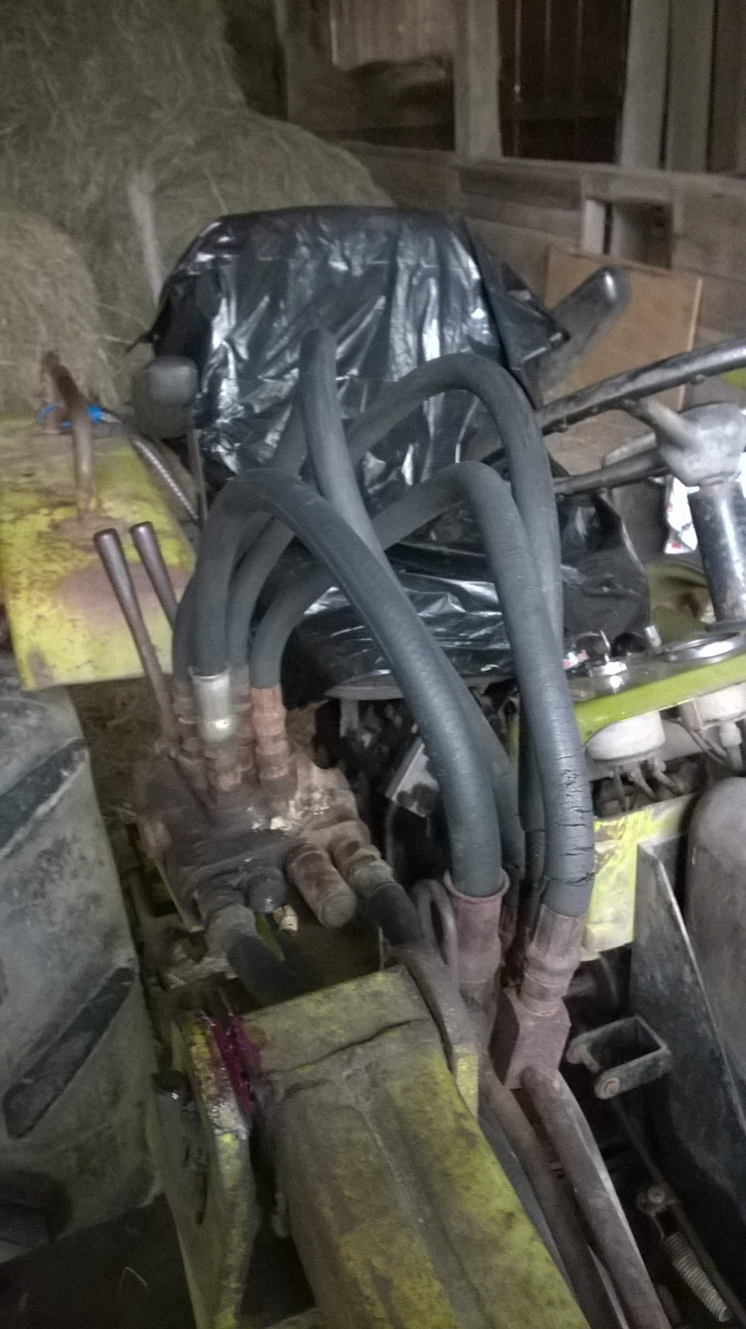

I can't honestly say I know what power beyond is. My current setup is one supply line, one return line and the 4 loader lines coming out of the top. There's a plugged port that has a PB on it. I suppose that could be power beyond. Like California, I think I'd prefer the hoses exit the bottom, less cluttered and less "in the way". I'll post over in Hydraulics because I'm also curious if this could be mounted horizontally such that the hoses exit the bottom (more protected?) and the lever arm reaches toward the drivers seat.

I hope these photos can help you configure your new loader control:
Here's my Before photo. AICO brand controller. (Also shows my chain carry tube .. a kid-size golf bag lashed on to the loader upright).
242597d1324500459-how-much-loader-drop-acceptable-p1190241rloadervalve-jpg
And After.
Prince LVT1GB5AB1. (Prince's catalog photo, confusing!) Has float, not regeneration. Exit ports are on bottom when control levers are mounted upright in conventional configuration.
301075d1359858949-power-beyond-vs-series-loader-p1360255rloadercontrolinstalled-jpg

This looks exactly like mine only with less fluid and gunk covering it. Our two machines must be long lost brothers. Did you end up with new hoses to go from the controller to the rigid lines along the inside of the loader arm? I don't see the plumbing for the supply/return for the loader. Mine runs, via two flex hoses, right along that foot rest to a box mounted below the seat. Am I just missing it in the photo? This controller more or less completely closes off access to the operator's station from this side of the tractor. Does that bother you? I've got that reservoir tank basically in the same spot, but I'm (still, but who knows for how much longer) thin enough to squeeze by it. I haven't used the machine enough to know yet if losing access from one side would really bother me. How do you feel about it?
