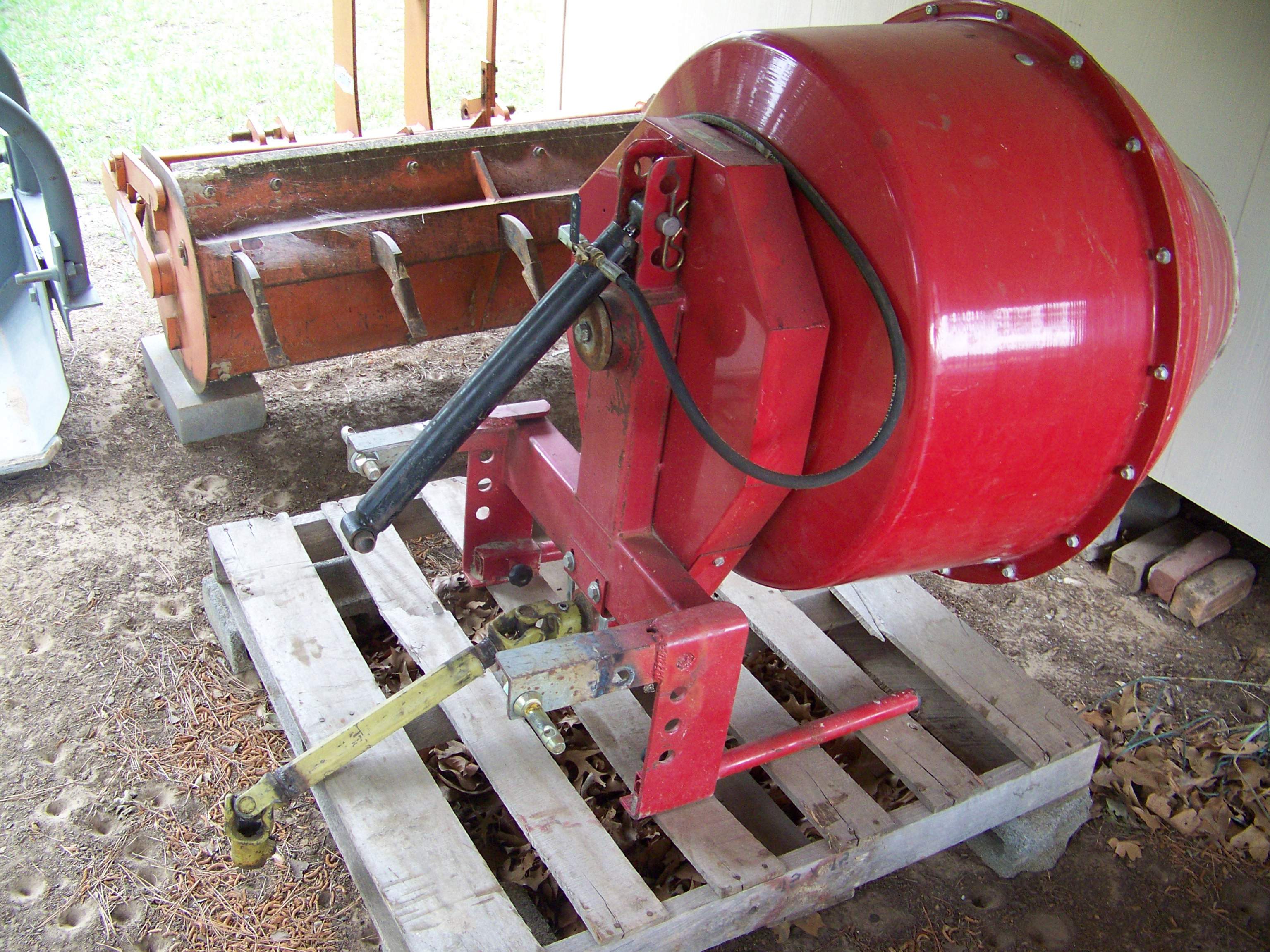

On a single acting cylinder controlled by the 3 point lever the line pressures and then the down pressure of the cement mixer just pushes the fluid back. Only one hose.
   / New (to me) YM240D #202
Ah got it; your mixer had no valve to control the flow!
   / New (to me) YM240D #203
The 3 point lever controlled the flow although I have a quick opening valve on the mixer cylinder inlet so I can lock it in any position. On my Bobcat I operate it by using one of the lift cylinder outlets on my loader valve. Probably sounds like that wouldn't work but I just mixed 36 bags of 80 lb sackrete a few days ago. I may owe an apology for all my blabbering in this thread but just trying to point out some of the hydraulic options on these old Yanmars. For sure, they are not all the same.
