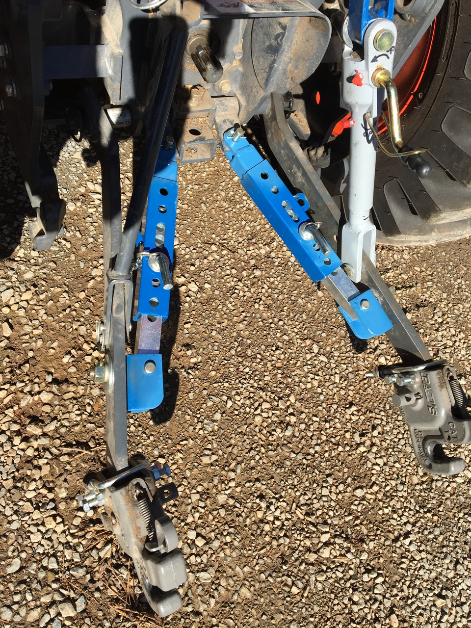

I'll suggest the Euro lower hooks. Those just work awesome, doesn't extend any further, no frame in the way, no need to modify implements, doesn't put things on a bind like the Pats do. It simply works and works great.
This thread has a lot of good info on these along with sources on where to get them: Upgrade Kioti DK6010SE 3-point Hitch
That's the one thing that's a little annoying about my Pat's QH. Trying to get those things straight is like solving a Rubik's Cube. For geniuses only. Mine are off by a little bit. One more than the other. But they solve the problem of one person implement attachments. IOW, they make it possible for one person to to attach and un-attach their implements more easily.
Yeah, I know some old-hand is gonna tell us how easy it is for him without a QH. Good on him. But for me, I like my Pat's.
That 'Euro' deal is intriguing however. But knowing nothing about the Euro hitch, I'd recommend the Pat's until something comes along that's better
