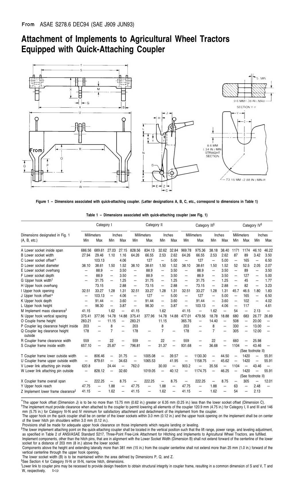

There has to be at least a dozen brands of CAT 1 quick hitches available..... If a CAT 1 implement does not fit the CAT1 QH its the fault of implement (manufacturer) and not the quick hitch....
Only negative I am aware of it most post hole augers will not work with QH and the QH may make it more awkward to connect up a PTO driven device like a brush hog/rear mower...
As for up/down/side slop its all in how you setup tractor arms to control motion of QH.... Very little room for up/down/side motion in QH to implement connection because of engineering standards in QH....

I'll suggest the Euro lower hooks. Those just work awesome, doesn't extend any further, no frame in the way, no need to modify implements, doesn't put things on a bind like the Pats do. It simply works and works great.
This thread has a lot of good info on these along with sources on where to get them: Upgrade Kioti DK6010SE 3-point Hitch

If buying 2nd hand implements, farm auction stuff, ect. Most implements just need minor mods to make them work with QH. Really helps if you know a welder.
