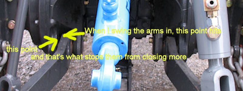

Kidding aside, I guess it's just my L3400 then. There's simply no way to make it fit unless I flip the lift arms over. But then my turnbuckles wouldn't reach the lift arms. Oh well...

A picture might help. I also thot of flipping the arms, but then they'd swing back and forth as the turn buckles won't reach.

Ahh. I see it's a design issue.. IE. the designers made the mounting ears so close that the draft arms don't have a large range of motion.. I've seen similar setups that have the draft arms with large balls with ears that allow the arms to have much more range of motion.
If your turn buckles don't reach.. that's when you scab on a nother bit of chain if needbe.

Plain and simple...A design that has the most range of motion seems like it would be the most desireable. That's my entire point. I applaud designers who incorporated this into their machines. Looking at his pic... moving those ears another 3/4" apart, and adding a lip and large(er) ball for the end of the draft arms.. he would have gained much more range of motion.
"Grossly undersized" is a completely arbitrary term. If person A has a cat 2 tractor that can hitch to a cat 0 implement, and person A has said cat 0 implement and can use it, and does,.. more power to him. If person B has a cat 2 tractor that is unable, by design, to hitch to that cat 0 implement.. and then person B calls the implement 'grossly undersized'.. then I'd have to call that a case of sour grapes, as per the fable. :rolleyes: Nothing more.. nothing less.
