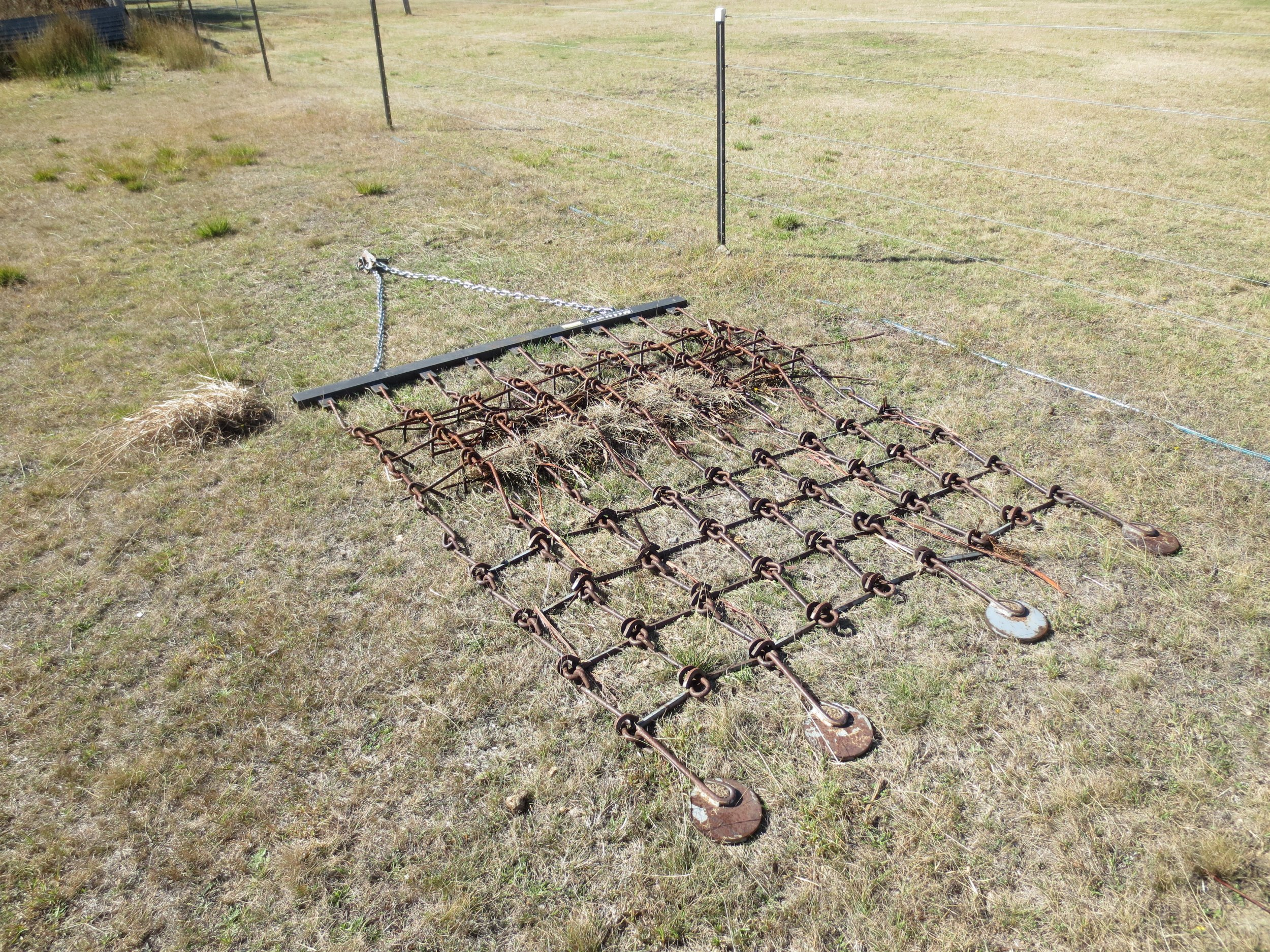

There are many manufacturers of chain harrows, which include different 'combinations... or you can knock-up your own (many TBN threads on that subject). My own (manufactured) has two sections; the first uses 5" V-shaped tines followed by a section of 'horizontal bar' ground effect chains. I'll pass the manure one or two times to break up the manure balls and then use my lawn tractor to mow/mulch the manure even further. If the manure is thick & compacted (especially around a hay feeder) I'll use a landscape rake to break it up.
Another implement that you'll appreciate will be a 'ballast box' on your 3PH (3 point hitch) as it doesn't stick out the back of your tractor as much as using a slasher/bush-hog as a counter balance.View attachment 697295
Thank you, Wagtail--I love the look of your harrow. If there is welding involved I won't be able to make my own harrow. But I'd love to have one like yours so I'll start looking for one just like it.

No welding involved with my chain harrow, it all 'hooks' together.
Talk to your, or other, dealerships as to what's available. Mine was made by a company called 'Silvian' who have a close relationship with my JD Dealership.
