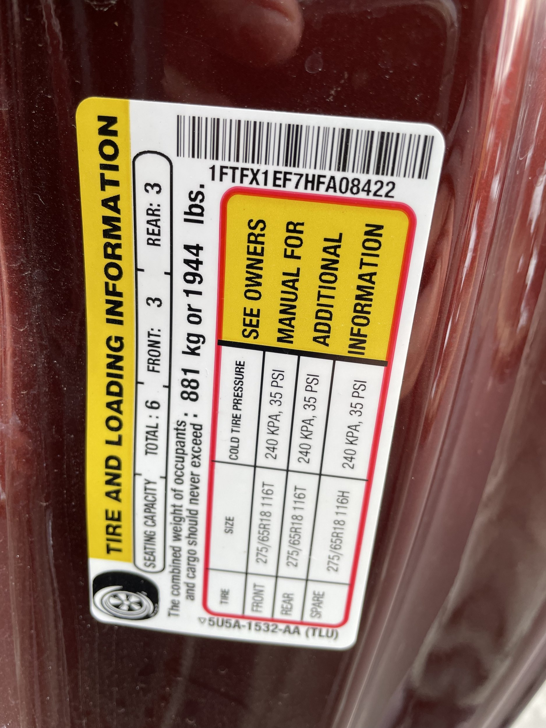

As I said before, what we say doesn't matter. He should consult the sticker on his door, as well as his owner's manual. My door sticker gives the GVWR, and has a note stating to check the owner's manual for more info. Upon doing so I determined that the towing capacity is 7000lbs for a pickup the way that mine is configurated.
The GCWR is 12000 lbs.
   / New to tractors and trailering them #24
I agree with the others, you probably don’t have enough truck. Off the record I actually bet you do have enough truck. I bet your payload with the smaller engine isn’t to bad. Tow capacity in a half ton is often limited by payload, how much hitch weight the truck will handle. In the case of your truck it’s probably limited by the engine/transmission combination. I attached a picture of the payload sticker, in this case 1944 pounds, which includes full tank of fuel but no people in the truck.
