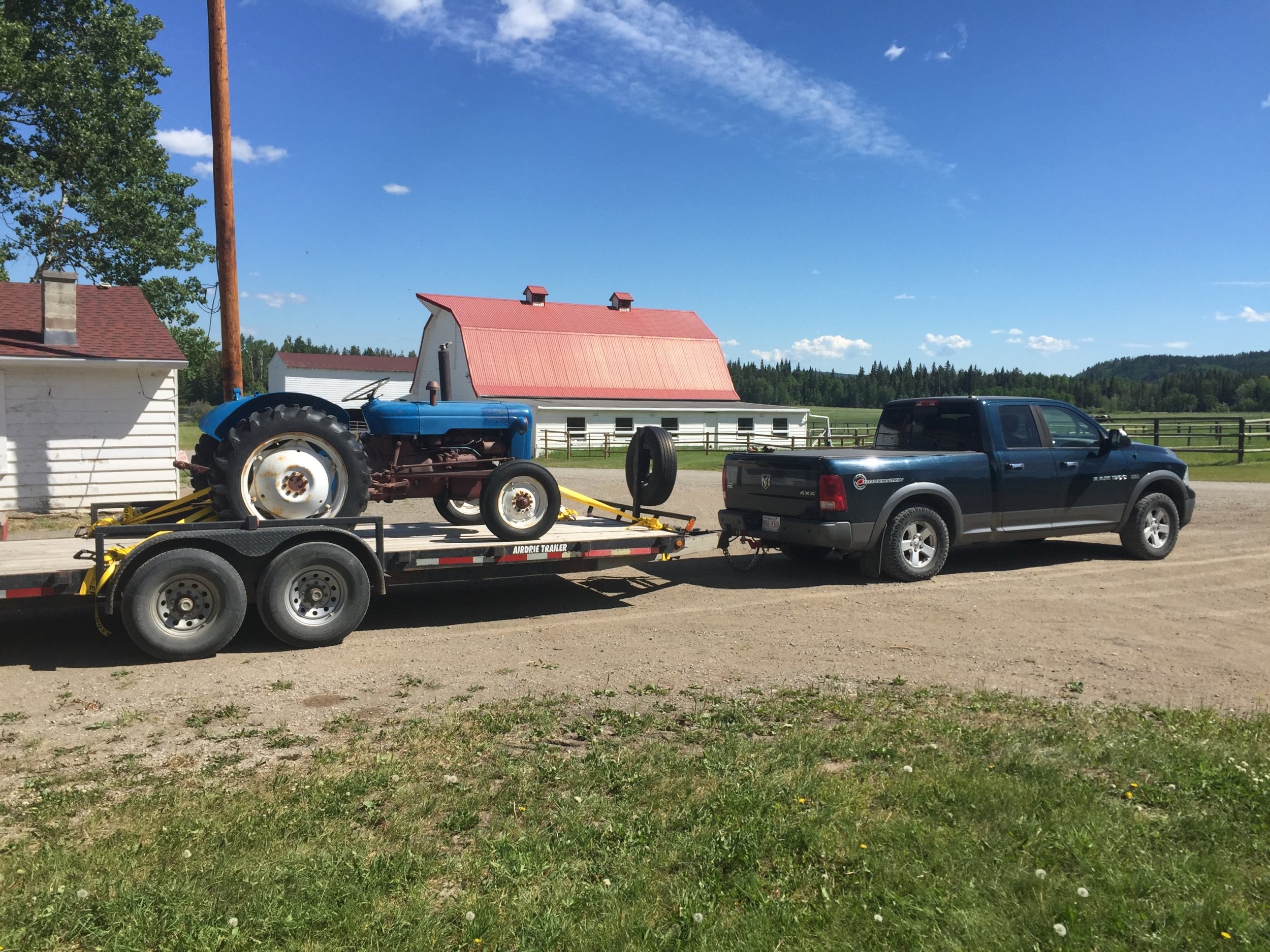

I'm considering buying a used (27hrs) Kioti CS2210 with the SB2410L and a backhoe. It also has the cab enclosure with heater.
I looked up weight and with the loader its almost 2000lbs but couldn't find the weight for one with the backhoe and enclosure.
First question is will my 2012 Ram 1500 3.7L with the towing package handle towing this tractor and a trailer?
Second question is what size trailer will I need. Does it have to be a dual axle or will a single axle car hauler work just fine. It wont be towed a lot mostly for maintenance and getting it to the property from our home which is 3hrs away. Once its to the land it will be staying there until it needs maintenance.
If more information is needed please let me know and I will post more.
Thanks so much for the help
Bernie
You won’t have a problem. Two axles for sure. Picture is of my 3000# Dexta behind Ram 1500.

Could you RENT a truck to move it? Or hire it out? If infrequent (I've had to haul my Kubota in twice in ten years) it is likely worth hiring it out. Is it Under Cover, Lock and Key at 'the land?'
   / New to tractors and trailering them #38
Welcome to TBN. A lot trailer experience here. You'll get flooded with opinions and ideas.
I wouldn't attempt hauling it with a single axle trailer. I only want to buy the trailer once. So I'd go for a Bumper Pull, tandem axle, 7K lb capacity, 16ft + 2ft dovetail, Car Hauler trailer.
This is exactly what I use for mine with a F-150 7700. Handles great and never had an issue. Also, I have brakes on both axles.
