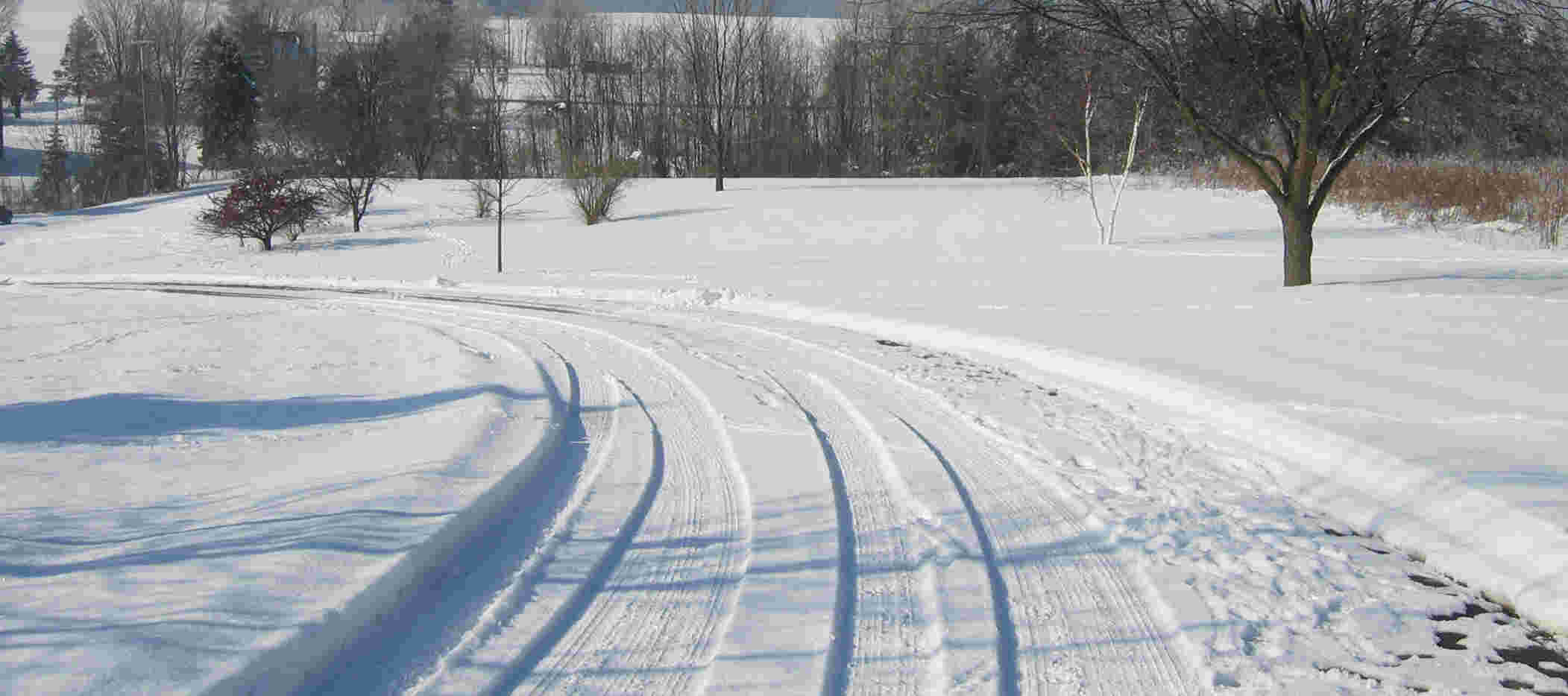

Edit : this pic shows the slope of the lawn behind the house!
Well, I tried to attach some pics, but they were to big. I'll have to resize them at work. I've attached two pics of parts of the lawn, but they don't really show the grade/slope very well.

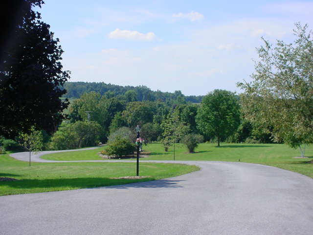

#22
same part of the lwan, in the summer

   / new to tractors, thinking about a powertrac... #24
I think I have a solution based on the pictures. Invite someone on the forum with each size machine to come live on your place - then you won't have to buy a tractor after all. /forums/images/graemlins/grin.gif
There are some Connecticut and NY owners. If possible, visit a few and try out the PTs.

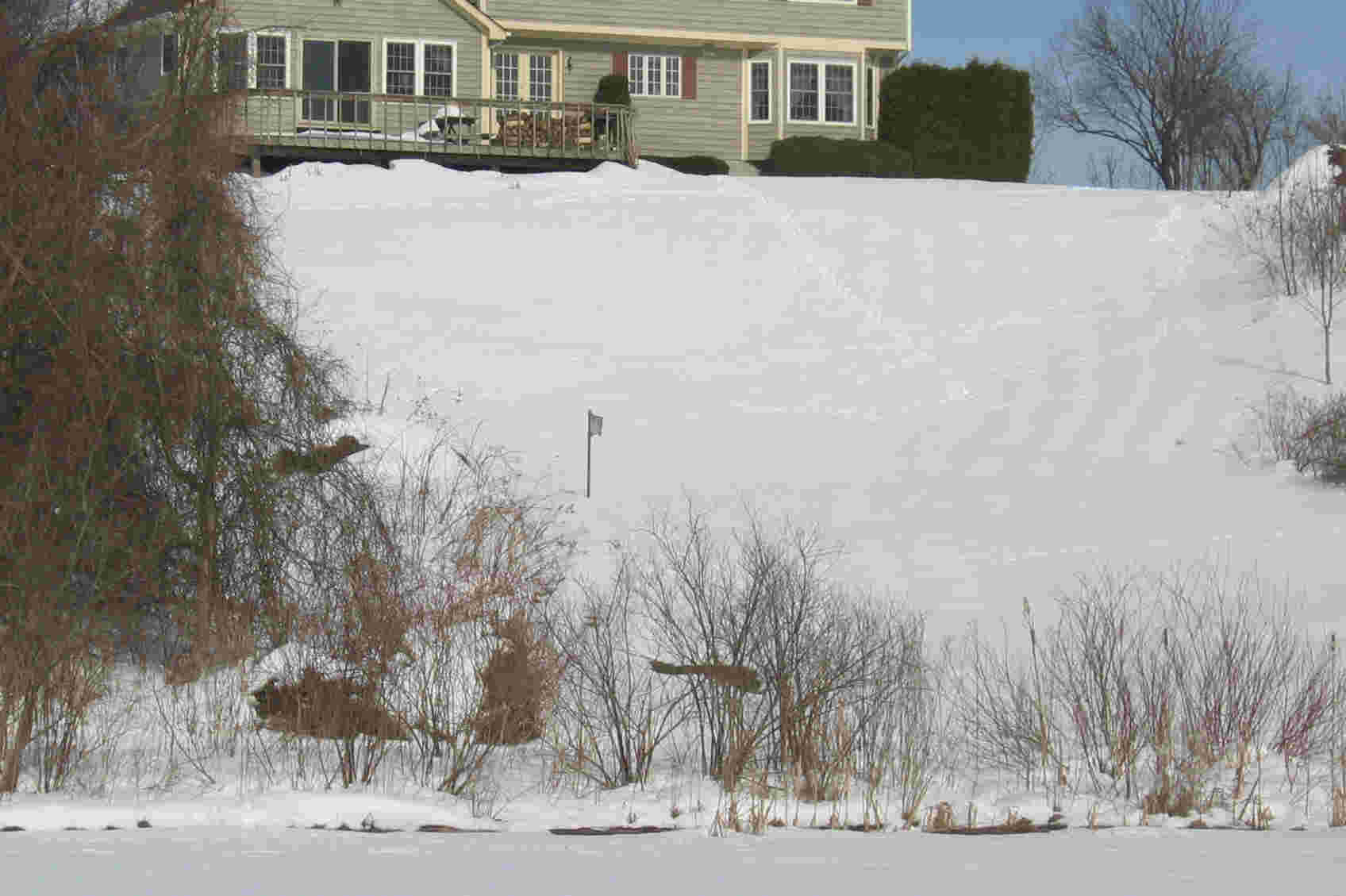

#25
pic of part of the lawn by the drive, in the winter...
   / new to tractors, thinking about a powertrac... #26
dukenyc, I'm located in Northwest corner of Ct., probably on your way to NY property. Your welcome to try out my 1430 as long as you don't mind looking at a dirty one.
   / new to tractors, thinking about a powertrac... #27
You have a very nice looking property!
I agree. There are enough PT owners up your way to go and try one out. That's what I did and it really made up my mind.
I really think that the 1845 would be the ticket for you. Remember that (I think) it already comes with the 72" finish cut deck, so that makes it around the same price as a 1445 or maybe even cheaper. And it is smaller than the 1445.
I don't know if you have anything that the 425 can't handle, it will just take longer.

The PT model lineup can be a bit confusing at first. Note that in the diesel models the 1*** series is the Low Profile series where the operator sits down in front of the engine. The 2*** series has the operator sitting above the engine and has an optional true back-hoe (not mini-hoe) available that mounts/dismounts quickly to the rear of the machine.
If the immage of the "1445" you are looking at seems to place the operator up fairly high, you may be looking at a 2445 instead. While any of the 4** gas or 1*** diesel series will be quite stable on hills compared to any CUT, the 18** slope mower series are the ultra-low profile machines rated for the steepest terrain.
By all means take advantage of any and all invitations to actually look at and test drive the various models. You will understand and appreciate the differences much better than pictures or specs alone.
Keep in mind that an articulated machine takes a bit of getting used to, but once you get the "hang" of how to manouver it to best advantage it is hard to accept anything else.
From the pictures of your new place, I think you would be happier in the long run with one of the larger models versus the smaller ones.

Thank for the replies. I really love this property, and I can't wait to move. I have only been there in the winter, and I have only a few pics from the summer.
Regl, I'll take you up on that offer, If it wasn't dirty, I am not sure if it it would be worth seeing. What part of CT are you in? I am in New Haven.
So, how steep do you think that back hill is? Is it 30deg, more? Will a 425 do the job?
The advantages of a small unit for me are: easier to store until I build a dedicated shed, easier to move around the trees, lighter, so easier to deal with if it gets stuck or breaks down.
The larger machines: more capable, faster at mowing (especially if the larger deck fits the 1430).
As a side note, I know alot more about gas engines than diesel.
I don't want to take all day to cut the grass, and I would like to periodically (once a month or so) clear a shooting range and a few paths through woods and along the pond. The FEl I'll use to transport firewood and other items. I am sure I'll do more in the future.
