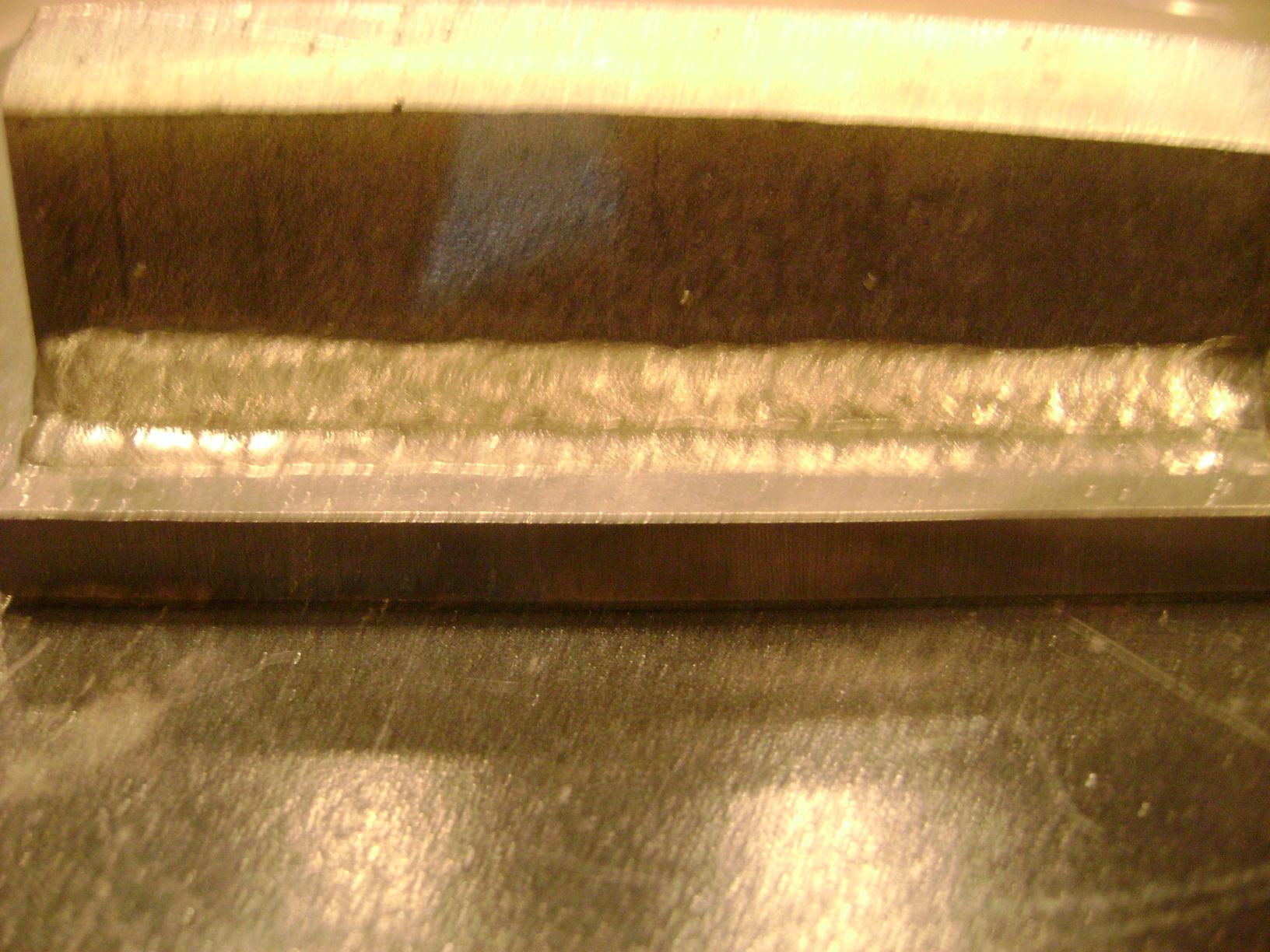

stormpetrel in case you didn't understand what I meant about adding two more passes. Here is a really crude drawing of a 3-pass fillet.
I put some hooks on my fence spooler awhile back. I used 7018, and remember these hooks are for only holding the spooler onto the forks, so no real load, or I may have put 3-passes also.

If you have a weed burner, or torch of some kind pre heat the base metal and hook, then run two more passes like I suggested earlier. Just make me feel a lot better is all.
Not a very good picture:eek: but here is what a 3-pass fillet is suppose to look like. This is NR-212.

Oh....BTW, you were wanting me to lay another bead down on the loader top, yes? In other words switching #s 2 and three on your diagram....?
Your weld would be #1, add #2, and #3.

I went back and did a couple more beads.......I was very resistant to the idea, but am happy that the hooks are strongly welded. Just today my equipment trailer got a flat tire while loaded w/dirt I put on it excavating. I used the tractor and a 3 ton jack to lift the trailer up; It was way beyond the capacity of the loader. No problems.
I have been practicing steadily on any steel I can get my hands on. The welds aren't getting any better looking. But I am learning to make strong welds with my little machine. I welded a hook onto my grapple for lifting lighter stuff. The paint two inches from hook (beyond what I had ground off to get clean metal for the weld) burst into flames and the steel glowed cherry red after the third pass. It was 1/4" material. Not bad.

For your first projects you should be welding things that wouldn't cause serious injury if they broke. Lifting hooks fall into this category. 3 passes was suggested because of your inexperience and also because your first pass looked a little cold and might not have had enough penetration into both pieces. I realize you want to put your new welder to work but you need to get some more experience before you weld things that could potentially be dangerous. I think Shield Arc would agree since he has stated several times that's it's scary when anyone can buy a welder and go to building a trailer with no welding experience. With practice your skills will improve but you need to give it some time.
