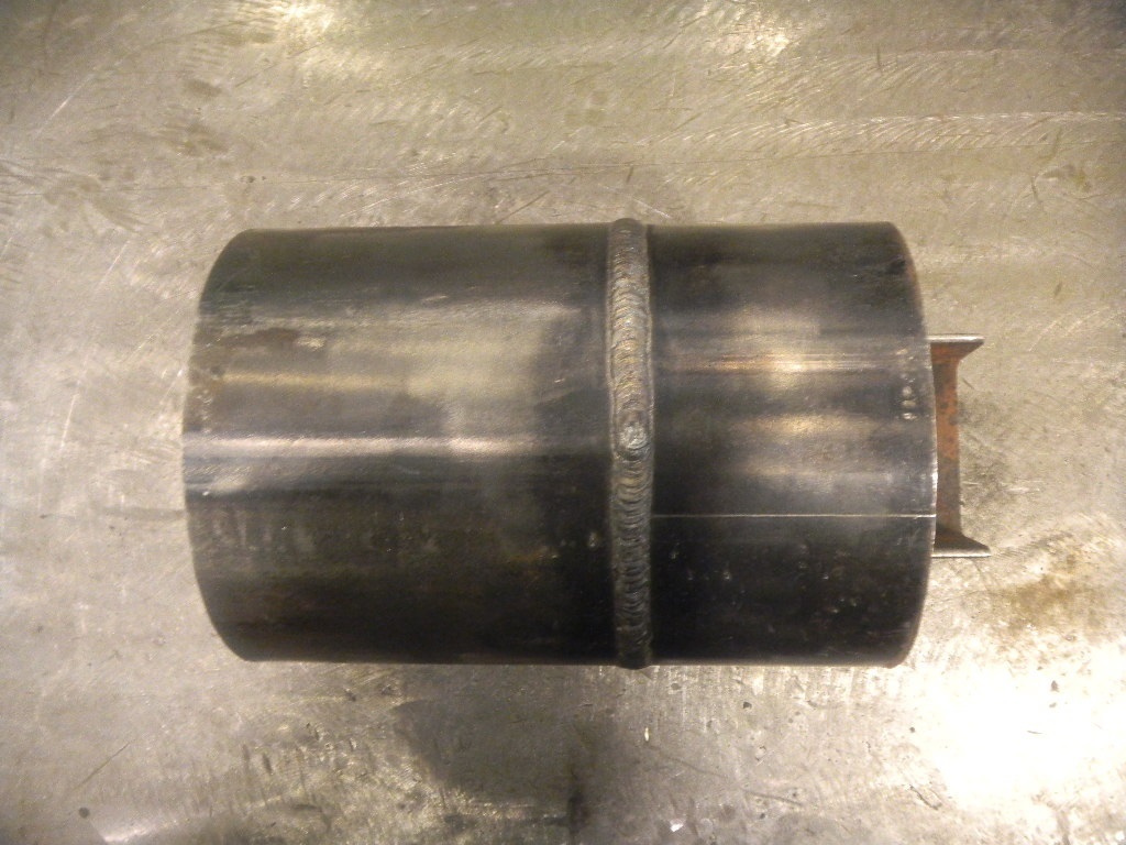

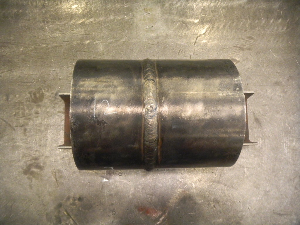

BMan2005 I own some of the best welding machines ever built! I' am so impressed with my Everlast PowerArc 200 ST. It welds every bit as nice as my $4,500.00 Lincoln V350-Pro.
Here is what it can do with 6010, and 7018.

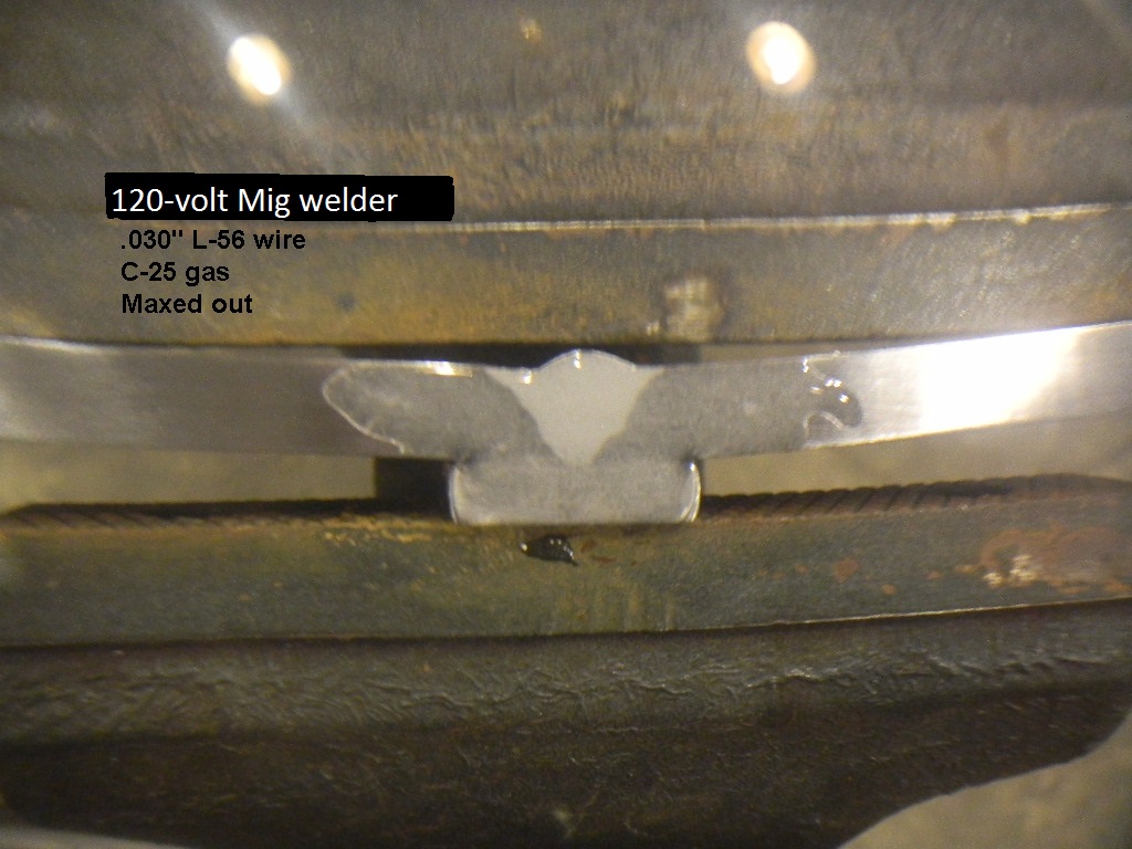

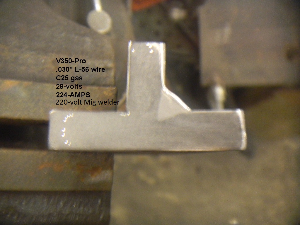

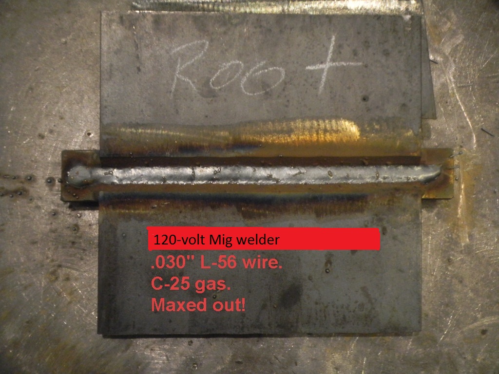

If you buy a Mig welder, buy one with power! Mig welders are notorious for making cold welds that look good, but there not! :eek:

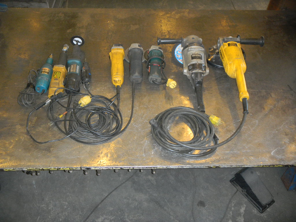

I appreciate all the suggestions guys. It'll be farm implements and trailers I mostly repair so sometimes metal being the cleanest isn't easy. So with what y'all said let's say I go with the Everlast stick welder. What else would I need to go with it?
/ New to welding #14

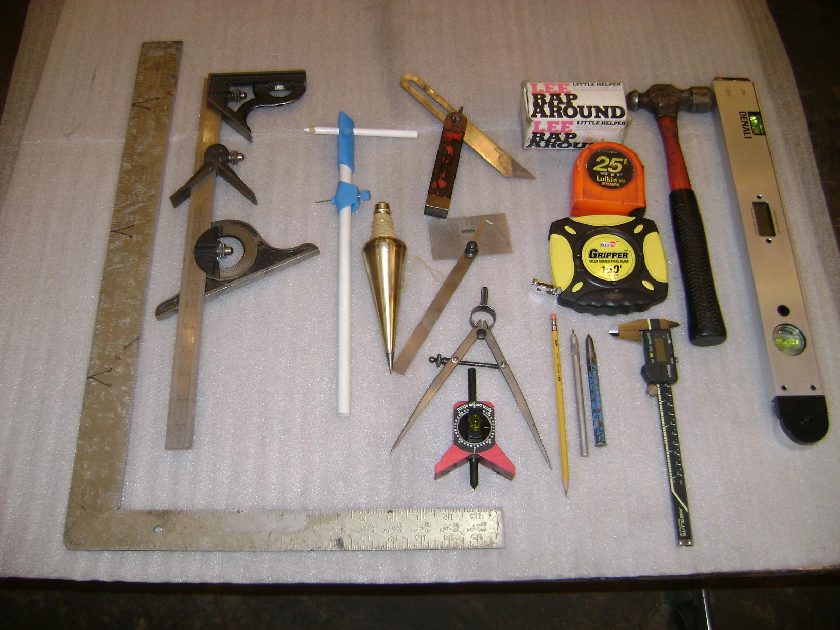

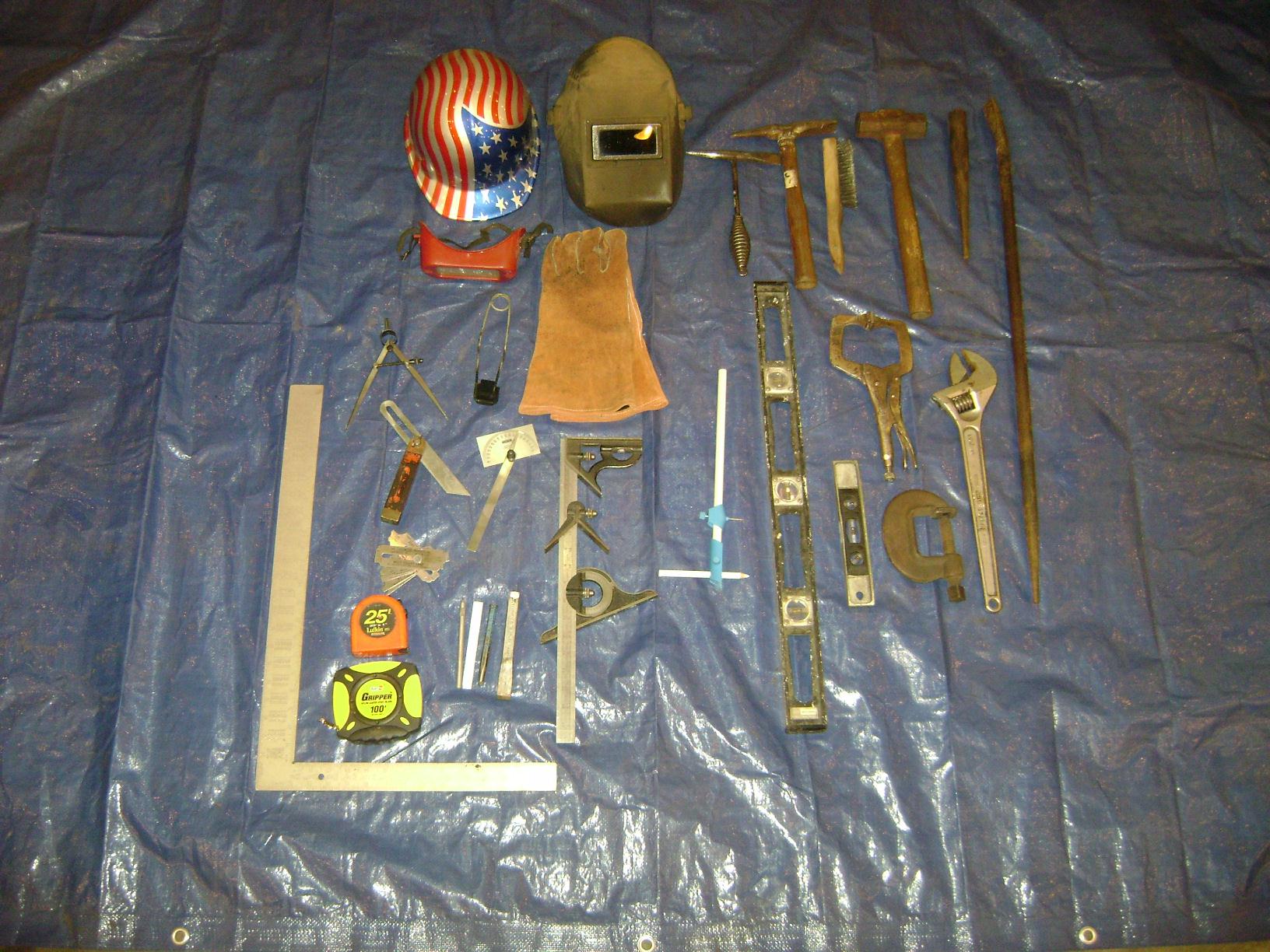

In your third picture, what are the four on the left?

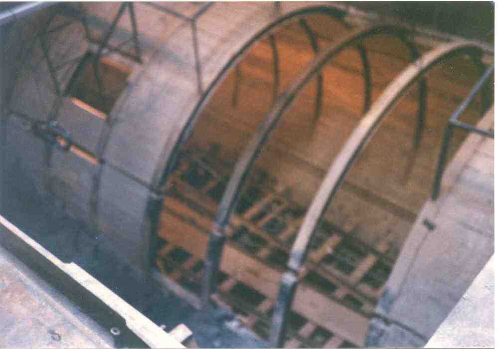

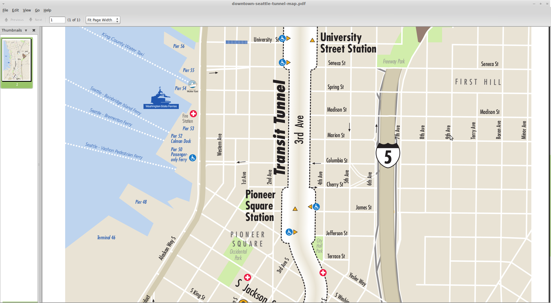

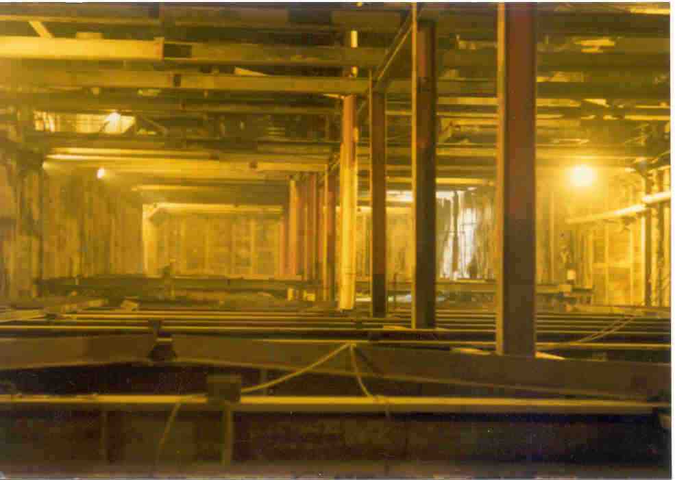

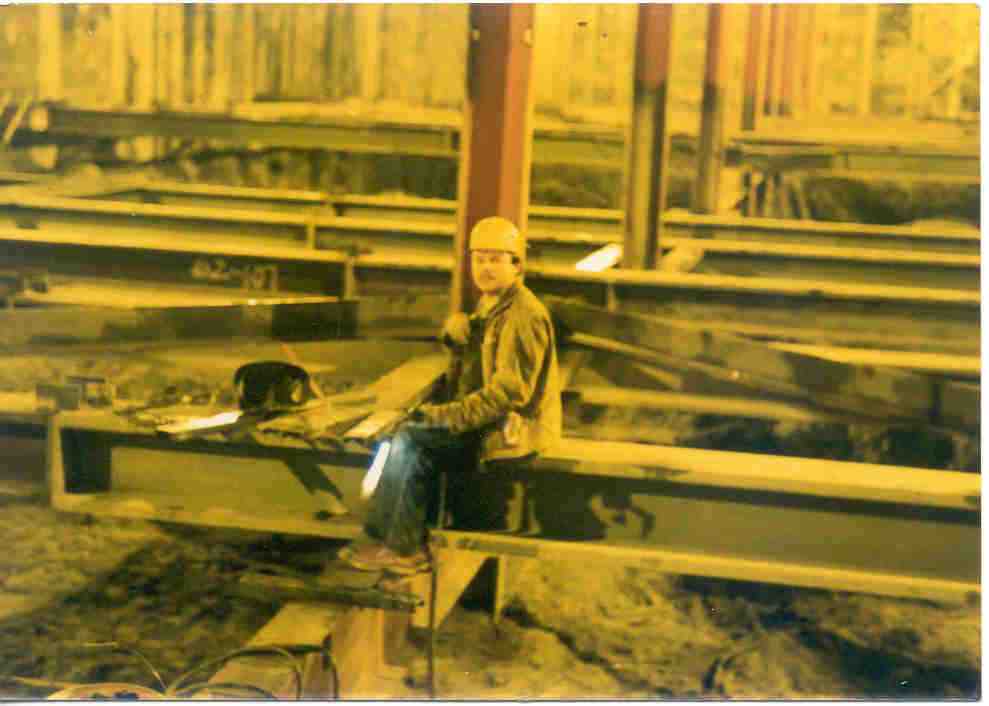

When we built the Pioneer Square Station of the Metro bus tunnel down town Seattle. We lowered the beams down with a crawler crane setting on 3rd avenue. Track loader drug the beams to there locations, and an excavator set them in place. Before setting the beams in place we had to cut them to length, and weld plates on the ends. We used self shielded wire. Majority of the beams we didn't clean as well as we should have.:eek:
We placed over a million tons of falsework iron in that station!

Pretty good bit of hardware Shied Arc. I have some, but definitely not most. Lol I'll be investing in a pretty good bit of stuff to go with the welder looks like. Also I will PM Mark about the welder. I'm sure I'll be back in here with alot of questions, so excuse the newbie in advance.
