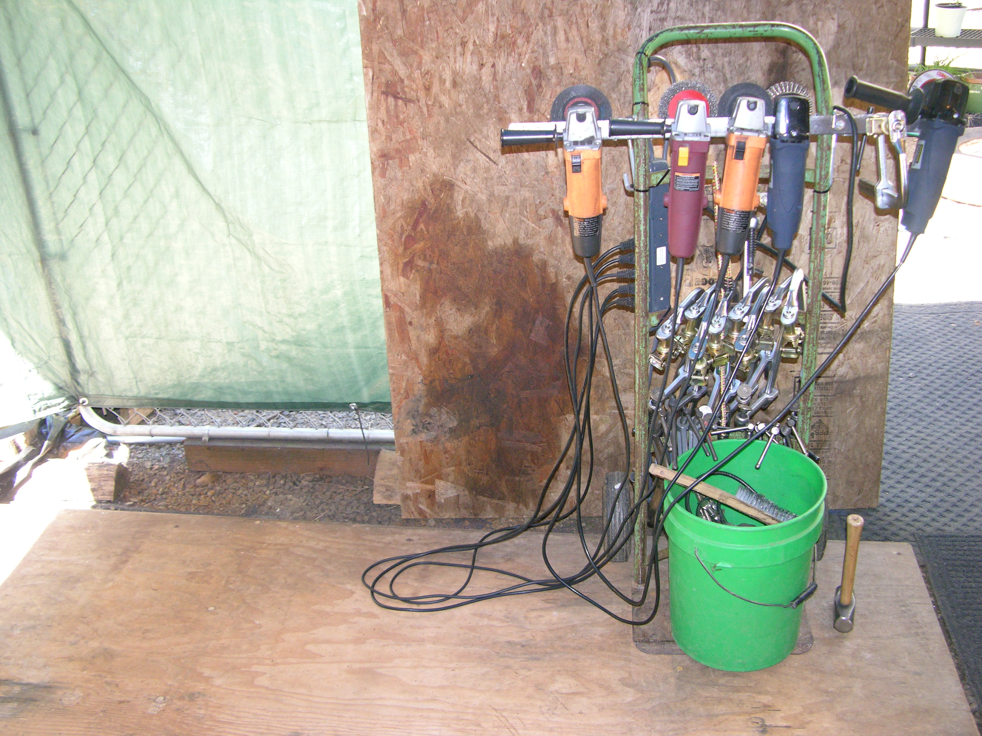

Re-purposed hand trucks - this one has a power strip tie-wrapped to the back, so just ONE extension cord needed - looking at your situation, you might wanna relocate the axle to use bigger wheels (same for me, just haven't got around "tuit" yet); 13" are MUCH better)
piece of 1/8" FB lets MOST side grinders just slip over it and hang. For transport, I just grab the whole bundle of power cords somewhere near the middle and hang it up over the hand truck handle... Steve
BTW, as shown these can be a little tippy - I later put a couple of those rectangular buckets kitty litter used to come in, moved clamps down to those - improves balance noticeably - the OTHER advantage: easy to move those "too portable" goodies back into secure storage when yer done...

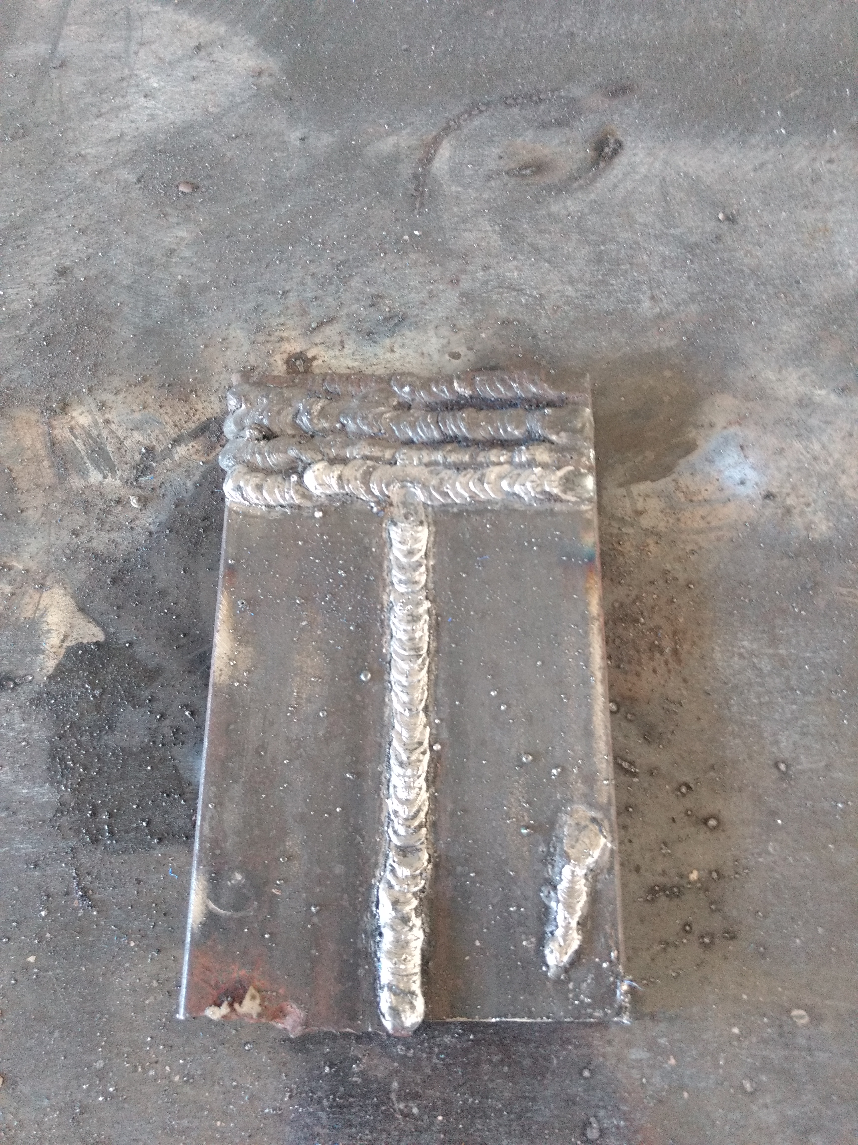

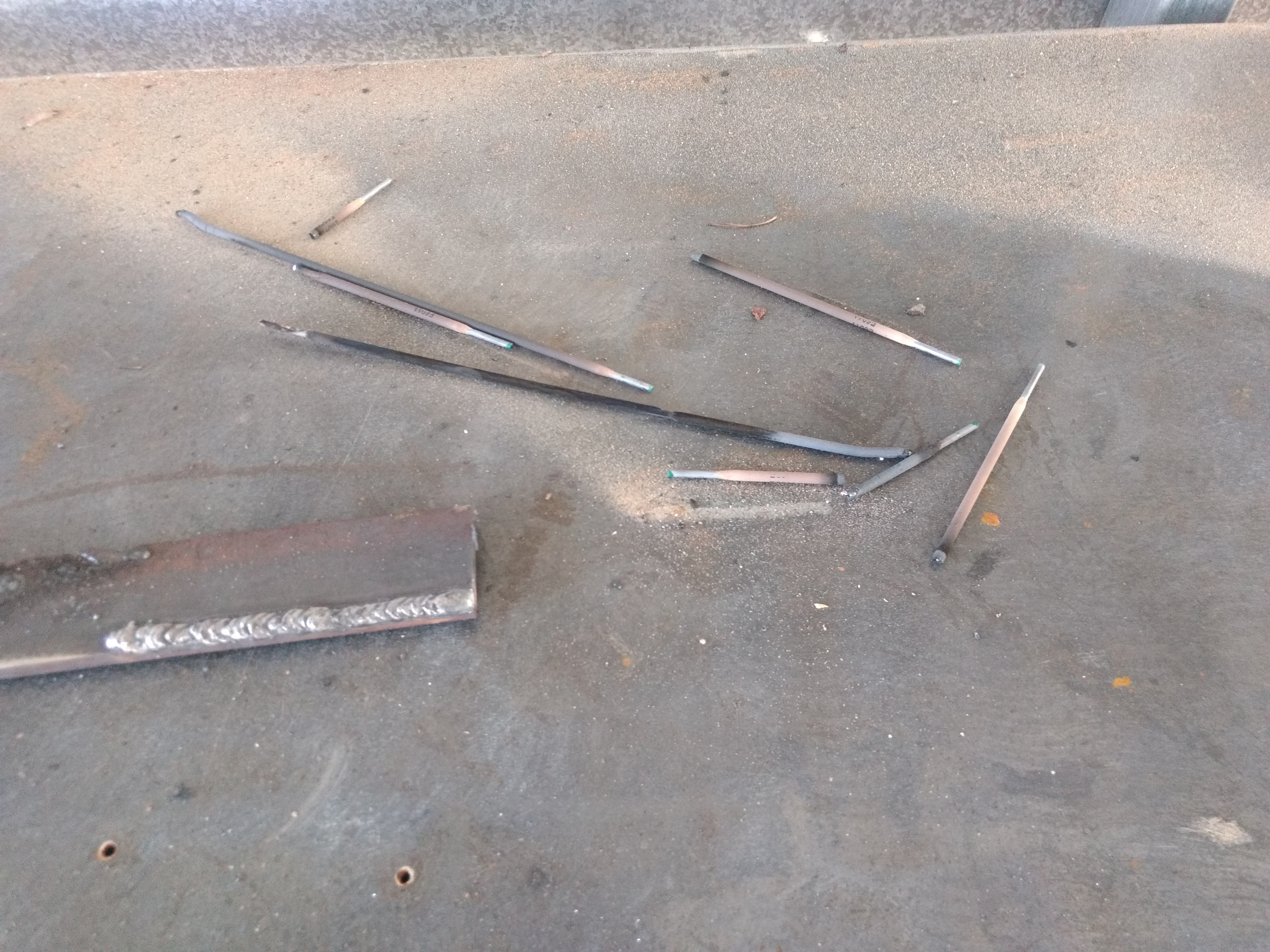

My first set of casualties.... Lol. Oh and my first weld after i finally kept the rod from sticking.

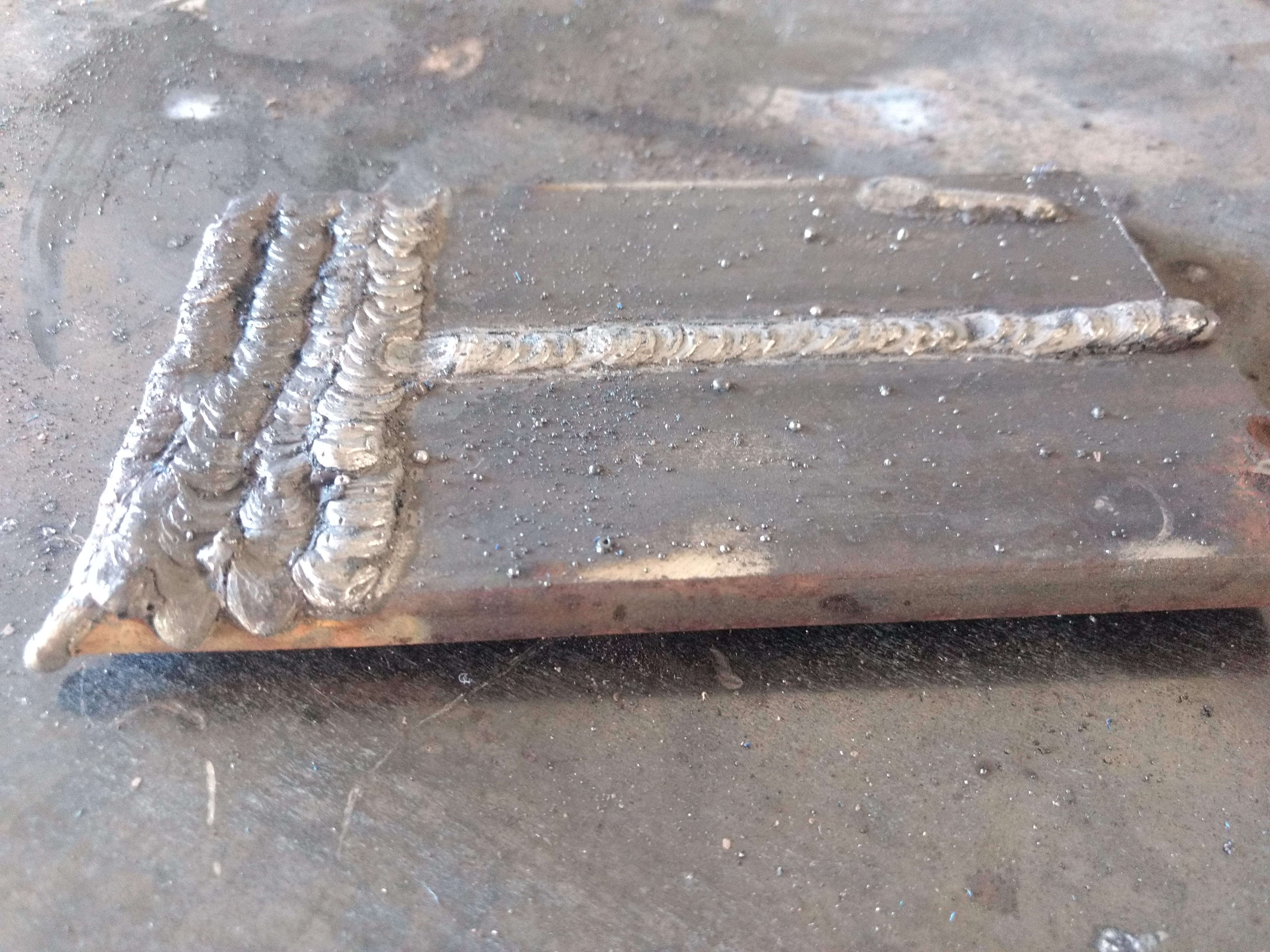

Ran these after the first weld them had to quit so I can hit the road. Couldn't resist a few minutes with it first though :). Getting the arc started kicks my tail.

These were 1/8" 6011's ran at 70-95 amps. Should I have tried hotter for it to arc and not stick easier?
   / New to welding #117
Did you put the ground lead in the 6010 port on the welder?

#118
SA, that's actually a really good question, and gives me hope I had it hooked up wrong. I was between packing when it was delivered & I remember deciding between 3/32 7014 or 1/8 6011 after my leads were hooked up. We'll see when I get in Sunday or Monday I'll be sure to hook the leads up correctly and see if it gets going easier. I do know after I got the weld going it was easy to keep it going, it was just getting it started! But I can see the addiction, watching the Puddle and the arc digging in like I've watched videos of and read about. Pretty cool stuff!

I've found with my PowerArc 200ST. ESAB's 10P-Plus 6010, and ESAB's Acclaim 7018 run the best.
When running 6010, or 6011 make sure the ground lead is in the 6010 port on the welder.
   / New to welding #120
I've only been stick welding a couple years so I am pretty new and I remember the problems I had starting an arc. For me there were two things I could do to make it easier. Turn up the amperage for practice to get the feel and relieve frustration. Then try turning it down to measure your improvement.
Now if I need to use very low amps I find starting the arc with the rod tipped at a very steep angle so I use the coating as a spacer so to speak really helps. Soon as the arc starts tip the rod up where you want it.
