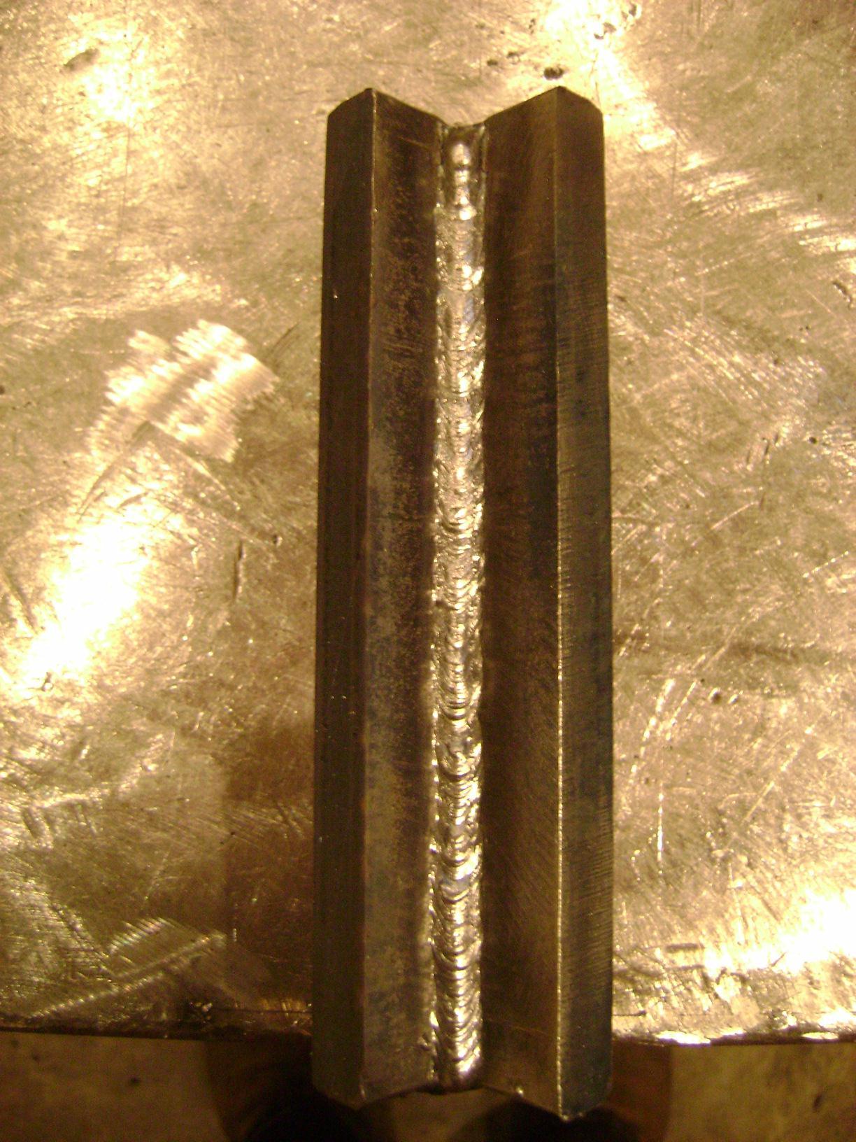

I tried some Hobart 1/8 7014 vertical up just now and :thumbdown::thumbdown::thumbdown:
But I remembered reading to run it vertical down some where with the amps turned up and boy did that make a PURDY weld! Pure child's play. Lol. It literally almost runs itself.

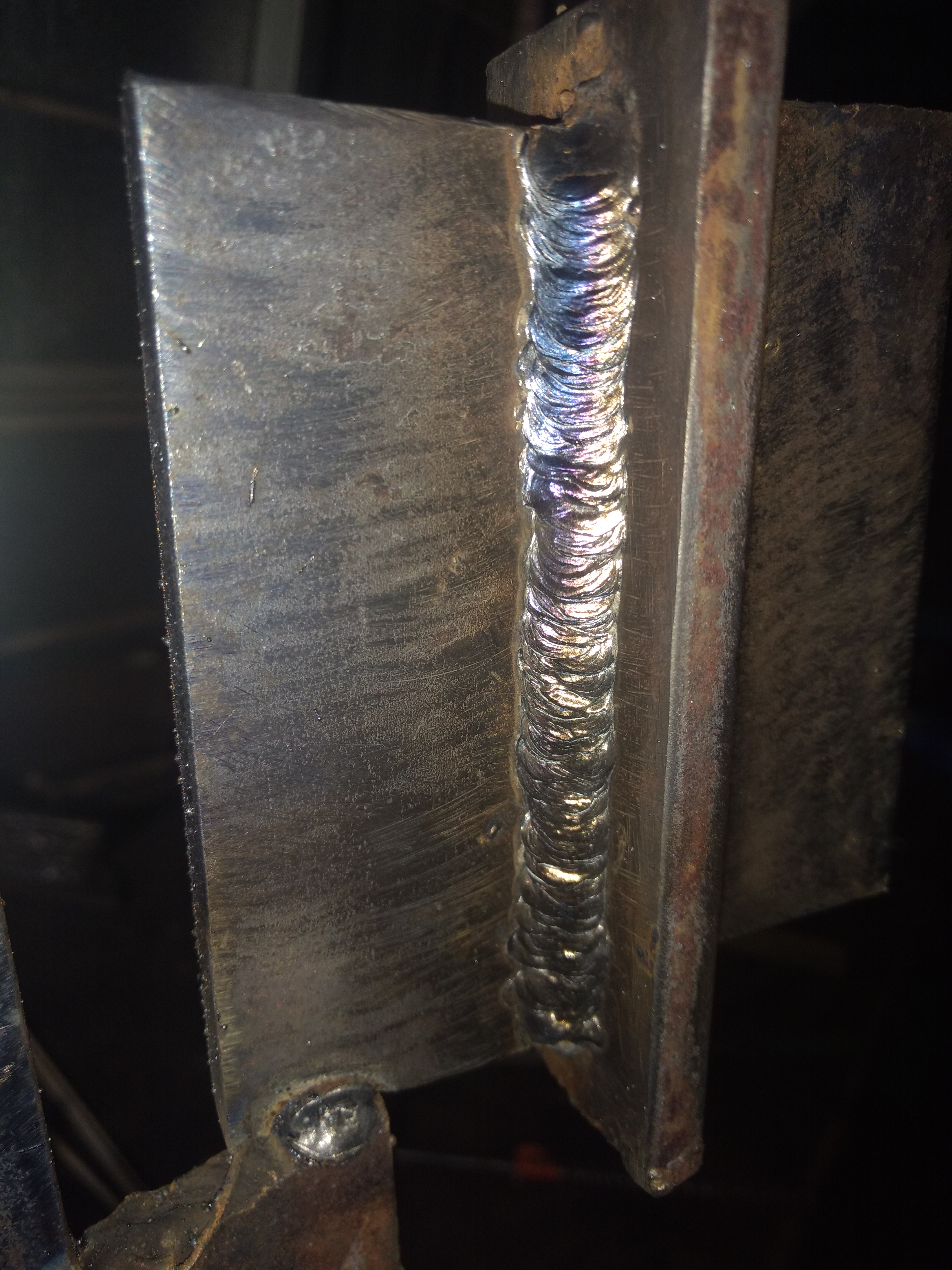

Coming from the structural welding world, I don't believe in welding vertical down hill. Now pipe lines, and a lot of pipe is welded vertical down hill every day.
This is 7014 vertical up hill.

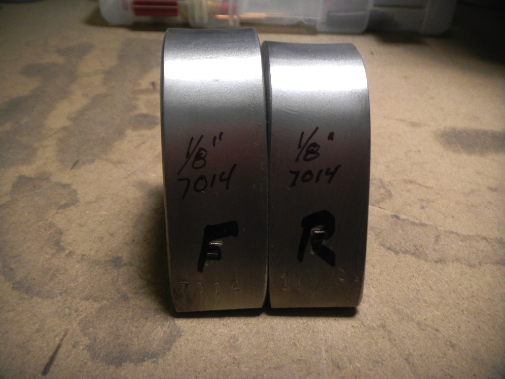

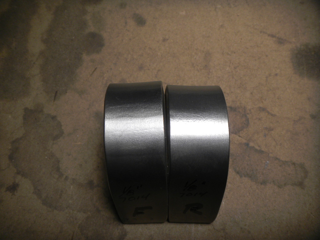

Here is some more 7014. For the majority of the welding that members here will do at home. Anything that can pass a bend test, is good enough.
Thanks for sharing that SA. I think it'll be a good rod around here for most stuff. I bought a can of Excalibur 7018 the other day I plan to use when time allows. Going to beef up my brush guard on the tractor.

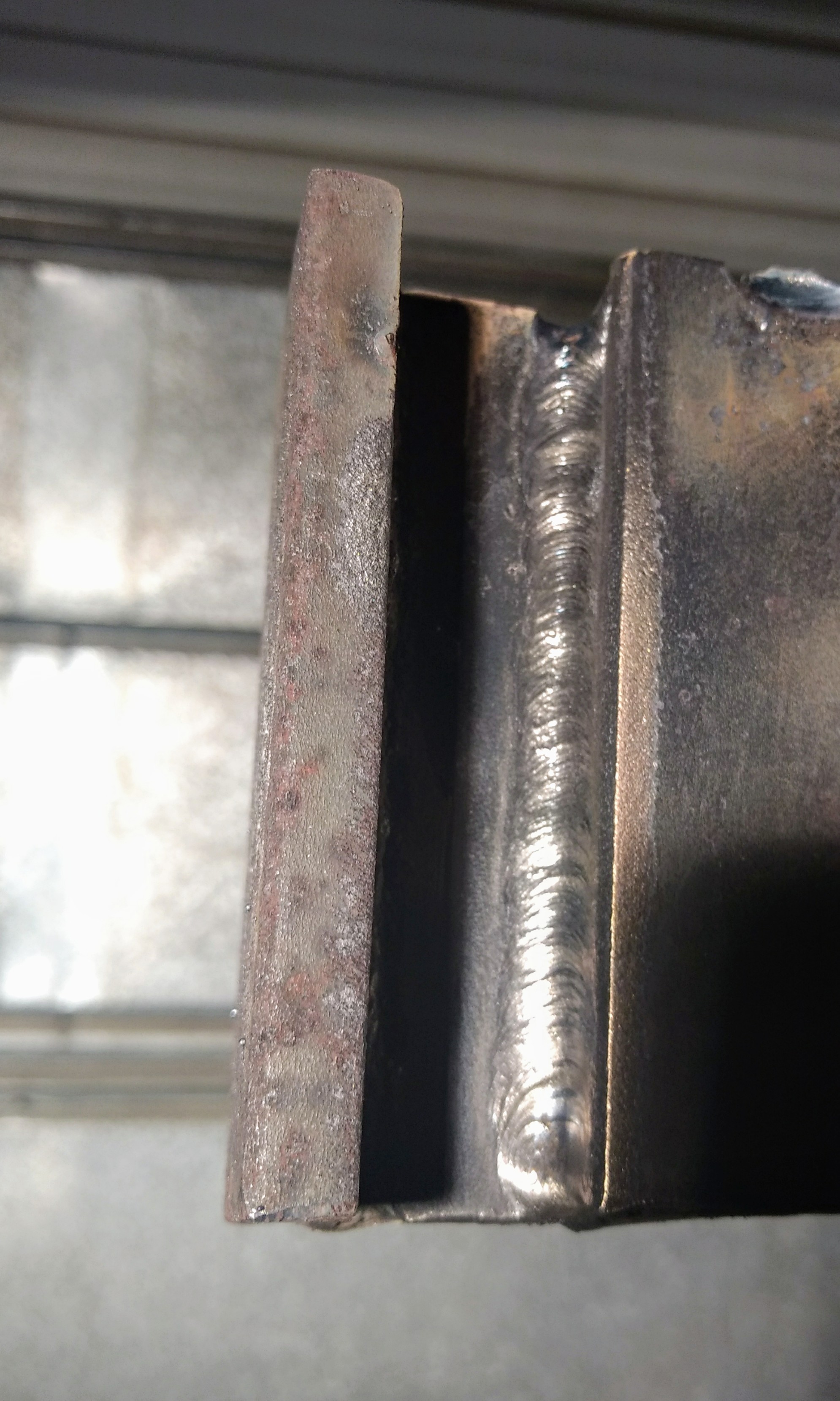

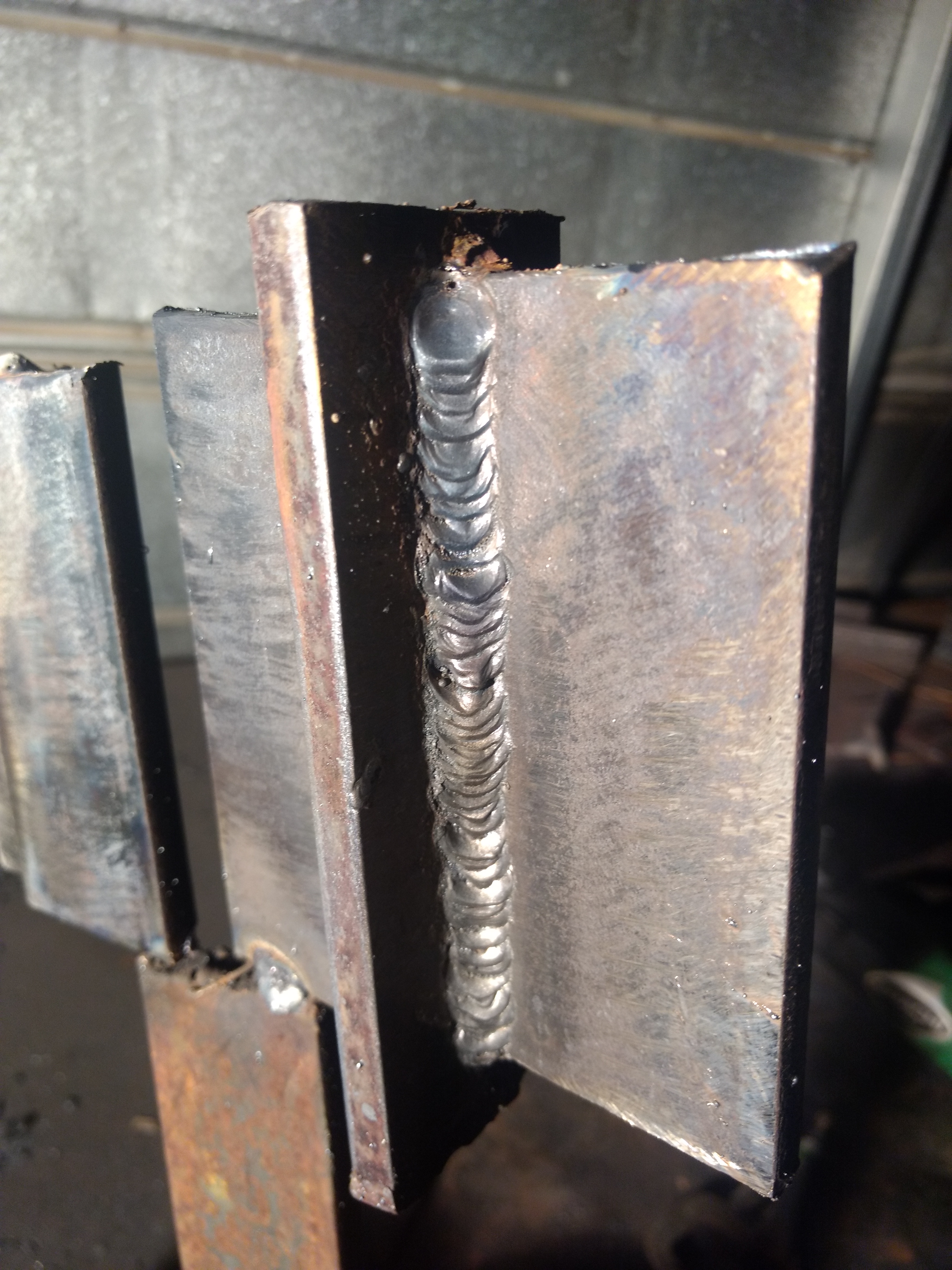

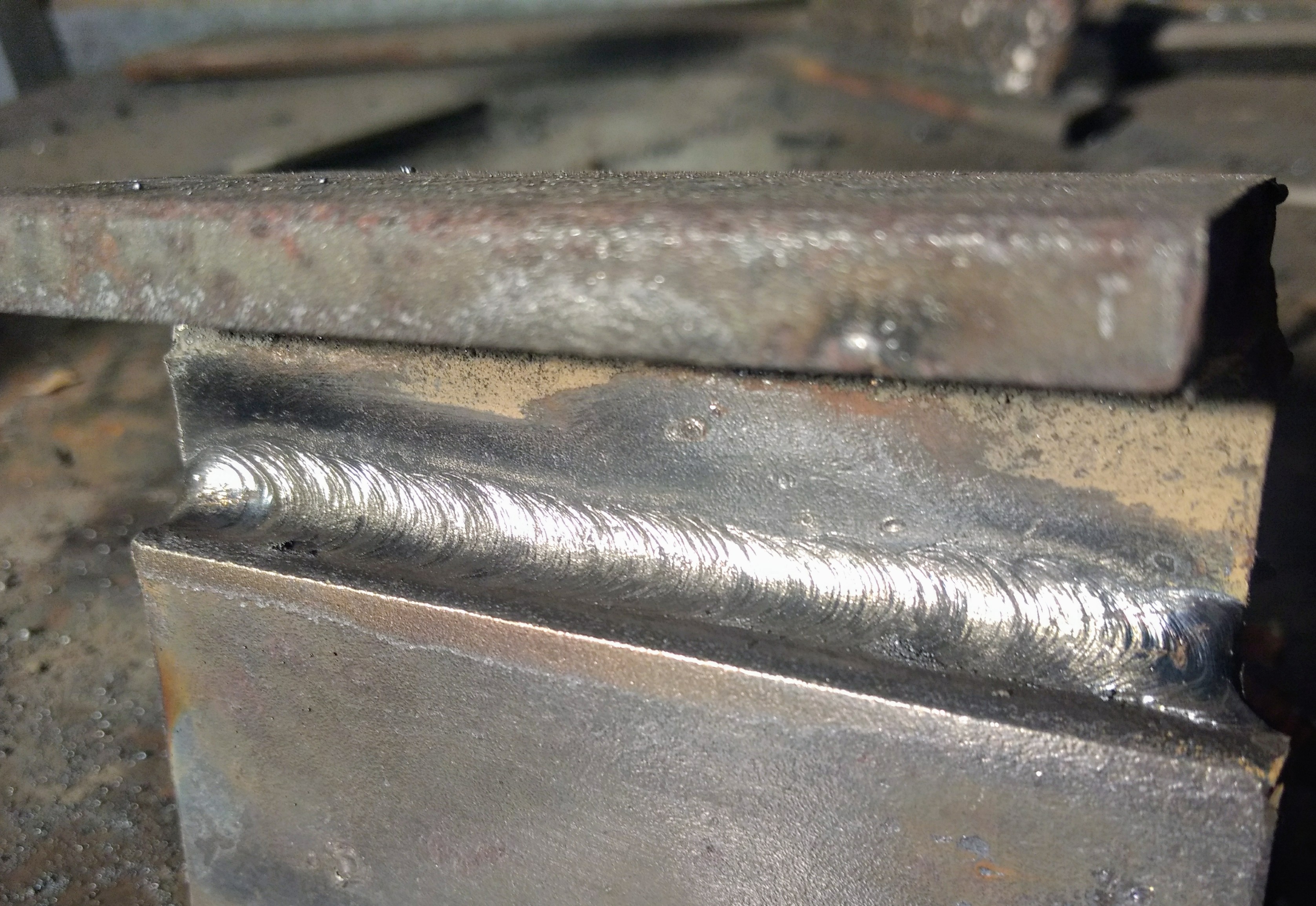

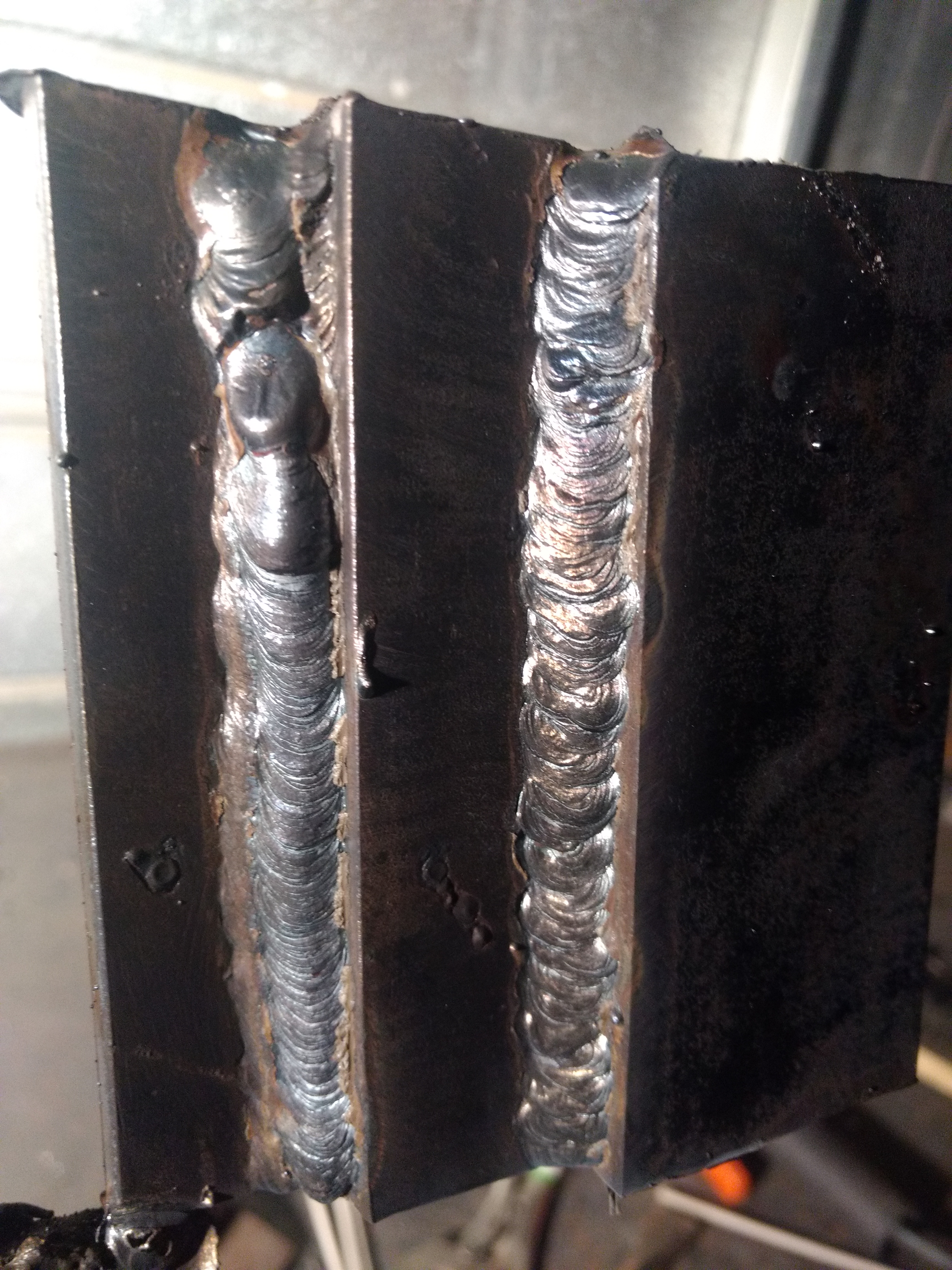

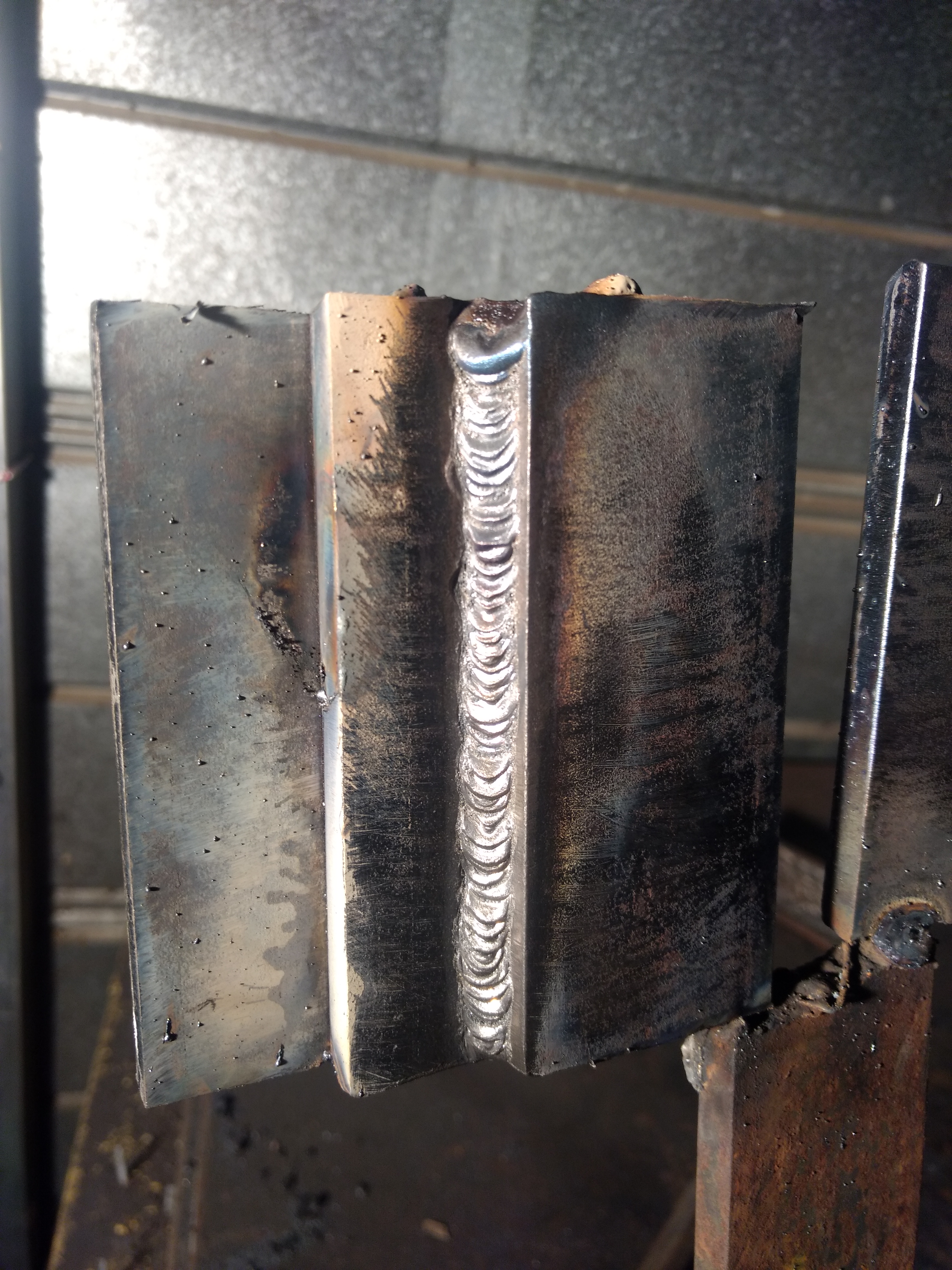

I'm done for the night and may be a bit before I get to practice some more. But all of these were ran vertical up. Used the 6011 at 65 amps for a root pass on everything and 3/32 Lincoln jet rod 7018 at 60 amps for a second pass in a weave over the 6011 on T & lap joints. That one weave with the blobs was my first attempt at a weave and I got stuck at the top and it showed! The rest are not great but I was definitely Happy for them to even come out like that.
What can I do to get the weld to flow better/smoother bead?
Edit* on the lap joint picture with the blobs I ran a few stringer beads practicing and when I ran out of a rod I decided to finish that one weld doing a weave and got the blobs.

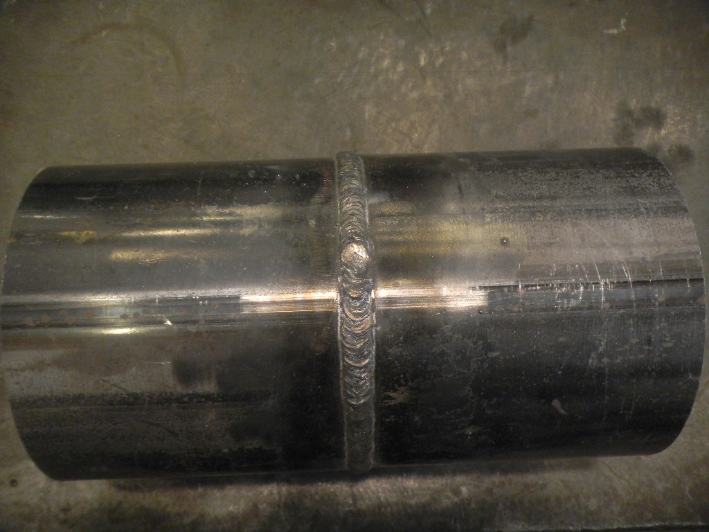

Just something for you to try, to see if you like it. When doing fillet welds, or V-groove welds with 6010, or 6011. Run a U pattern. At the bottom of the U close up the arc length, so it fills in better.
I used a U pattern on this pipe weld.
When running vertical up hill with 7018. I watch about 3/8 to 1/2-inch below the melting puddle. To see how it lays. If I don't like the way the metal lays I change the rod angle, up or down to see if the metal will lay better. Now remember when you get to the top of the plate, the puddle is a lot hotter / flowing, than at the bottom of the plate. So most likely you will have to point the rod up more to control the puddle.
Do you slow down also like a slight pause at the bottom of the U? Or just close up the gap as you get in the bottom then start to lengthen it away from the plate as you go back up at one fluid speed?
I tried the inverted T I think is what it's called. Where I go up, come back half way and wiggle side to side with a slight pause each side letting the puddle flow in. It definitely laid more metal in but I was inconsistent and felt like I could fall out of practice with it pretty easy.
   / New to welding #220
At the legs of the U I have a longer arc length. This helps cut out any wagon tracks on the weld underneath.
At the bottom of the U I close up the arc length to fill in better. I try very hard to keep moving, never pause!
