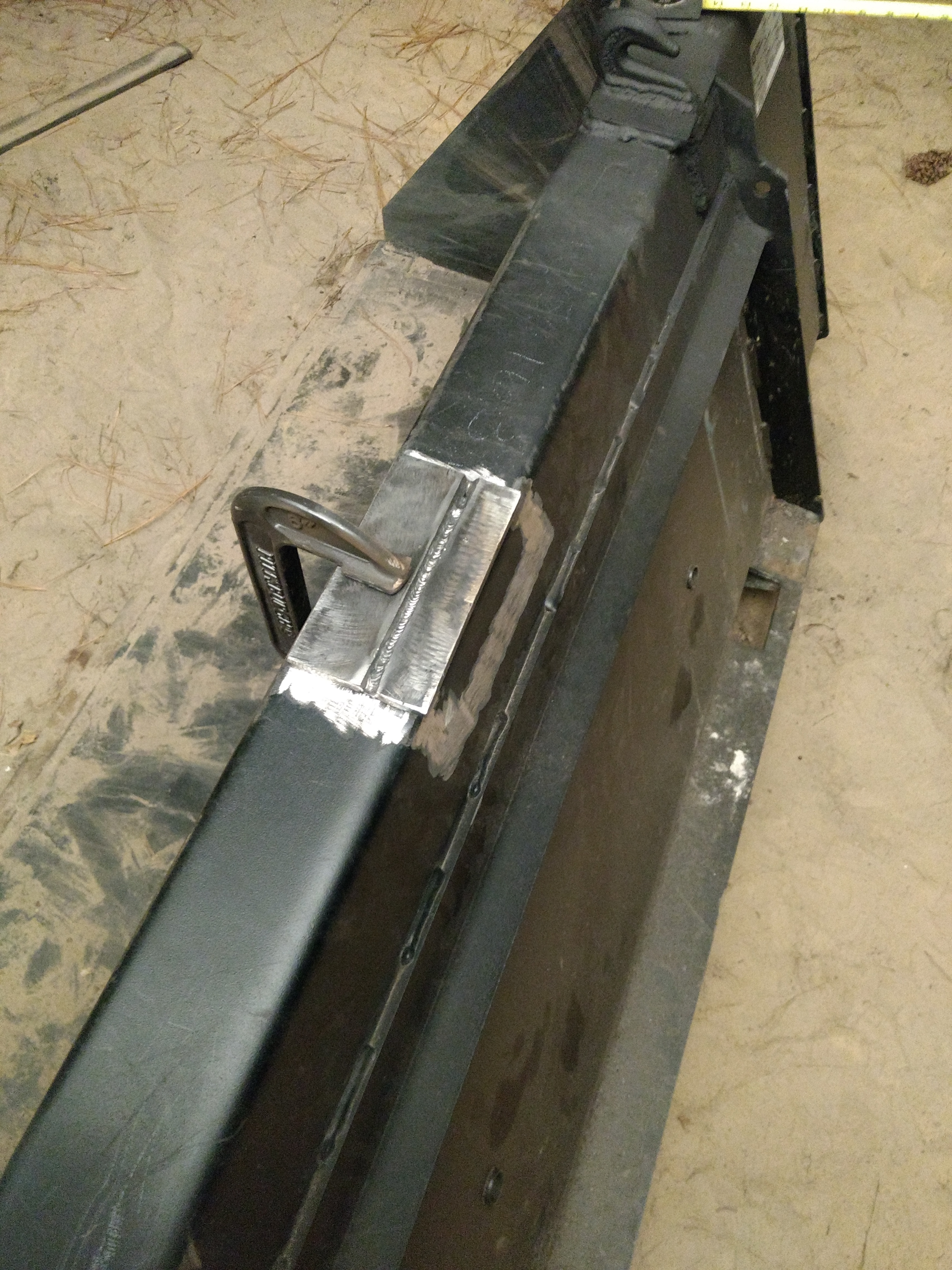

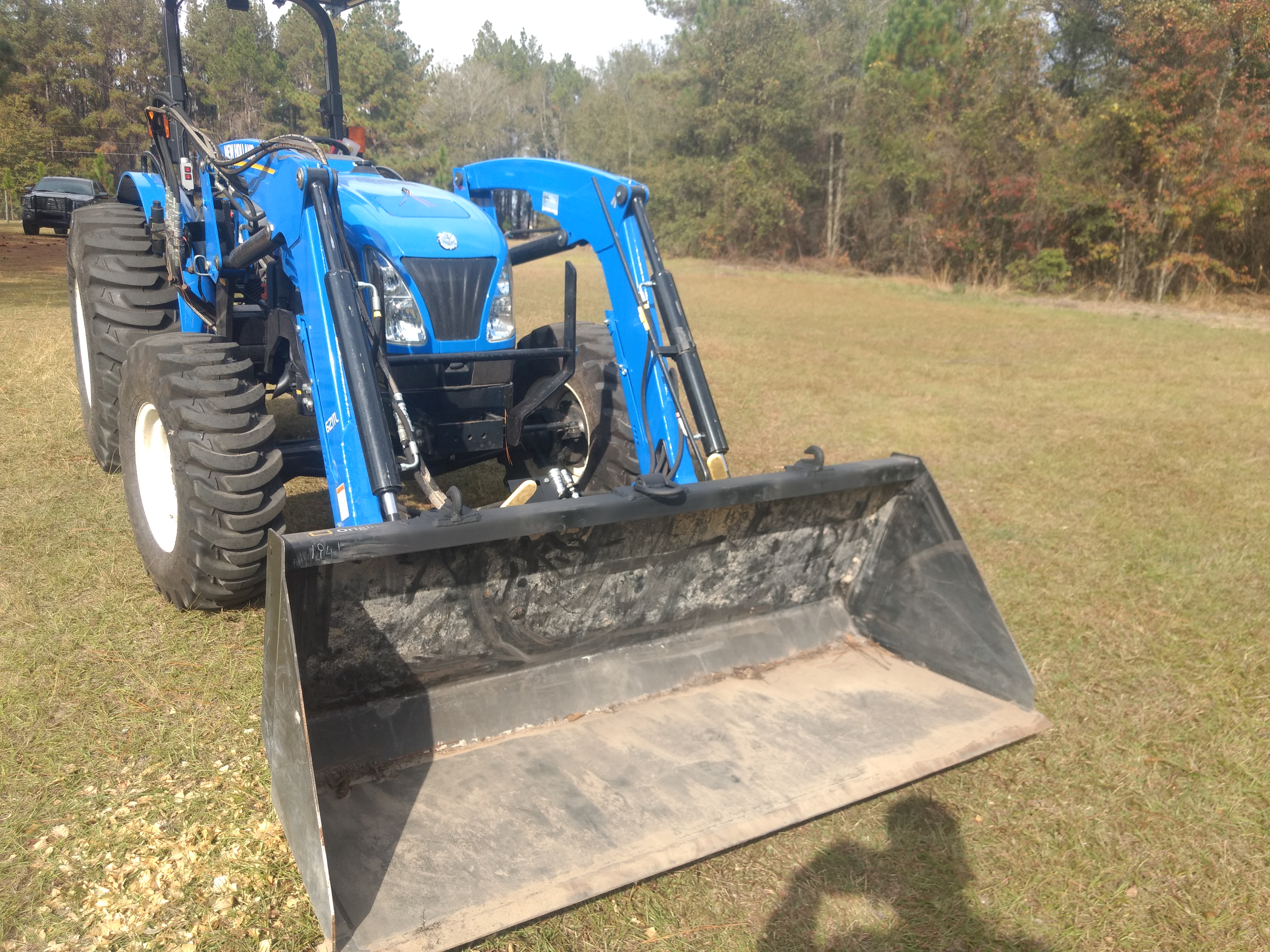

New addition, welded some hooks & a D Ring to my bucket. I used 3/8" flat stock as a base plate, cut two pieces, welded together, & added a back strap for extra support. Used 6011 for a root pass in everything then a fill/cap & multi pass with 7018.
Next project eventually is building a brush guard on the tractor.

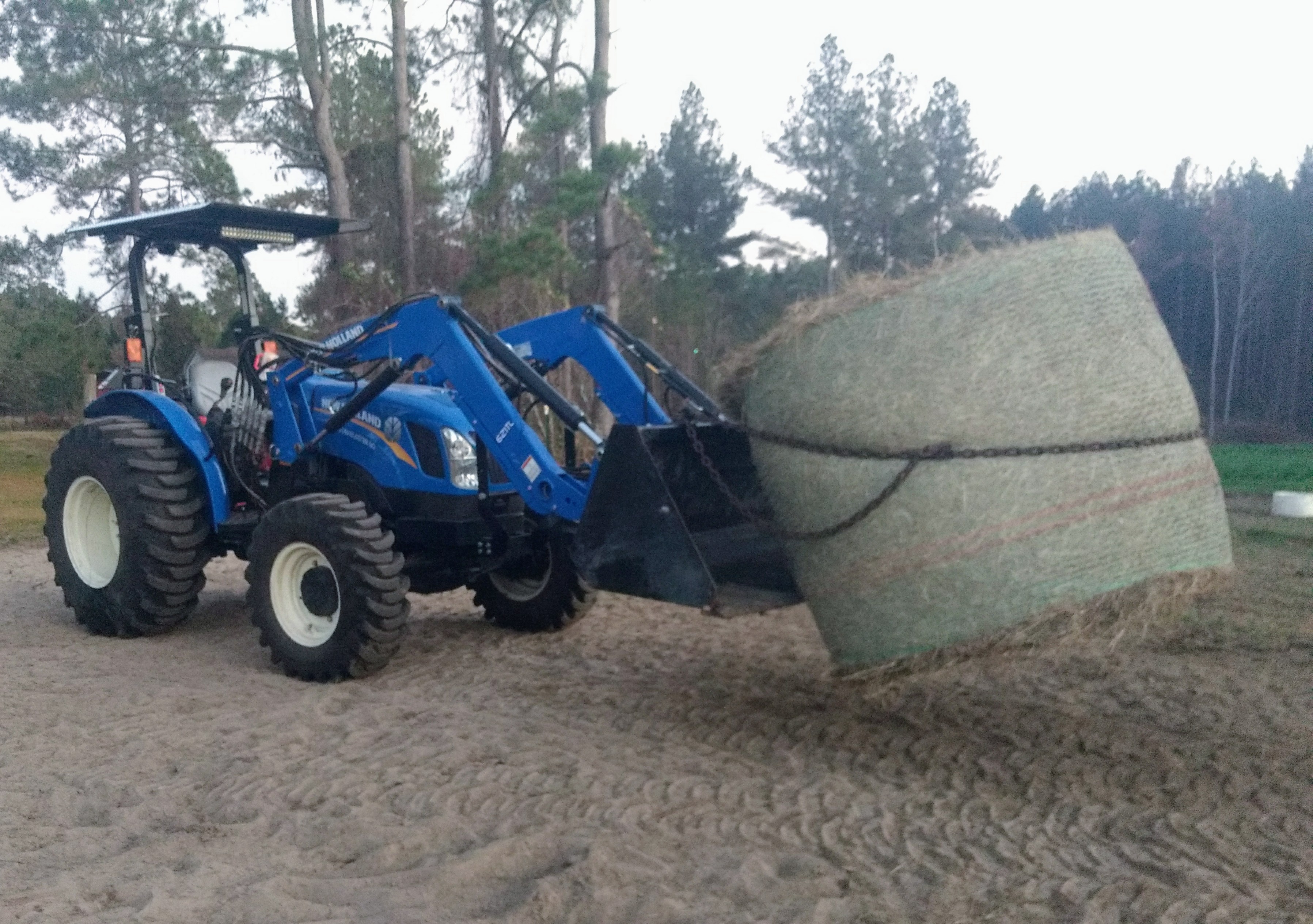

#194
Tested my welds strength a little. Was cleaning under the barn with the bucket and instead of putting on the hay spear figured I would just wrap a chain to the hook and carry this out to the horses. Not the hardest test, but it held.

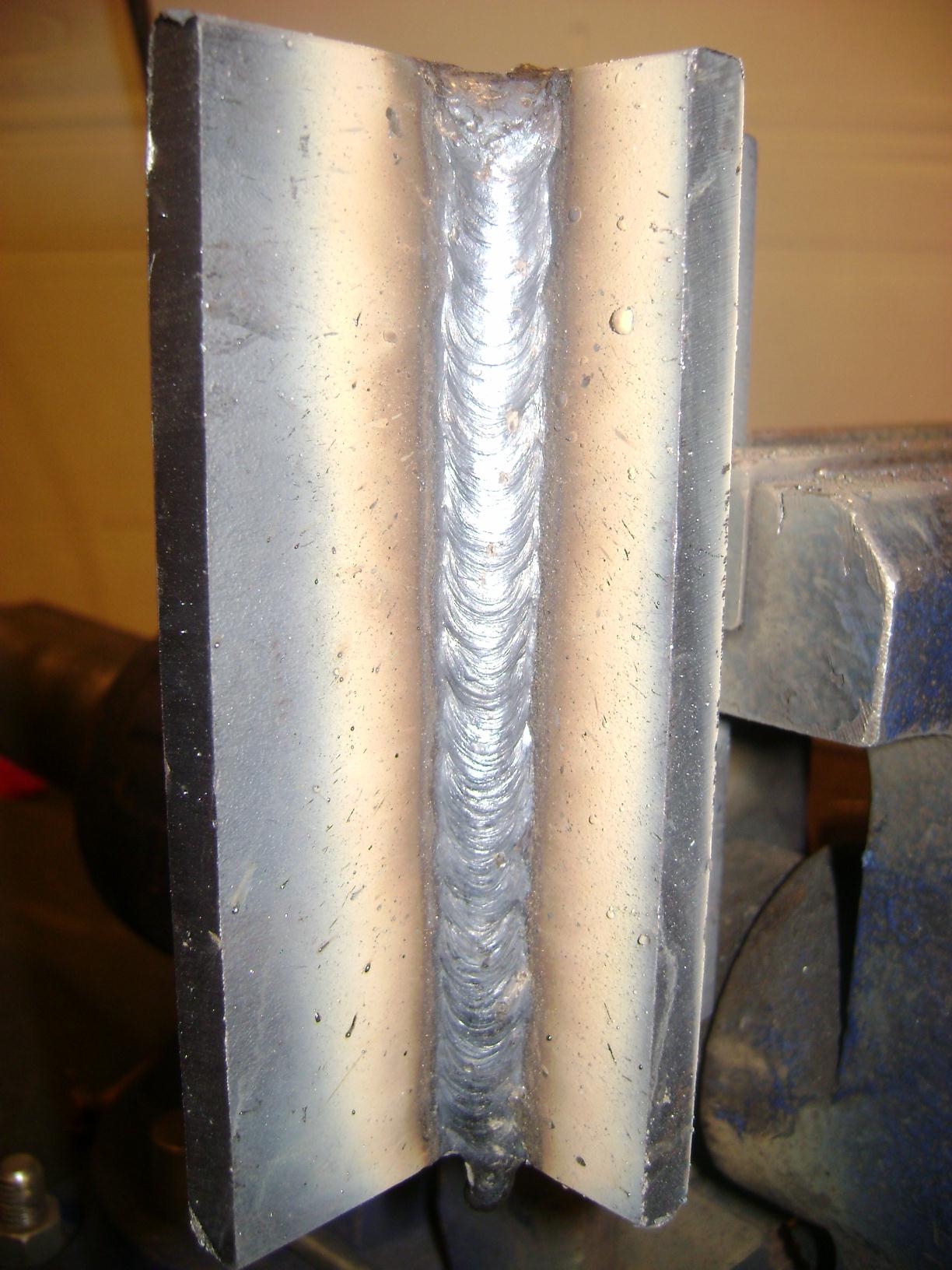

Here is a vertical up hill weld I made with 7018.

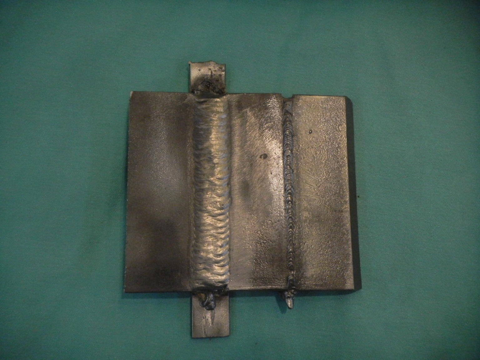

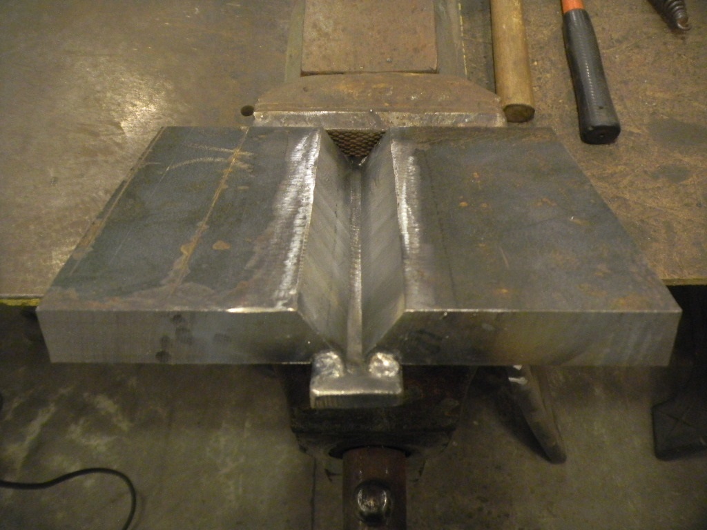

Question, can I run stringers vertical and make multi pass beads that way until I get good enough to weave? Or is it best to do a single stringer & learn to do a weave over that?
When I was in welding school. We had to pad weld in all positions. Flat, horizontal, vertical up hill, and over head. Personally, I wouldn't spend a lot of time on pad welds. Fillet welds like I posted, and lap welds, are more real life welding. Not very often do you pad weld a flat plate in real world welding.
When you do fillet welds, you can do 3-pass welds, 6-pass welds. Really there is no limit to how many welds you can make.
V-butt plates are very good practice too. If you have a way to put a 30 to 37 1/2 degree bevel on the plates. You can run stringers to fill the V-butt, and a weave pass for the cap.
