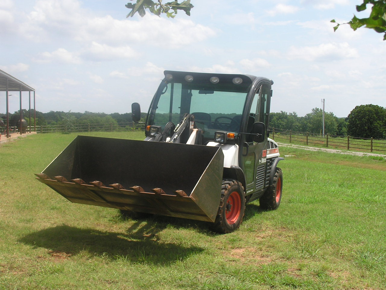

Here is the F Series we had with the 6 foot wide, 1 cubic yard toothed Versahandler bucket that weighs 818 pounds:
In the clay:
Easily lifted twice the 1500 pound lift rating (ROC).
