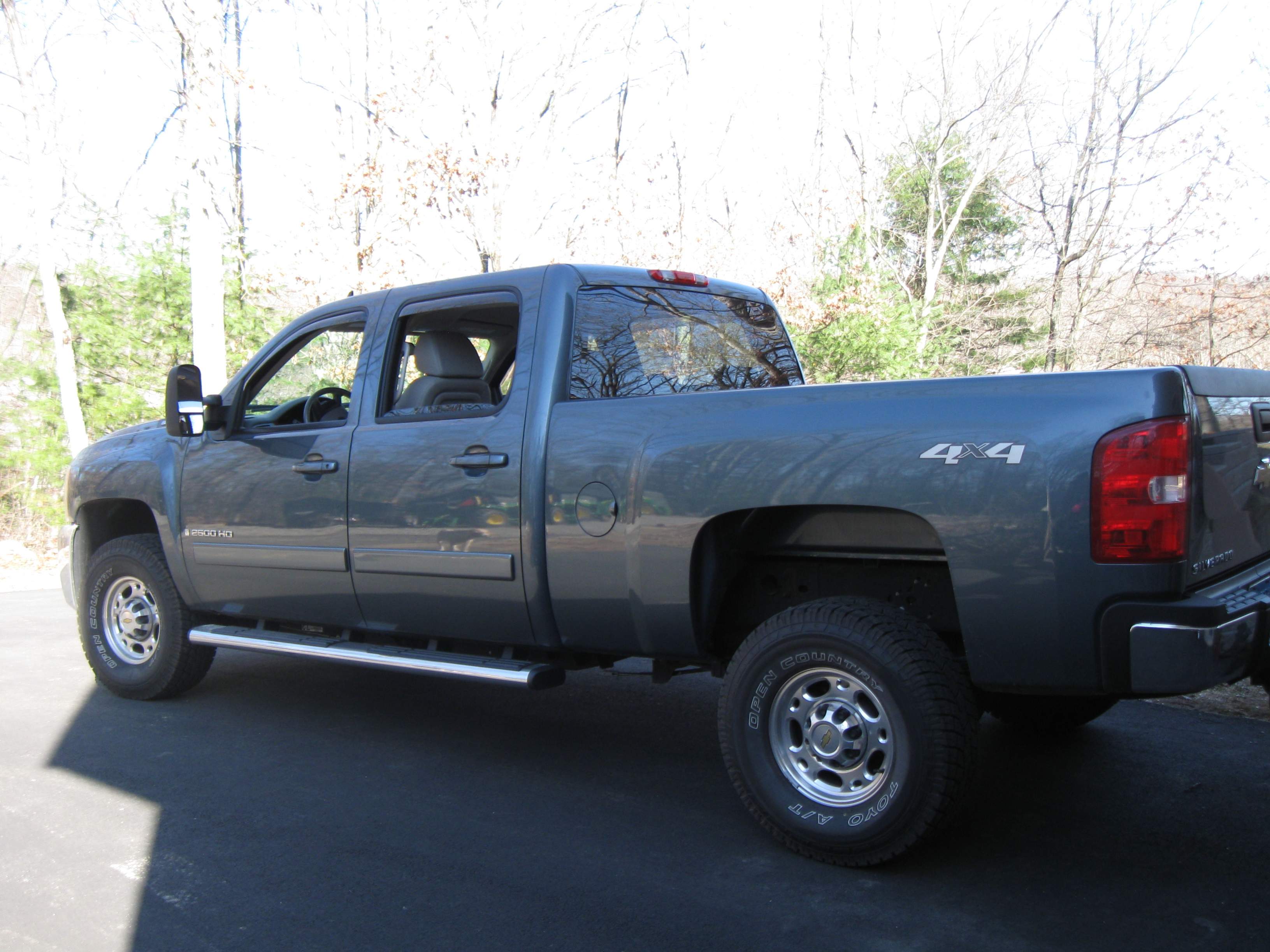

Here's a belated pic.

Great lookin' rig! :thumbsup: Same kind as one of mine... Not the PS -- that's now bleeding fuel/oil on my garage floor from a "wounded turbo"! Who built that rig anyway....?? :(
