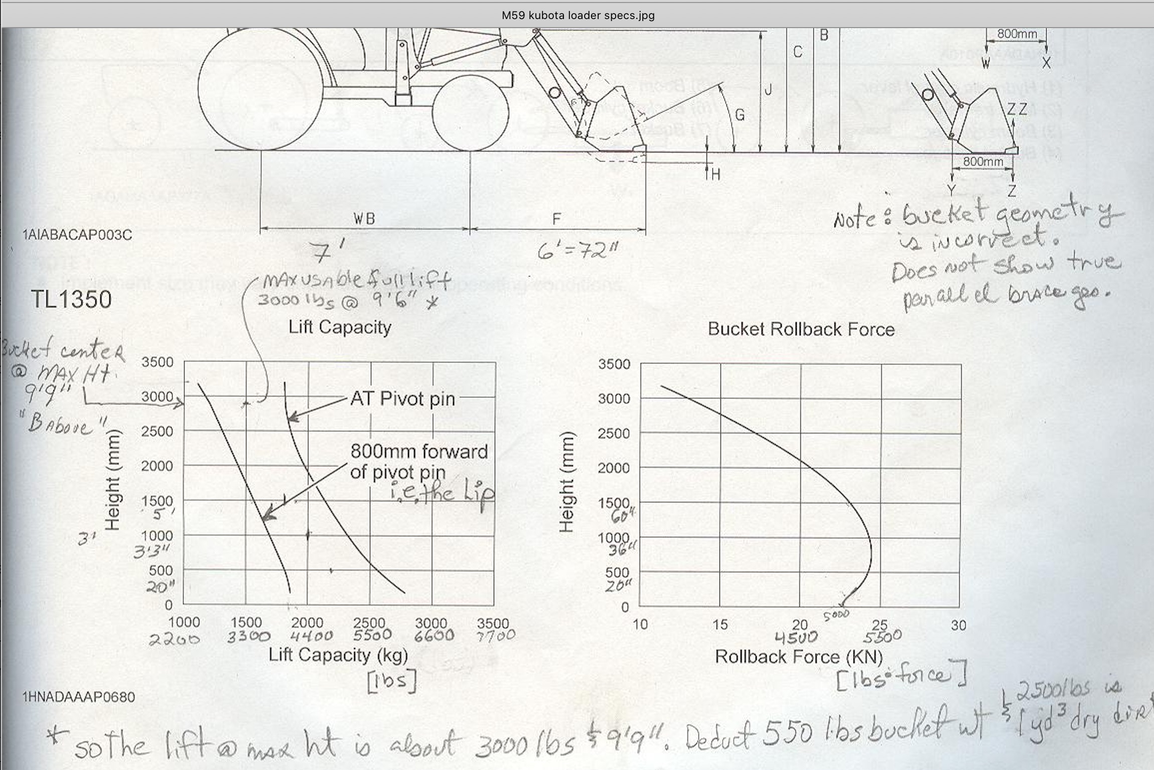

Loader wise the height it can lift may be a factor.
   / New tractor advice - 11 acres long driveway, Kubota/LS/Mahindra #36
You are so right... The geometry changes throughout the lift, so the forces do to. Here's some notes I made one day when lifting some 3000 lb concrete culvert and placing them with the M59. I'm not usually so messy with my notes - this was done in the field - but at least it gives an idea of the lift versus height. Basically you can see that the tractor will lift two tons up a foot or two, but only one ton to max height.
If lift capacity is important, a graph is a good place to start with lift versus height.... and then put on your fact checking hat to figure out what their sales specs aren't saying.... This M59 graph is pretty good. Far better than most add-on FELs.
Obviously all the FEL manufacturers have this info available. They couldn't design for stresses without it.
rScotty
