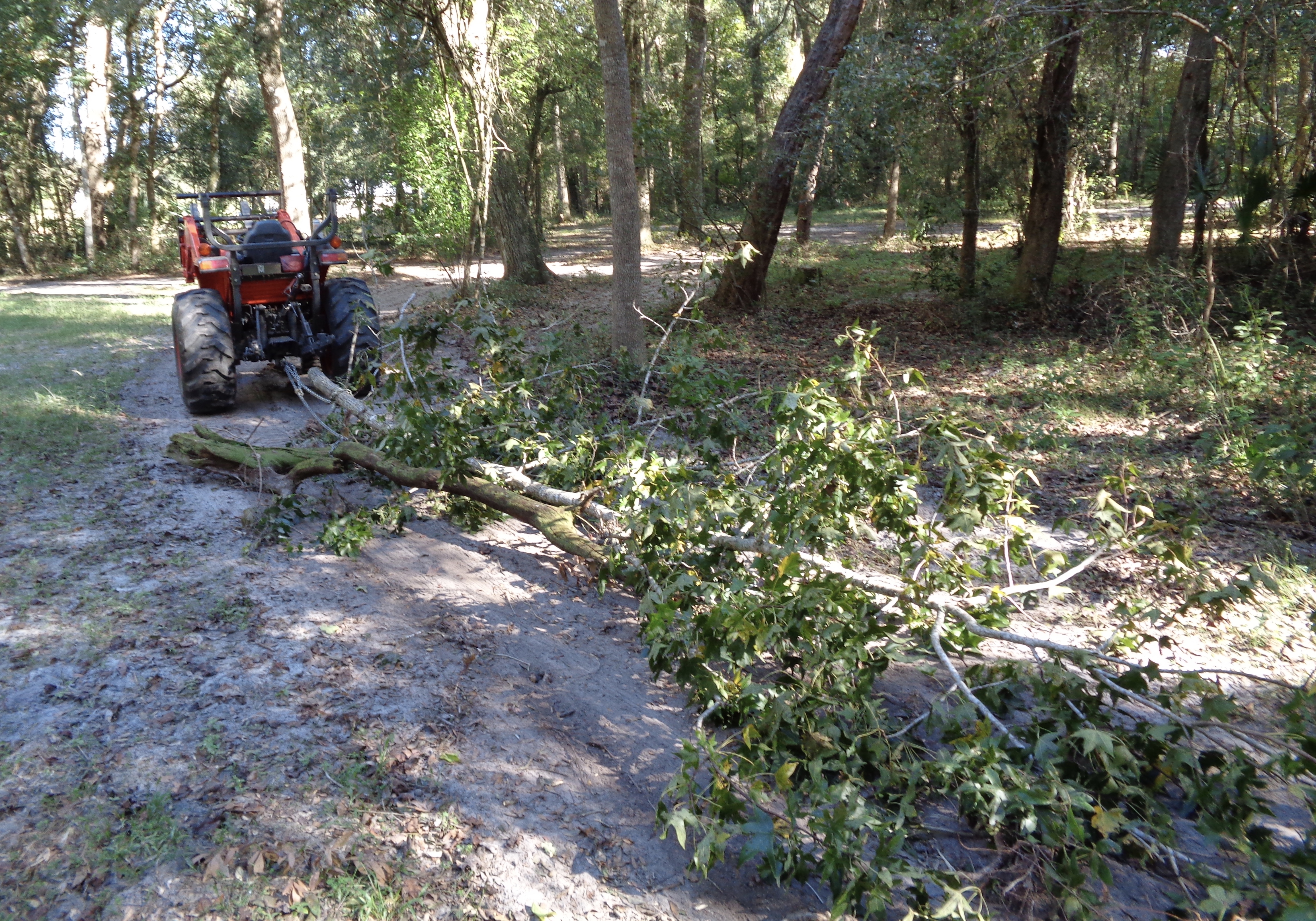

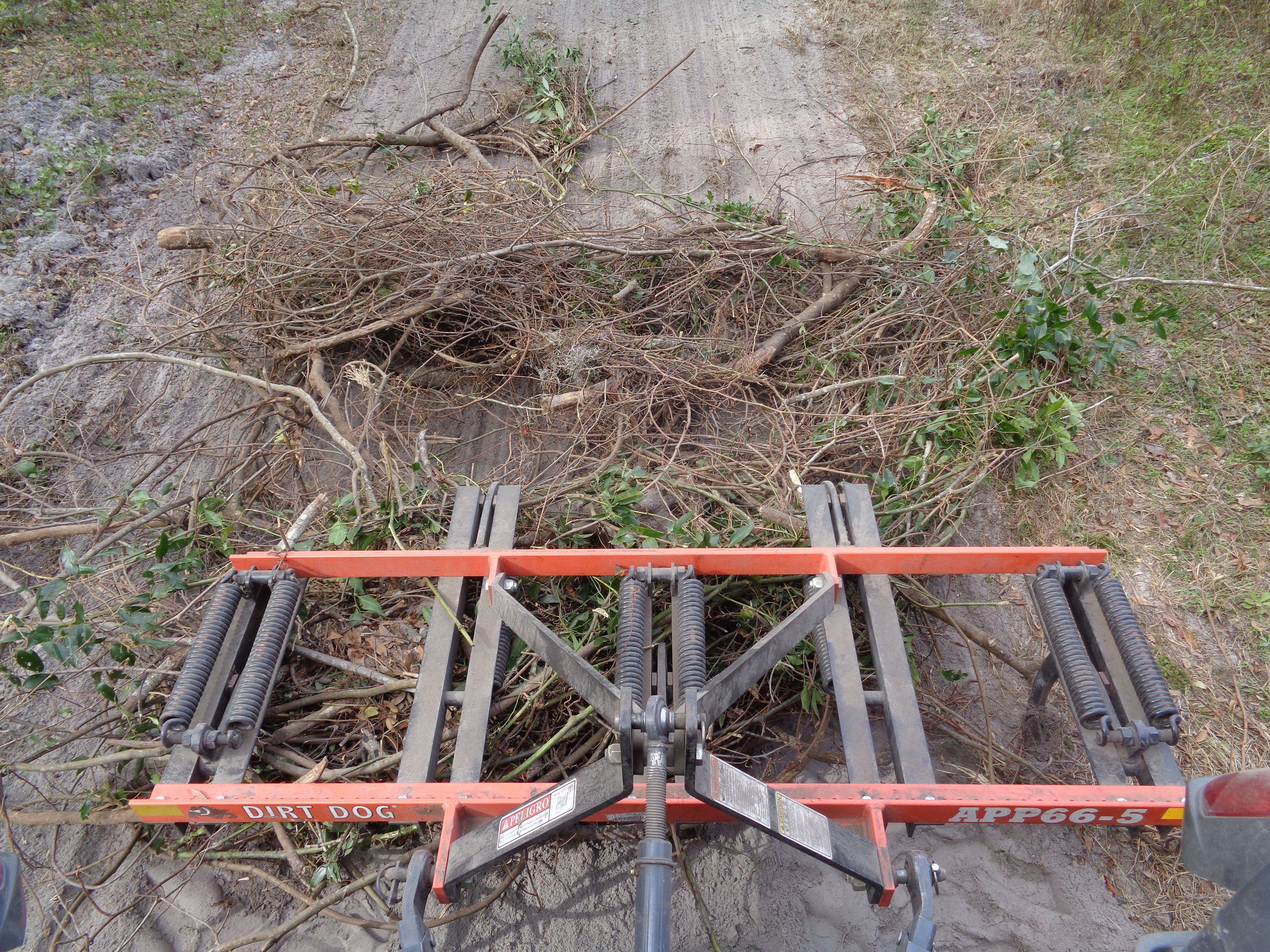

Thx. My interest in a grapple is the ability to root up the typical bushes up here as well as lift and move larger tree parts. I considered a bush hog or a skid cutter but a friend cleared most of his similar property with a grapple. If others think the other attachments are a better option I am willing to reconsider the grapple requirement. Really am a newbie here! Especially on which attachments are best for each application.
With the light tractors you are considering, you may be disappointed in grapple capacity.
Consider a Ratchet Rake bucket attachment for tearing out brush and consolidating debris into piles. Ratchet Rake is a force multiplier mounted on small tractor buckets. Easy to store when not attached to the bucket.
If you want to tear out roots 10" deep, consider a three shank Field Cultivator/All Purpose Plow. Field Cultivator will also pull debris to a burn pile. Heavy work should be accomplished from the Three Point Hitch. Tractors are designed to PULL.
You can tow tree trunks from the rear of the tractor using chains. Tractors are designed to PULL.
