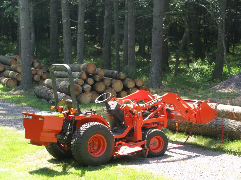

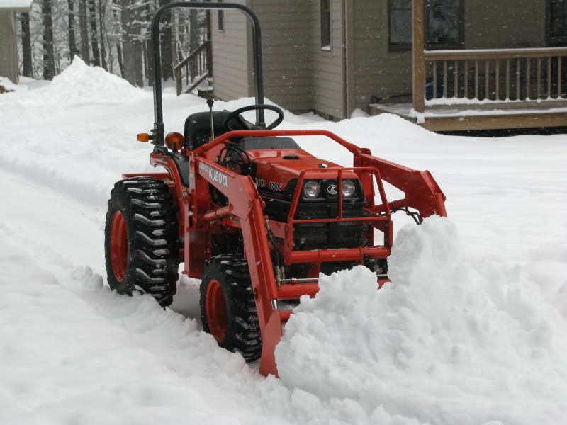

Congratulations on your new toy... oops I mean "tool". :D You'll be surprised just how much that B2601 will do. My first Kubota, a B7500, was a similar size machine only with 21 hp, 2 range hst, and LA302 loader (the number on Kubota's loader roughly correlates with its lift capacity in KG) so your 435 will be markedly stronger. I didn't have a hoe for it but that tractor did most everything I needed done on my property, it was my mower, moved a small forest of 12' logs, cleared snow, spread gravel with the rear blade, etc. The only reason I moved to a small L was I acquired a fair amount more property, otherwise I'd still have that tractor.
