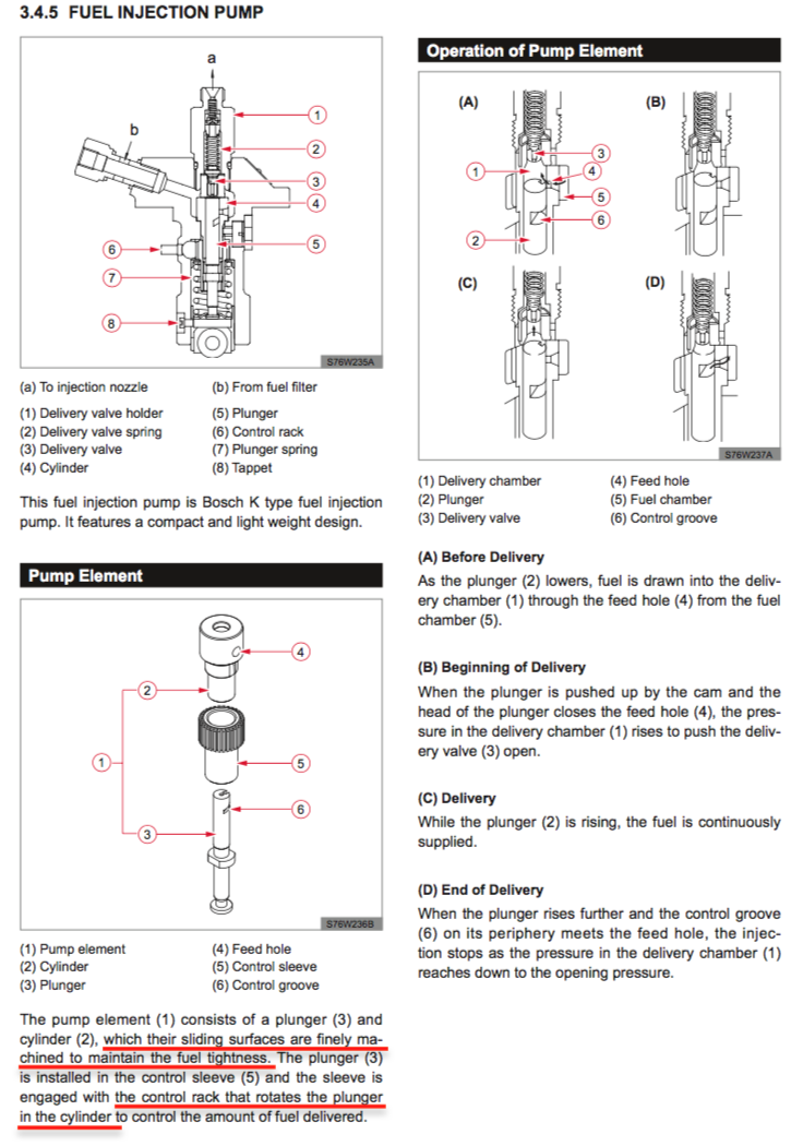

Doubt the fuel pump parts ever actually rub against each other.
Ralph
I just wanted to provide some information here, just so it's clear that there are indeed components within the fuel pump that rub against each other.
