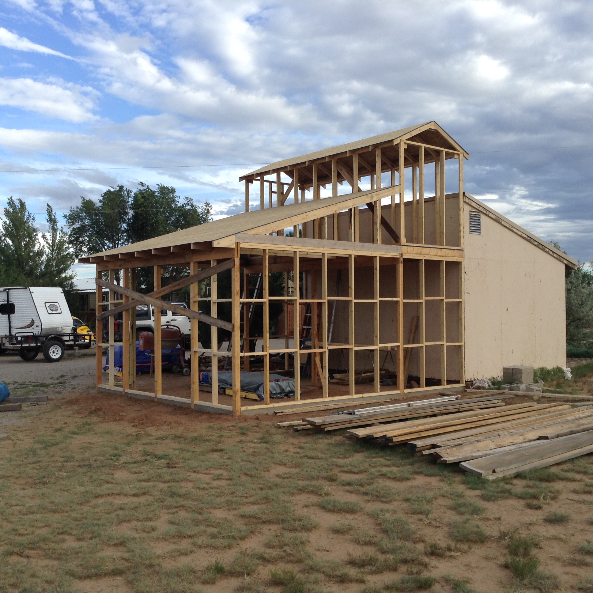

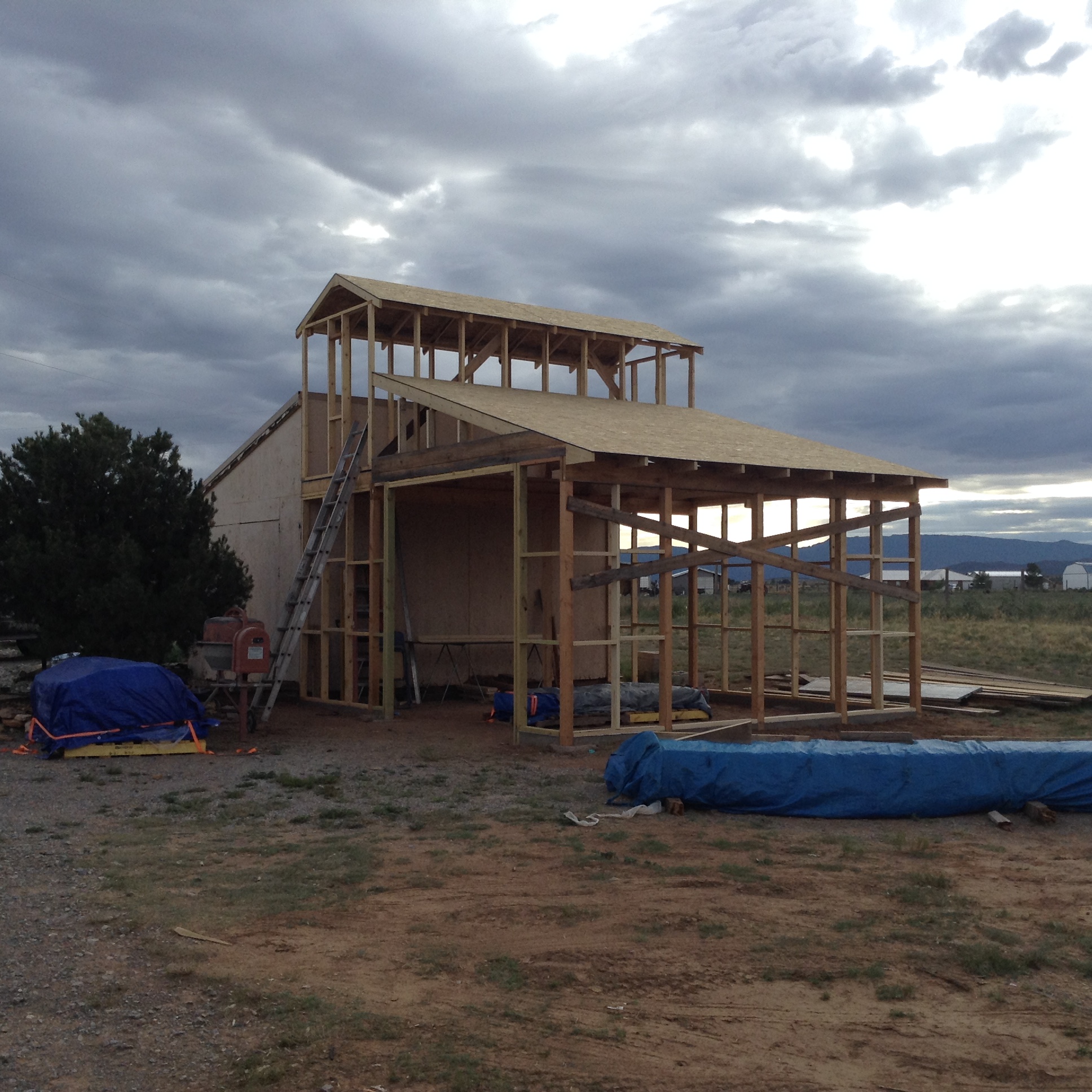

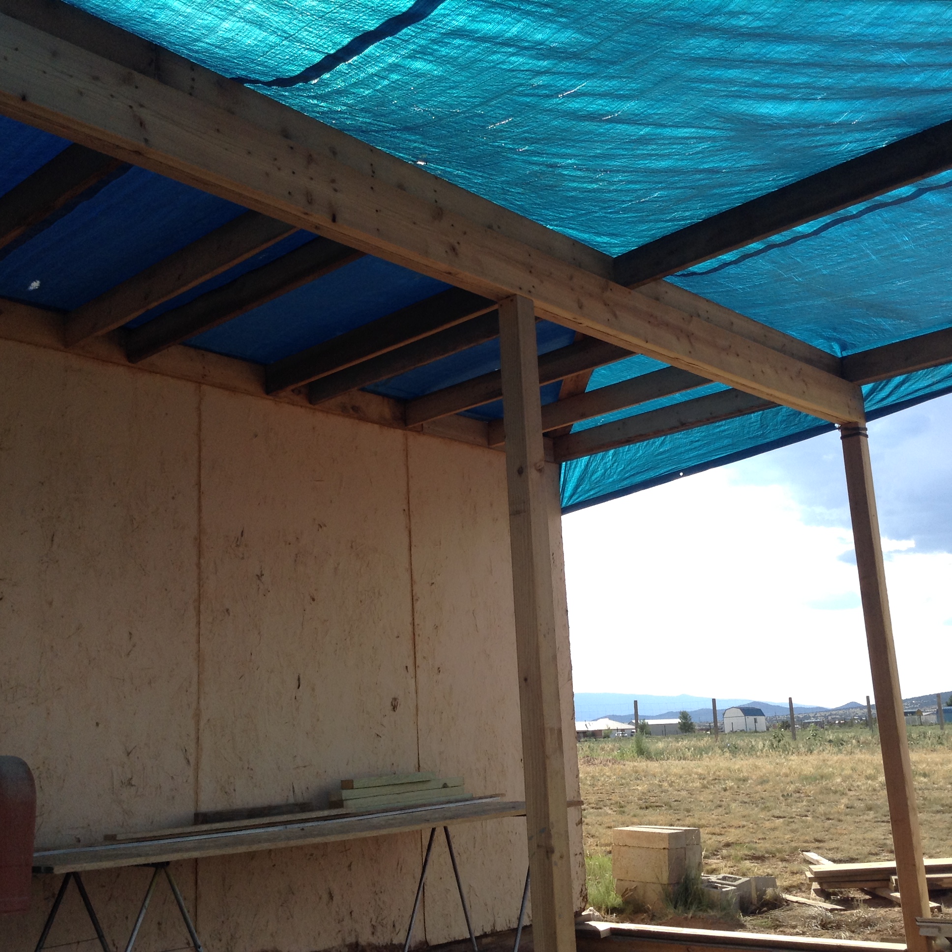

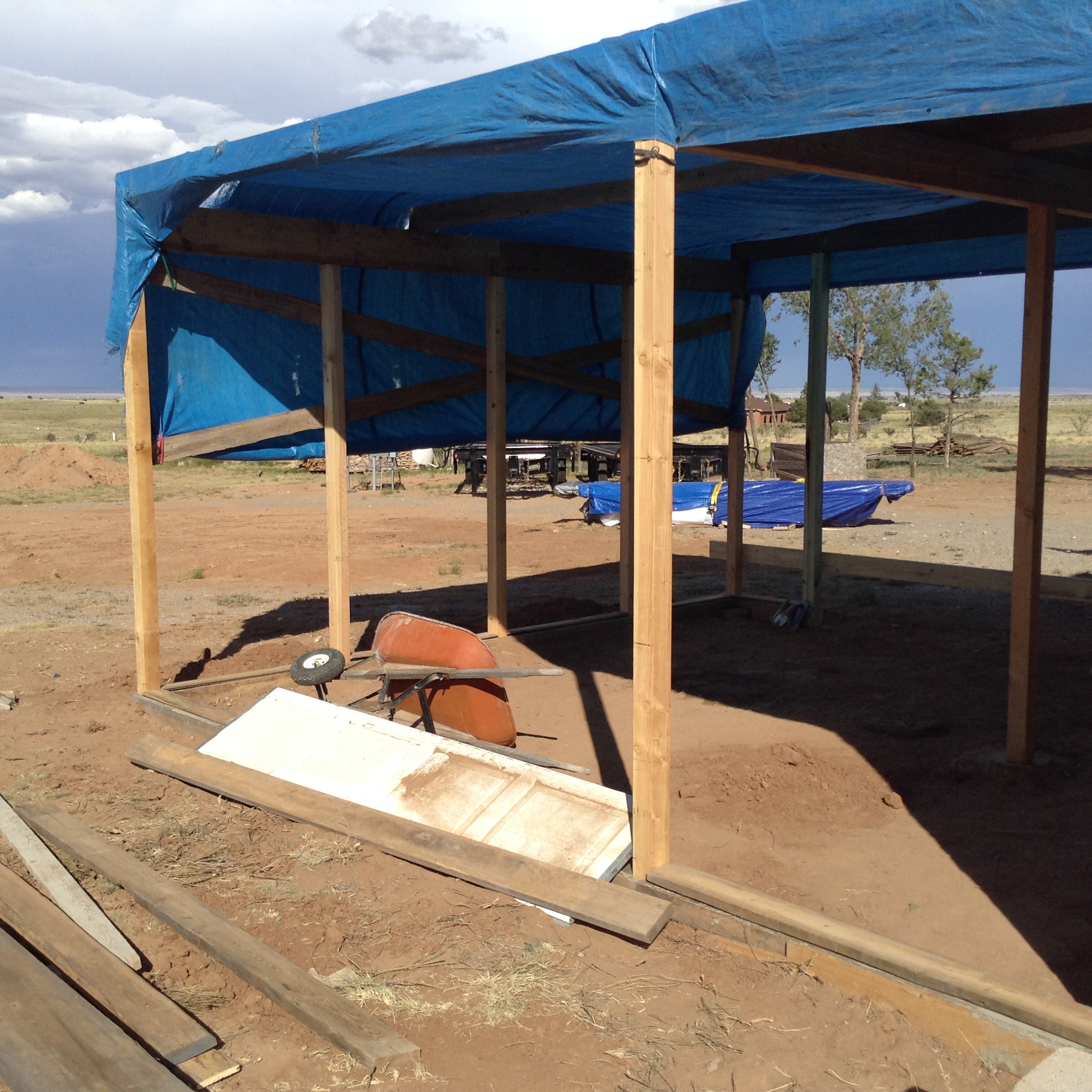

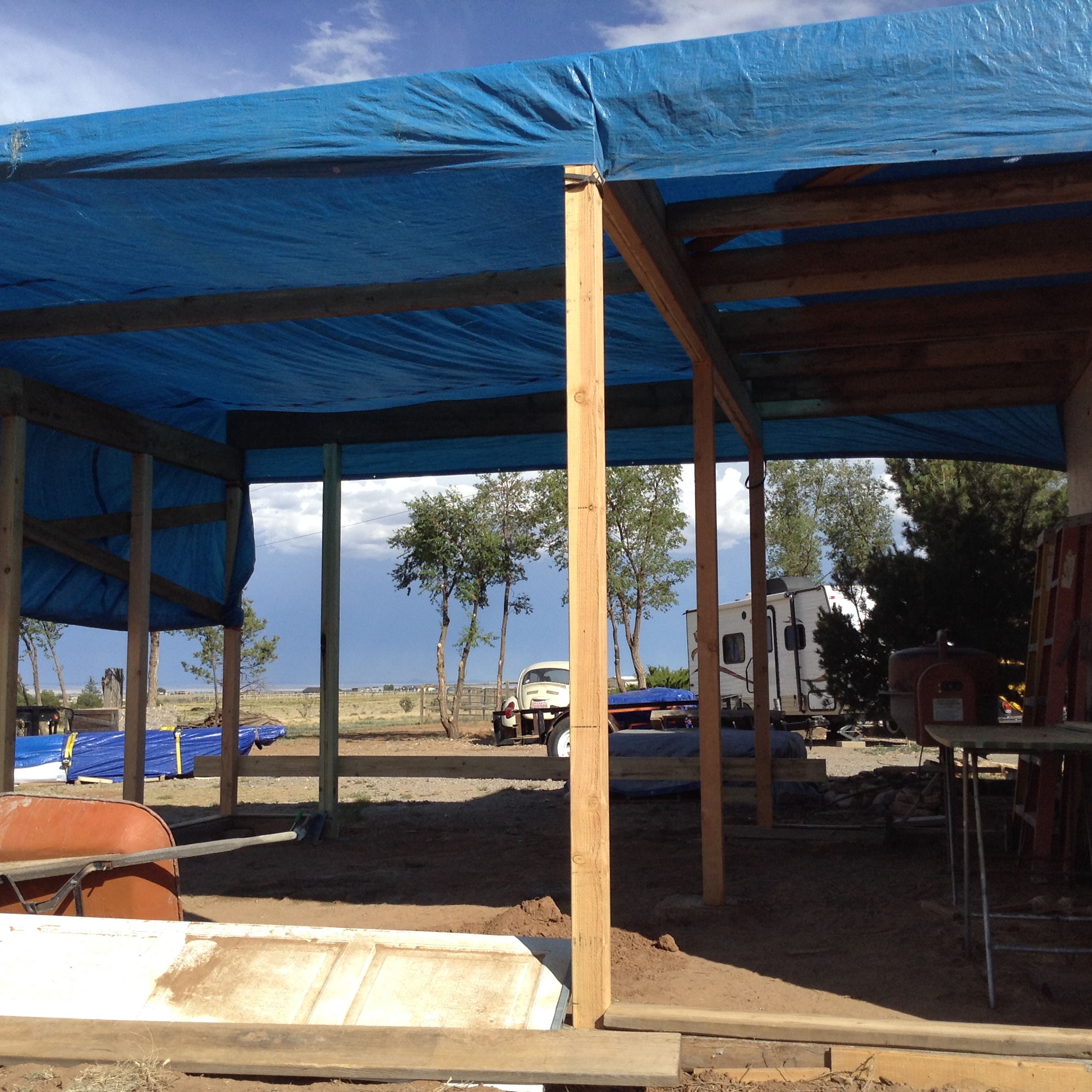

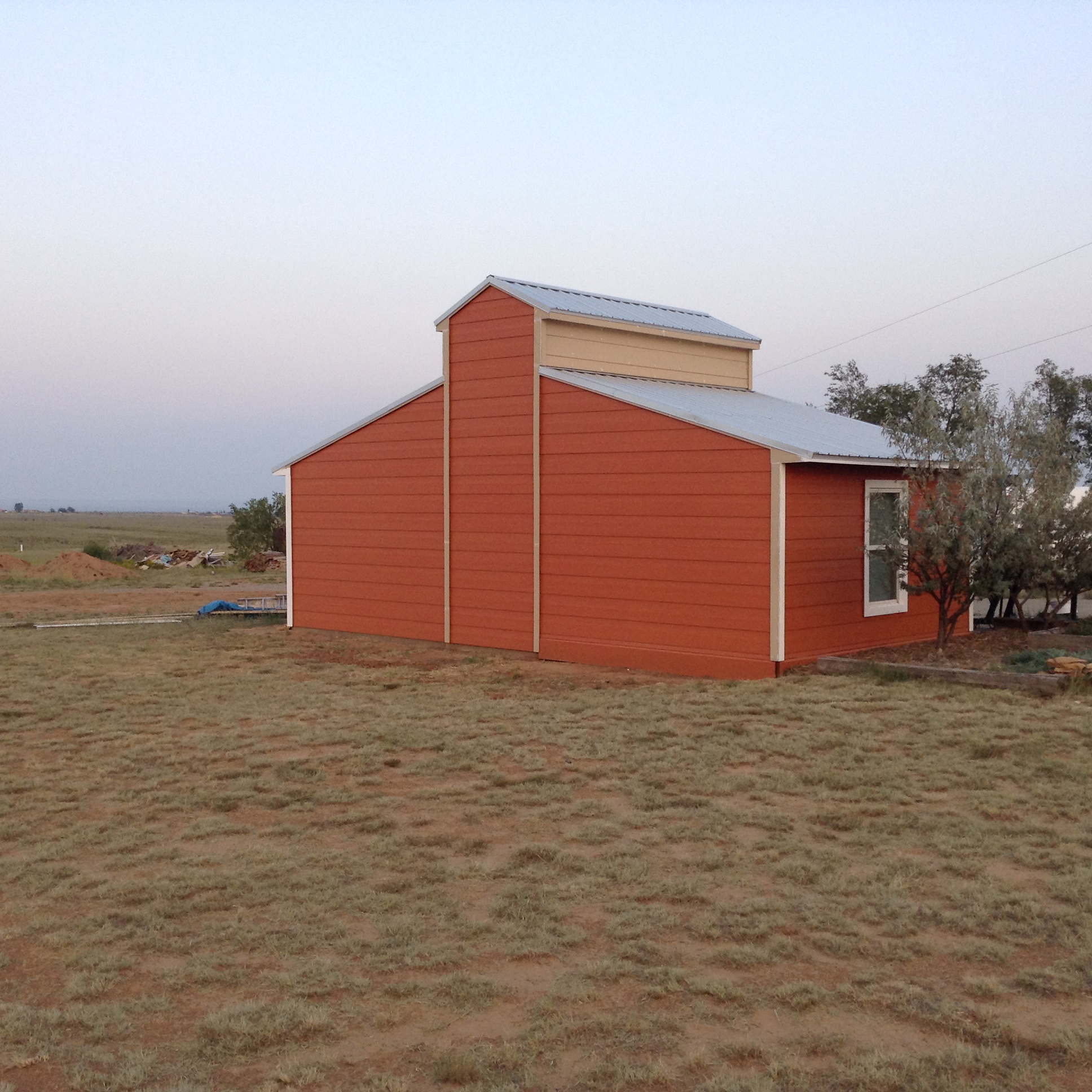

Started building a new "tractor house" as an addition to our shed. Area for tractor will be 12x20, area of 6x20 for work bench / tools. Above the 6x20 will be a storage area also 6x20x78" high. Got all the posts and beams in place, perimeter footer, and framing for 8x8 garage door. Have to go back on duty tommorow for 3 days, (so I can take a break... Forgot how much work it is to frame.... Maybe I'm just getting too old) I won't get a chance to get back on it until Sunday. The tarp was a necessity to get out of the sun... Sure was strong at 7200 ft elevation and 97 degrees for the past 3 days! image.jpegimage.jpegimage.jpeg

:thumbsup:...more room the better in years to come for those attachments. ;)
Pace yourself.

Here are a couple more pics of the garage build, made a little progress. Got $1700 worth of cedar siding today. Metal roofing coming tomorrow.

It's gonna have a nice look to it. I'm a big fan of that style of barn!!

How much concrete did you have to mix and pour?
For the footers and stem wall was 85--- 80# bags. Done over 2 days. Lot of work. The slab will be 3.5 yards, but I'm gonna do redi-mix.

The temporary tarp certainly was a helpful idea for protection from the blazing sun.
If you need to do something like that again, it might be worthwhile to search for a silver tarp, rather than blue.
The silver color will reflect heat, while the blue absorbs it.

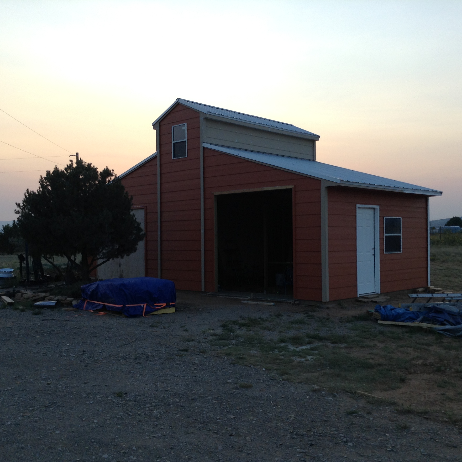

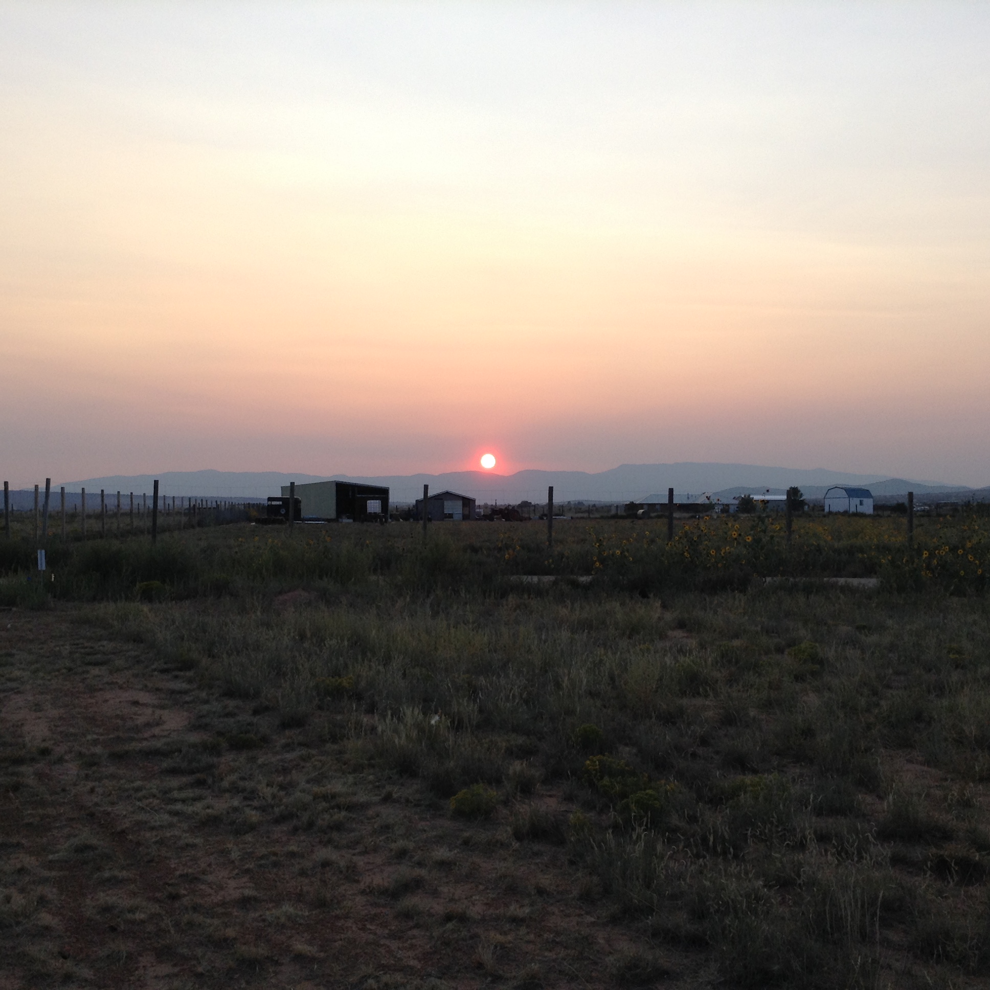

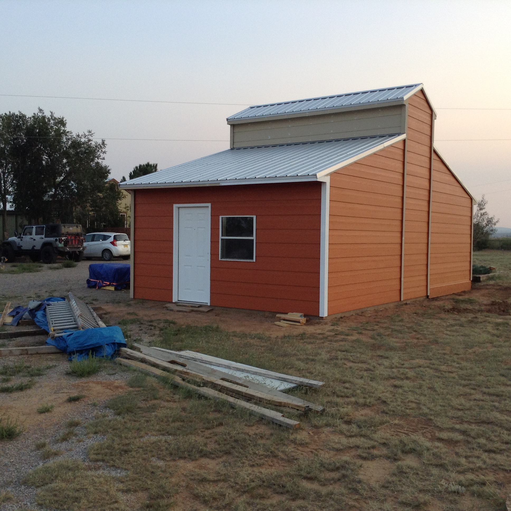

Well it's been over a month of bustin hump on the days off from work, but the new shed / shop is almost complete on the outside. I have a bit more painting to do and install the garage doors. Then I get to work on the wiring and interior finishes. Here are a few updated pictures. One is of the sun setting over the mountain, pretty nice because of all the smoke haze coming from the wildfires up in the NW.

Nice looking little building.

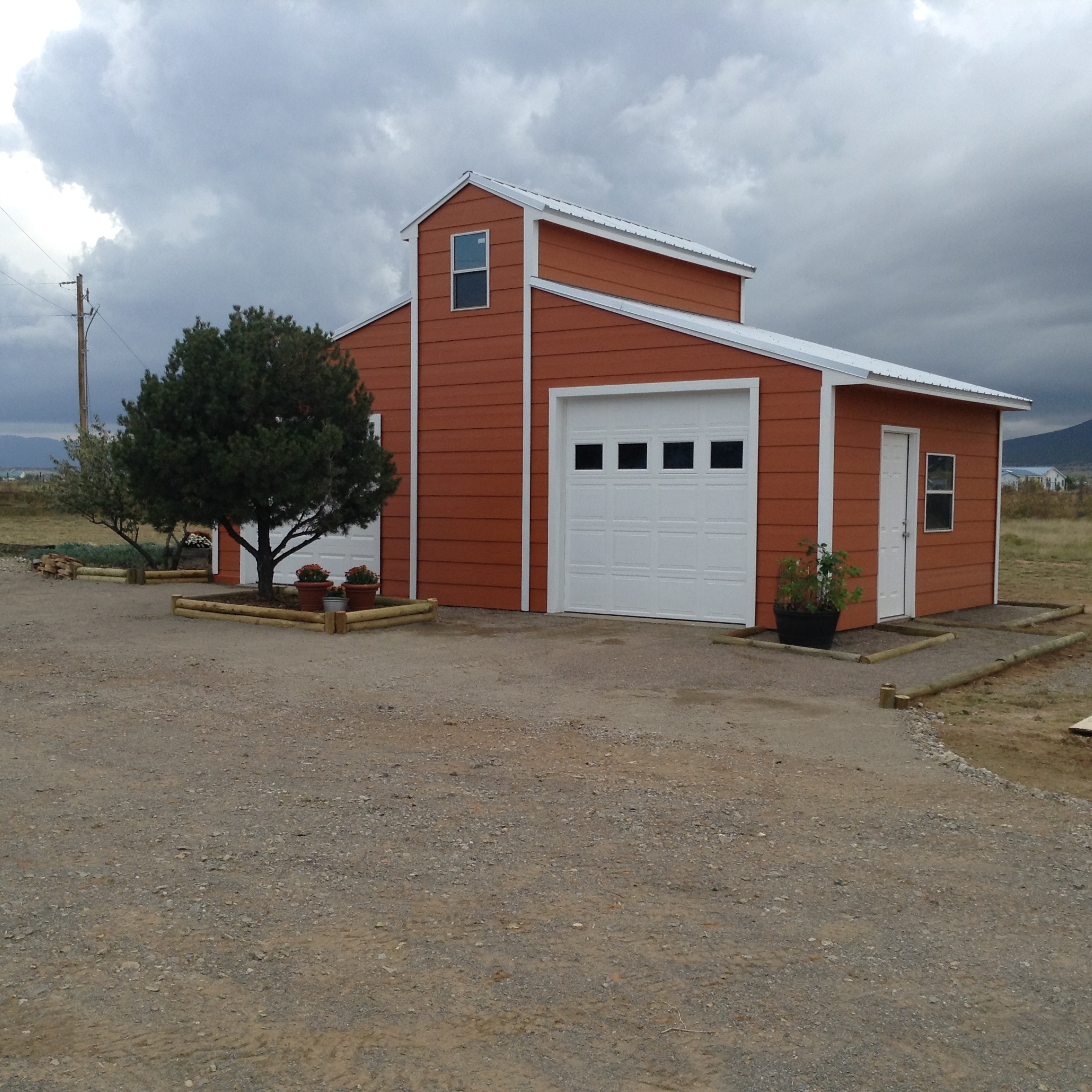

Very nice, your tractor will enjoy it's new home.:thumbsup:

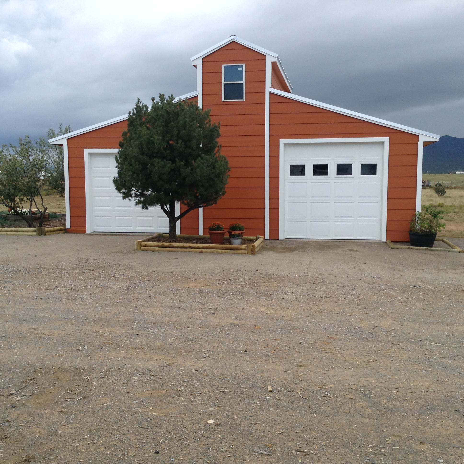

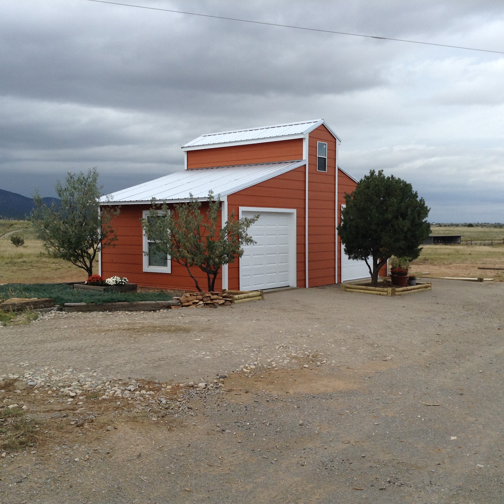

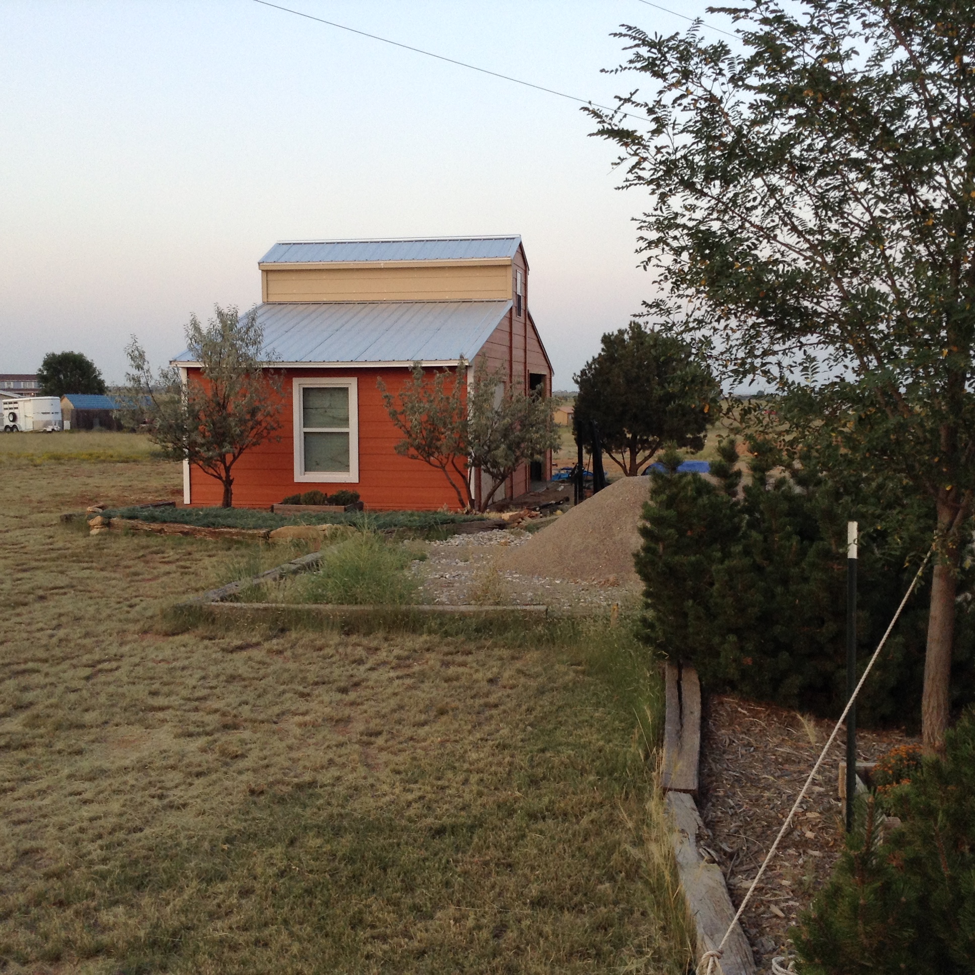

Finally finished the exterior and sealed it all up. Did the final grade and entrance gravel. Incorporated some of the existing landscape w/ some new timbers. Next up... The arduous task of organizing all the tools and building the workbenches. The upper 4' of the interior walls will have pegboard almost all the way around. I'll post pics of the inside when done.:dance1:

Nicely done on the landscaping. It looks like it's been there forever.
