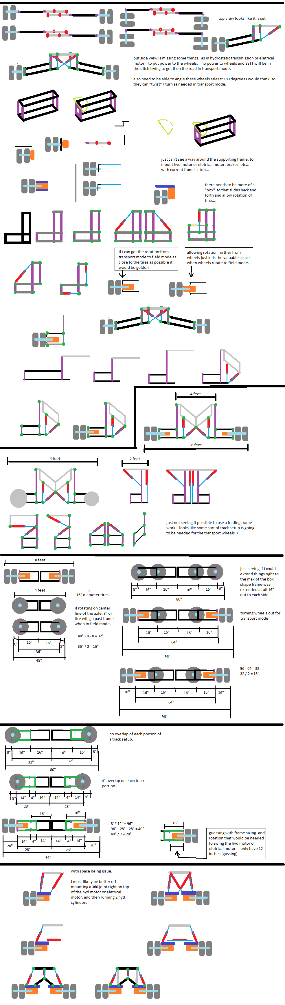

see post 280 (post directly before this one) for a large listing of all diagrams / chicken scratches up to this point.
GOALS / PRO's / CON's....
==overall. grown tired, of extremely large size tractors going down the road, and then implements behind them. that more or less take up almost 2 lanes of road. or rather almost 16 foot width. (a single lane is approx 8 feet wide
==ya tractor power and implements can keep going up in power and size. but at what point before roads are no longer big enough, to allow for tractors to go down the roads without fully locking down the entire road for a few miles just to get tractor and implements from farm to field and from field to field.
==logistics. it takes a small organized crew to trailer and drive various tractors and implements here to there, and then hook everything up. before one can start operating in the field.
==all these wheels these implements tend to get, are just wheels on bearings. by the time ya add things up ya get up to 20 to 30 plus wheels. and maybe at most 12 of them are powered.
==on the rainy yuky muddy years, there is only a handful of days you can get out in the field, without tearing it up, this is part to just mud, but also weight of everything, and traction.
==reducing compaction, both simply rolling / driving over the field, but also how the plows, chisels, fertilizer, seeders, drills, discs, etc... physically work the soil.
==get a working tractor implement combo. that can fit within a 8 feet width (width of a road), 60 feet long (approx max length across the world), 14 feet tall (approx max height across the world) these road limit dimensions, are an attempt to be able to get the tractor / implement combo down the road, during all times of day, AND NIGHT!, vs being limited between 1 hour after sunrise, and 1 hour before sun set.
==road dimensions are more an attempt to make things more road safer.
==reduce logistics, of moving tractor/implements. reducing over all crew needed.
==go for multi use tractor implement unit, as in....tilling (working / preping soil for seeding/planting.), seeding / planting, and then harvesting the crop. as a complete single unit. that can do it all. and just change out implements.
==ability to handle multi different crops, from corn / beans row like crops, to potatoes, to celery, carrots that are more of a root based crop.
==ability to get through deep wet mud, regardless of tilling, seeding, harvesting.
==deal with fertilizers and chemicals while tilling / planting / harvesting. the on thing i am not looking at is once the crop begins to grow. and trying to go through fields, to spray a fertilizer or chemical. i am not completely knocking the idea out, but once the plant/crop size gets so large, you would be running over more plants and destroying them, vs a more dedicated spray/chemical unit most likely.
==adjust the fields, as in, move the soil around, like a motor grader, or box blade, or rear blade, or roll over scrapper, or dozer. both to fix fields up, but also maintain fields over the years. for good drainage, reduction of high and low spots.
==abilty for unit, to handle various degrees of slopes within the field. (unit needs flexible joints) so entire machine follows the ground contour.
==finite wheel control. as in down to .00001 or more .0000000001 in adjustments of RPM and torque. other words how many trucks/cars have some sort of traction control. this is more traction control for in the field. vs keeping car/truck on the road and not skidding out, or trying to stop as fast as possible. finite adjustments are for compaction, and easier ride, kinda of part of the suspension. with so many wheels / tracks on the ground. and most likely less weight. the need to adjust for wheel slippage, and tiny humps and dips. more finite control the more happier i will be. see attached images.

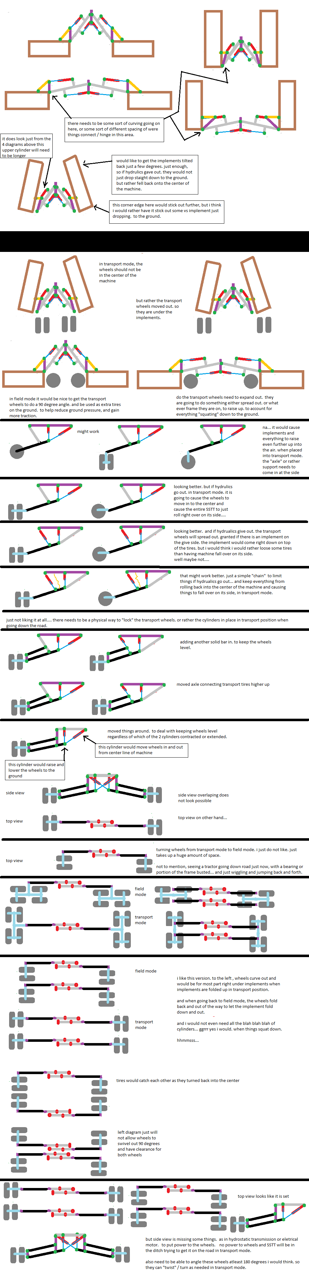

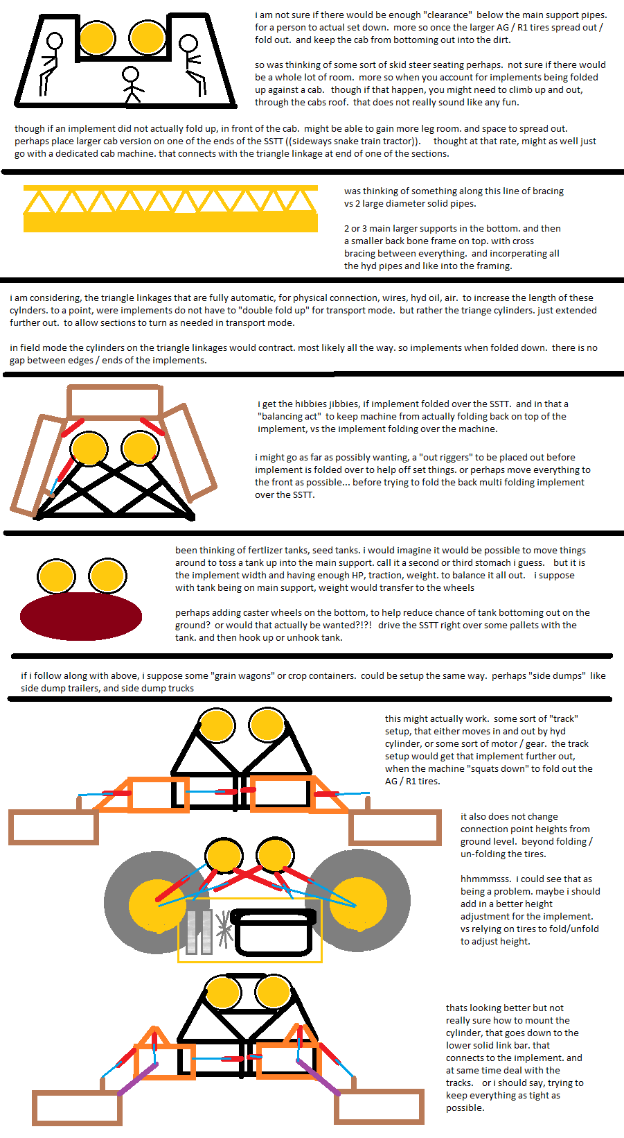

cab
==through out this entire thread, i have not really figured out a way to include a "cab" for a person to actual stand or seat to drive the unit. by the time you fold up all the implements, and placement for main engine, batteries, gas tanks, etc... you end up taking up a huge section. that would require extra linkages and things to move. in order to work around a cab.
==with above, i am more looking for a cab ((i am now calling it the ""command center"")), kinda like a tower command center at a big airport, or nasa space ship launch command center. but geared for 1 or 2 people. and have abilty to control multi tractor/implement combo units. other words a kids video game placed in a vehicle. and wireless internet connection to 1 to multi tractor/implement units.
==to add to above, it would be like playing with a RC (remote control) kids toy car. but being able to control multi RC cars from a single place.
==problem is internet more so wireless internet, make it satellite, to cell phone, to wisp, to other wireless internet, does not cover a good amount of areas, (dead zones) and the bandwidth, to handle multi video feeds/singles and sensor readings.
==with above, this is going to put the unit up into a upper tier, that will most likely require paying FCC a yearly fee, to use a certain frequency, that can handle say 5 miles radius from the "command center".
==i have not completely ruled out the idea, of tossing a "box" on end of a SSTT. to hold a person, for "safety". or having a chase or lead vehicle make it a truck, car, or 4 wheeler. that has either a pull cord safety rope when following, or some sort of rod that extends to 4 wheeler, for stopping unit completely.

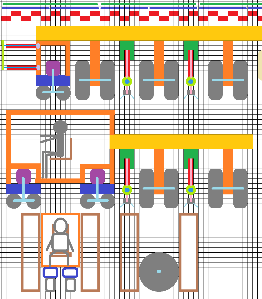

==very old chicken scratch diagram...
and now... more recent diagram...
not covered in above, is low boy trailer. and not real keen on a low boy trailer. way to many hills and ditches, and simply not enough clearance.
other thing not covered, is treating SSTT as a wagon, much like a grain wagon. this still might be a good possibility.
Ryan I was thinking you were planning on equipment large enough to pay the not using a tractor. But hauling on pick up ?
see above diagram.

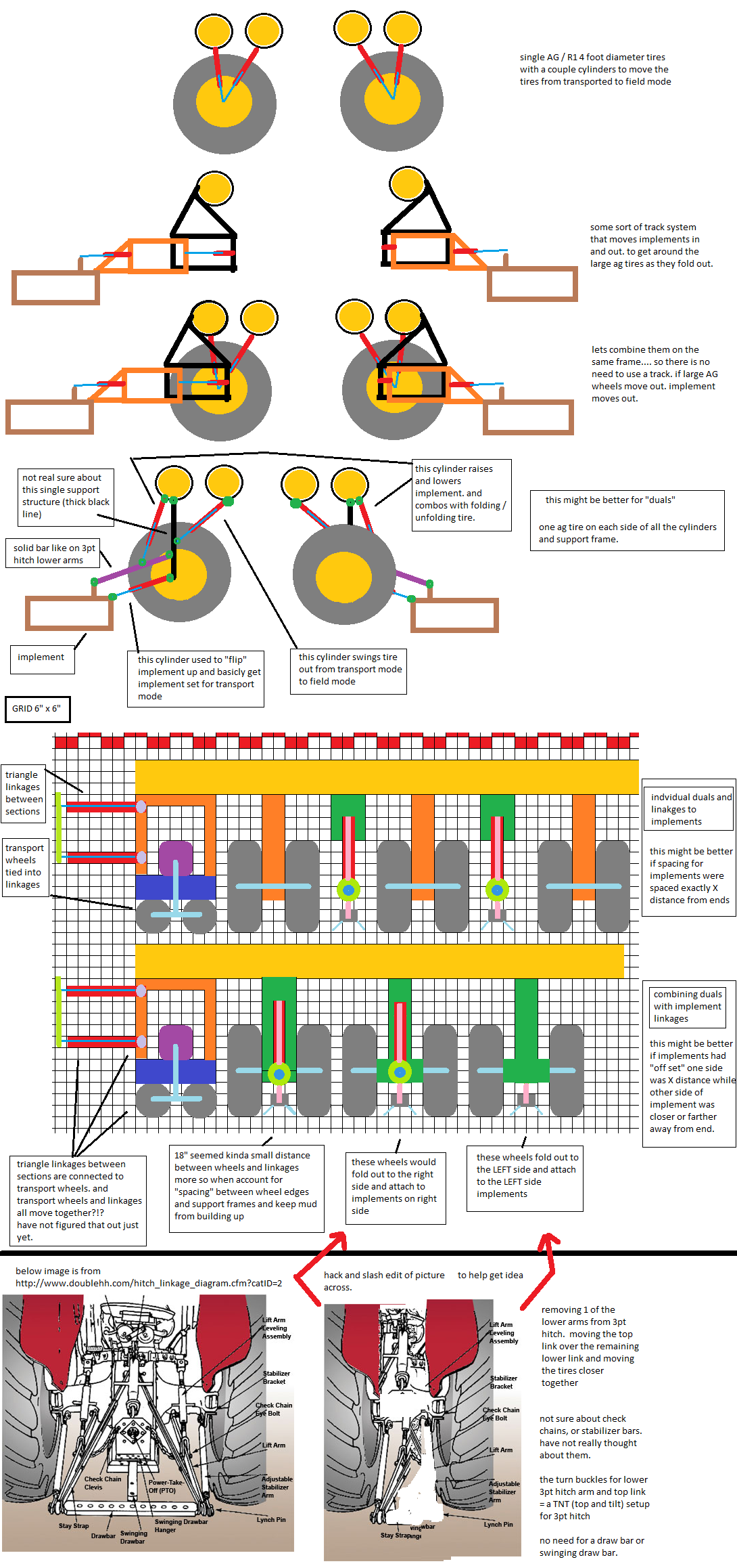

wheel types and how they are setup.
==this is now up in the air, more so looking at how the nasa spider looking rovor uses electric motors to move the linkages.
==at moment caster wheel design style has favor.
==old diagram
==the ability to sink the wheel past its center point / axle. and keep going. on a smaller diameter wheel. vs relying on 4 feet plus diameter wheels. is what has it.
==other wheel designs, seem to cause to much "junk" to stick out from the sides of a single wheel or 2 wheels mounted. and cause more stuff to drag and get hung up in the mud.
==i am leaning more towards "tracks" vs regular wheels. more so, if the nasa spider looking rover, electrical motors get used. the abilty to make a track to act like a "foot" and angle the track. so it does not run horizontal to the ground, but perhaps at a slight slope. so the track basically continually tries to climb up and out of the mud rut.
==track might be able to give a lower profile. instead of a 24" diameter wheel taking up 24 inches. a track i might be able to shave off a couple more inches to say 20 inches tall.

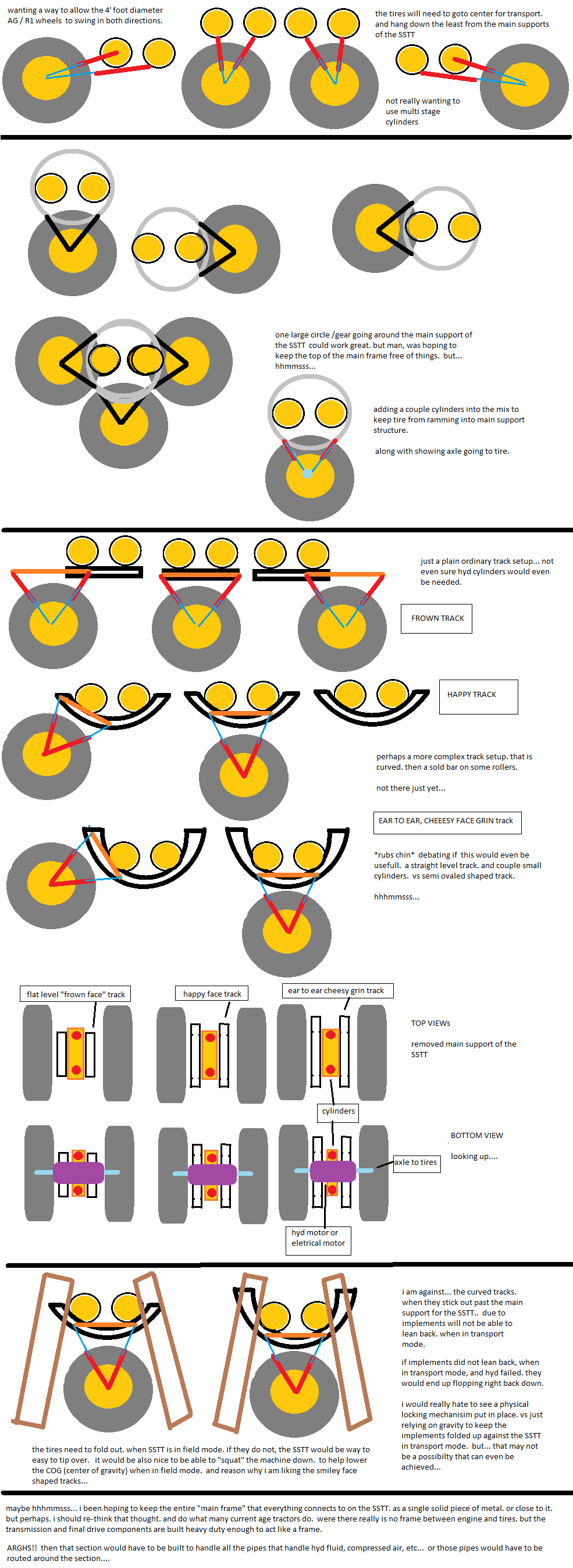

i am considering single direction of travel for the SSTT. (it has a rear and a front) for going through the field, vs UN-directional. if given implements connected allowed for it.
==i state above, due to wanting to move the center main frame of the SSTT to one side vs being straight down the middle.
==yet above is still not all there, i am tempted to almost completely remove a "main frame" that for most part stays in the same spot except for angling forward or backward for weight transferring. and in that, i am thinking of turning the so called main frame, more into multi linkages. were the implement and tires are linked directly together. and there would be multi tires and multi implements. and then just using main frame, more of as a bundle of wires, and hoses. and more act like a spinal cord going from ya brain, down to your butt.
==as much as i would like to place blamn on not wanting to deal with transport wheels, and removing them from the entire picture. and reduce things to less complexity of wheels and there linkages, and implements and there linkages. i am wanting something a tad more flexible.

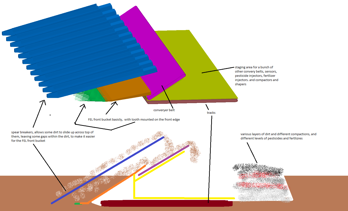

side tracked, yet again, on some how redoing how tillage / preping for seeding is done.
"dirt harvester". a new spin on strip mine farming. it will strip the layers of dirt off the ground each time going deeper down into the ground. and send the dirt through convery belts of different mesh sizes. to remove rocks and large compacted clumps. and continue to sequeeze the daylights out of some large clumps till they bust. if they do not bust. they get sent out to a row. on top of the soil. to be removed later on.
as the dirt falls back down, strips or rather layers of dirt are controlled. for compaction. in each layer, rows are formed, for injection of pesticides, and fertilizers. compaction can be done per layer and per row, to "funnel" water and root growth. if ya expect a dry year, rows and layers can be compacted in a way to more force the roots down wards. vs spreading out. perhaps purposely creating U shape compaction channels that seeds are placed in. to more focous any rain water towards the plant roots or away from the roots.
the conveyer belts. are not like a regular tiller, were there are blades cutting everything single 1/64 of an inch of dirt into fine dust. but rather, shakes the dirt, and rolls the dirt. to aerate it, and to crumble the dirt up.
if weight is king, the heavier the dirt ends up being, the more traction this unit obtains, due to all dirt goes over top of the unit. almost like a mole going through the ground.
the last crop stalks and roots, that do not break up and fall through the conveyer belts. can be sliced and diced and fed back into a specific depth layer of dirt, or sent all to the surface to help with errrosion in wet rainy years. or perhaps sent to the surface during dry years, to act as a cover to help hold in moisture.
worm and insect friendly, (the wanted types) or less they make it to the slicer dicer of last crop roots/stalks, or stuck in a hard compacted piece of dirt, that ends up getting pressed through convery belts to break the piece up.
in diagram above, the "staging area" were all the convery belts, sensors and like would be, been thinking of a printing press factory. and all them rolls and belts and drums. and then thinking about other harvesters for root based crops.

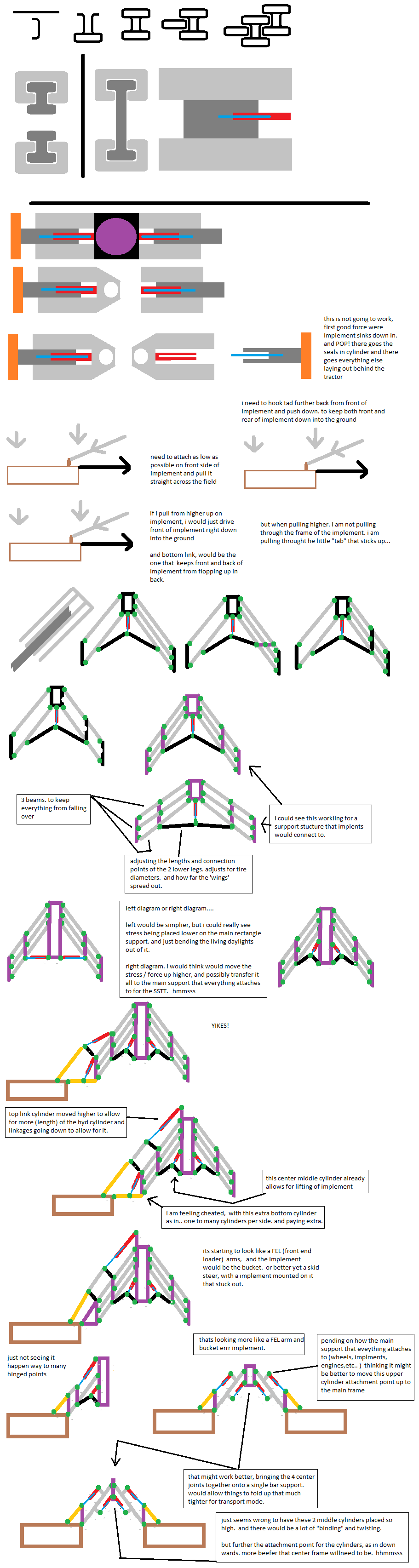

how do i make a 4 foot long motor, and smallest diameter possible. and have initial start load, at absolutely max torque being able to produce. and not done yet... have that "finite" control of adjustments. of .0001 degree or more of rotation.
combine the motor with a set of disc brakes, that also needs to fit in the 4 foot length.
--willing to compromise using a coil of tubing basically wrapped around the outside, as a way to create a cooling jacket. but not really sure about internal coolant, say through the axle itself.
4 foot long shaft is fairly long, and i am worried about vibration, and things banging into this motor, and simple twisting of things. that could cause motor to short out some place in the center of the 4 foot length. meaning most likely going to need to split the 4 foot length up in half, and have 2 motors. one on each side, but not real thrilled about running extra wires for 2 motors.
i thought about multi pancake motors, stacked one next to each other. but worried, about reducing the center shaft, and resulting more chance of something bending, and taking the motor out of commission.
i really do not like idea, of a "squirrel cage" style motor. i do not think i could ever get the "finite" control i would want.
i am thinking of a modified squirrel cage motor. and the coils of wire, instead of being parrallel to the shaft. wrapping the coils at 22.5 or 45 degrees. both in rotor and stator. part of thinking is, i will be able to wind the wires tightly without need of some sort of wedge or something to hold the wires / coils in place. and at same time allow for finite control. problem i do not know were finite control. vs needed/wanted initial starting torque is, and being able to hold that torque without much spin.
i am not to keen on wrapping the coils all in the exact same direction, i am more thinking of wrapping one half of motor in one direction, then doing a 90 degree in center, and wrapping coils in other direction. to help balance out the force, of instead of pushing rotor/stator apart at the axis. but rather almost keep them aligned with each other. reducing pressure on any side force bearings.
thinking about it, i might run a slightly bigger axle, to cool the internals. the 360 / rotoational joint, would not be spinning like a wheel hub motor.
ok for water jacket, perhaps extremely large thread shaped hit sink fine, and then a long nut that went over the fines for a better tight fit. that might work, out nicely, good solid heat sink material, and water/antifreeze running through the fines. i would imagine it would not be that bad for friction loss either... errrr strike that. that tightly wound of coil. would only be good for internal pressure pushing on a pipe. i am more worried at moment, in beending over 4 feet length. sounds more likely i am going to have to rely on U shape passage ways at the ends. so i can run the heat sink fins parallel to the shaft length. though thinking i might put a slight twist / rotation on the fines.
as ken poinited out going with a magnetic clutch / brake. but how do i time it, how do i sense things. so that current torque being placed on this joint and being held by the brakes, to the point that the motor is able to build up enough torque, and more the point, a torque that comes as close as possible to current torque being held by the brakes. before the brakes are released and the joint moves.
also can create a "spring" or rather shocks, and leaf spring style effect. out of these joint motors.
thinking about it, these tracks, are going to range widly on this SSTT. from say 8 inches wide, to perhaps up to 4" inches wide. and may be any were from 2 feet long, to 8 feet long.
man, that totally changes dynamics of things.
before i got to hang man games for track widths and lengths, and linkages lengths....
for the multi pancake motor idea, for the 4 foot long motor idea.... was think of setting them up like wet disc brakes. see below video. and instead of friction disc, discs would be stacked in a tube, and over a geared shape shaft. and then runnng wires down in the groves of the teeth. and then a spring /brush type of connection. for each disc. and using the teeth. to slightly off set all the discs. to obtain a better finite control.
for current thought for wrapping coils in and around rotor and stator.... would be something like a combine header auger...

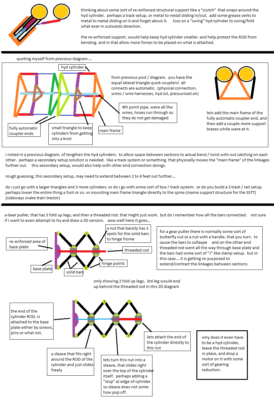

i wanted to see if i could use a simple hydraulic cylinder, that allowed "rotation" of say 350 to 300 degrees, for the track / wheel linkages. the idea seemed simple enough, and then frustation sat in, trying to figure out how to "place seals" that could handle 2000 to 3000 PSI of hydraulic oil pressure. and then getting rotation.
decided to step back, and look at coil/spiral shapes. to get a better idea of what might work. ending in below diagrams, and understandings.
to sum up above. if i am going to make idea of "push rotation" reality.
==rod that has twists / teeth will need to be small diameter (smaller the better), and long (longer the better)
==PROBLEMS, is getting seals in place, trying to hold back 2000 to 3000 PSI, and then shock load pressures that would be even higher, around a shaft that is twisted / has teeth and is small. a perfect circle is one thing, just like a regular hydraulic cylinder rod shape. but to twist the rod and put a grooved path / teeth on it.... is another thing entirely.
EDIT: additional diagrams to help get things across better perhaps
EDIT: complex'ing the problem....

2 hydraulic motors, end for end. just trying to make the most of space. with the swash plate (green) center piece, tilted at 45 degrees.
this has some promise, granted this is rough draft, and need to change what connects to what for rotation.
Above diagram, vs below diagram....
above diagram, has smaller sized overall cylinder/rod capacity (bore size/rod size), vs below diagram. though, with above if i could find a gear ratio set. above might prove more promising.
below diagrams been tad of a challenge, couple dozen 2D sketch redraws over a 2 to 3 days, in attempt to find something that might work. this one i am actually wanting to run through a stress test. just to see if it could be possible.
run into problems with autodesk, with drag and move, and "drive constraint" option. i either got "insert, or tangent" constraint errors. after so many multi stage cylinders had to move. tempted to create a short animated video but no go.
the multi stage cylinders are an attempt to fit more into a small space.
the spiraled paths/teeth, are required in order to transfer torque from the center, what do i call it,,, (large push/pull) disc. that rides on the main centered twisted rod.
this idea never will pan out, without some sort of multi stage like setup, connected to the main center disc that slides back and forth and rotates. the entire trying to place seals, to deal with the 2000 to 3000 PSI hyd oil pressure, and then higher pressure loads from shock forces. and then work out some sort of connect rod or grooved paths or something. to get things to rotate the 300 to 330 degrees.
an attempt to figure out what gear ratios might be achievable. within 7.5" diameter by 20 inches long. (motor, and brakes/clutch also need to fit in the area)
i did come across some regular bicycles (the ones you actually peddle). the rear wheel gear hub. that had multi planetary gear sets. that might be something. with shifting all put into it all. granted i really do not need shifting, just a way to reduce gear ratio of a electric or hyd motor. and obtain a nice super finite control that is extremely smooth in rotation.
i also came across some helicopter transmissions that gave some thought of how to "gear" things. to obtain a higher ratio.
i thought about "worm gear" type of drive train, but gave up on the idea, not sure how i could achieve compactness and keep stresses from tearing things apart.
hhmmsss ovalish?
i figure i am going to need enough power. in the following scenario....
going down a very steep hill in transport mode. and need to raise the lower front up, perhaps to get over a creek or wash out. a single wheel/track is for most part going to need to support entire weight of the SSTT, and forces going at unknown amount of MPH. this cylinder shaped rotation device for linkages needs to be able handle
alright time to go searching for "solenoids" and look more into gears and seeing what ratio might be obtainable.
hopefully i will come across the elusive youtube video. that had like 40 to 1 ratio. in a smaller foot print than multi planetary gears. had pegs and a gear or something that ran between pegs and a ring gear maybe, i don't know, it was an autodesk or solidwork type of animated diagram.
this is not the video i was looking for but... hmmsss... so few teeth in contact, and so much torque. *cringes* but hhmmsss...
http://www.youtube.com/watch?v=P-Obt-9tZVo

side tracking once again, need to look into conveyer belts with small sized buckets bolted to the rubber. to dig into the soil, and raise it up. without trying to get the dirt to go through an auger, or through a simple belt with tread perpendicular to the belt/track. hhmmmsss that might just work, but how to get a full scoop, that does not involve pealing the dirt off, and having it forced into the bucket. vs some how driving a blade in horizontally and then lifting 12" of dirt at a time or more, straight up vertically.
Wallace Truck & Equipment
google search for "wallace rooster picker" i can only find one that is for sale and not mfg.
EDIT:
thinking along the lines of a roller cooster, or rather i should say, a "track" that causes a motion of a bucket to act either like a backhoe bucket, or a FEL bucket. were, the bucket moves in and out.
the bucket punches horizontally into the dirt, and then rotates up and out of the way, taking a bucket full of dirt, without "smashing" the dirt into the bucket causing the dirt to fold and roll inside the bucket as the bucket goes into the dirt. instead, it is a nice smooth, punch into the dirt, and lift out, and very min of cutting/shaving the dirt wall.
instead of operator moving the boom, dipstick, bucket cylinders of a backhoe, the motion would be controlled by the tracks

bottom plows.... ((single long picture / diagram))

air seeder doings continued / box planter

i have scribbled out rough frame for the SSTT and linkages to wheels connected to the frame. i got a little frustrated with linkage between each 10 or 15 or 20 foot section, that makes up total 60 foot width. i am needing something that allows degrees of freedom in 2 axes (cone shape) and then the 3rd axis linear motion (hyd cylinder type of action)
trying to put power to all degrees of freedom. so they can be controlled and locked. just never came up with anything yet.
i scribbled out a trailer just to set it beside the 3D scribbles of the SSTT, and it looks promising. autodesk just does not like me, and kept crashing or giving me constraint errors. when i tried to drag things around to see how everything would drive through a field.
it took me a couple days to figure out how to setup "discs" to adjust angle of the discs, but almost compact them, in such a way that it would better work for the SSTT length. i think i got general idea down, and should work pretty nicely, in the simple basic form, and could be improved upon to point of controlling angle of every single disc separately from one another. and possibly adjust depth each disc goes down as well.
last couple days been working on trying out how to deal with bottom plows. this one has been a challenge. but i think i got something finally that allows for "turn over plow" like doings, and fits within the SSTT, i just have not decided on which path i may take of 2 different ideas. though i do believe i have already chosen the path i am going to shoot for. so i can have "controlled maintenance of re-shaping a field over course of so many years, or so many passes over a field. i have not gotten to the point of putting in trip points with springs. or adding a coulter/disc to edges of cut. but so far looks promising.

attached picture....
the main frame of the SSTT this is FOUR 15 foot section version, that i have been considering over THREE 20 foot section setup.
disc, that can adjusted to any "angle" wanted. i kinda butchered the disc pretty good, so i could approximately space the discs, to line up with edges of individual bottom plow beside it. i tried other ways to "angle" the discs. but every time i did, i ended up not finding enough room to fold things up.
bottom plow, from the first post i noted, i simply was not real eager to follow current age bottom plows, to turn over plows. i need something to fold up better. i needed to make 2 sets of bottom plows, so you could do a 180 at end of field, and switch over to the other set / row to keep all the furrows going in same direction. not my best work for "trip plow" so if a bottom plow snagged a rock or root or something else, the plow would flip back, but at this point was more focused to see if a bottom plow like this setup could possibly work.
i tried to make a FEL (front end loader) heavy duty bucket. to try and describe the bottom plows, and how they work, but how i was going to explain things has done left the building.
i tried making some sort of "hay rake" along with some sort of multi blade bush hog, to deal with hay, to try and see how things might line up. and overlap one another to perhaps save on cost and keep things more simpler.
decided to toss a few boxes on SSTT, just to see what it might look like. and figure out how much space i had.
hopefully as more things get figured out, better detail will be done to move things more closer to a finalized rough draft of things.
