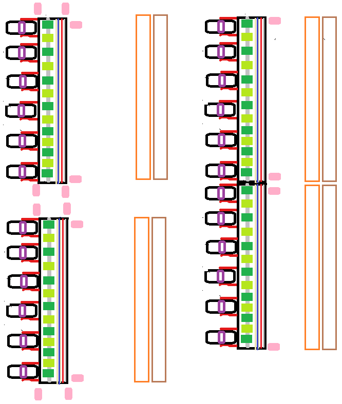

instead of 20 feet wide, i think i am going to press towards 40 to 60 feet wide per machine. thinking semi trailers, and there total length. along with current tractors and towed behind implements as they go down the road. at same time break away from utility class tractors, and jump up into 100HP plus tractors. figure utility class tractors for smaller fields still have there use, plus being "utility" kinda of jack of all trade tractor in that range. and could be dedicated field tractor or land scape tractor or other.... utility class tractors still in cat 2, not really cat 3 3pt hitches. while getting up into 100 HP plus tractors, ya getting into "field" only tractors with cat 3 pt hitches. that are specialized for prepping fields, planting and harvesting...
jumping up into 100 plus HP market. means, being able to split that total HP up multi times, so smaller size engines can be used. and then those multi engines placed across the machine.

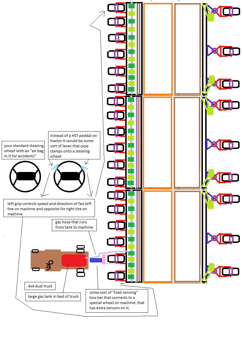

CAB for the machine
--turn a regular pickup truck into the cab for this machine. and use a tow bar between back of truck and one of the wheels on machine. the truck would not actual tow or pull the machine around. but rather guide the machine around.
--i am thinking a wireless internet connection between pickup truck and machine, just to reduce amount of wires between machine and truck.
--exception to above, "emergency stop" button, wires going between truck and machine.
--with machine being 40 plus feet wide now. instead of 20 feet wide, i am thinking there would be enough room for large "fuel tanks" on the machine itself. vs placing a large fuel tank in back of a pickup truck. but i am not dis-missing that thought just yet.

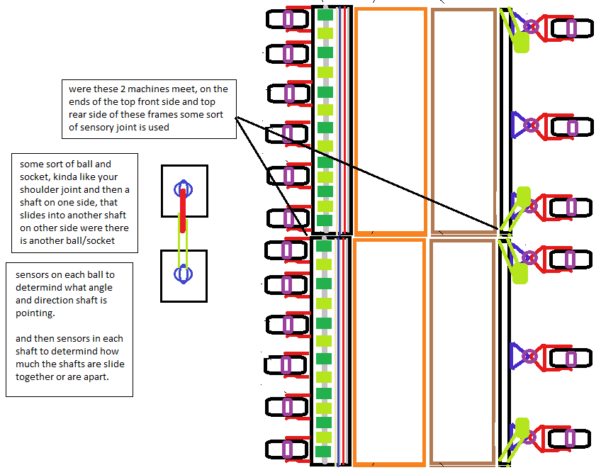

debating over 40 feet wide machines. mainly due to part of "hills" current implements that are "bat wing styled" and fold out. have some flex to them. but also the needed "joints" that allow those wings to raise up and down some. but for life of me. if you have that large of tractor to begin with already. surely it is flat enough fields that is not that hilly enough to cause part of machine to come up off ground or hit low spots or high spots were implements do not touch or going into the ground deep enough. but... hhhmsssss....
--would there be a need for a "flex joint" spaced every 10, 15, 20, 25, 30, or 40 feet? to allow machine and implements to traverse hills better? flex joint = allowing machine to curve up and down along its width. and how much degree of movement would it need? 5 degrees? 10 degrees? 20 degrees? up and 20 degrees down? degrees being how steep are the hills a farmer would need to traverse within a field and still be able to prep, plant, harvest these various hills and like in the middle or around edges of fields...
----the more degrees in difference. and longer distance between flex joints, greater chance a strip of ground would not get tilled, planted, harvested....

nothing set in stone as far as dimensions. just trying to better grasp what machine would look like. and how much wiggle room there might be.
engine length figure 4 to 5 feet wide, when looking up 450HP divided by 6 engines = 75 HP per engine. looking up 75hp engines quickly on google came back around 4 to 5 feet in length (eerr width in this case)
another 1.5 feet or so for fan and radiator and hyd oil cooler
another couple feet for variable displacement pump
18 tires seem kinda extreme, but similar setups are up to 30 plus tires.... and hopefully implement for this machine would not need the extra tires on front of implement, and just need rear implement tires.

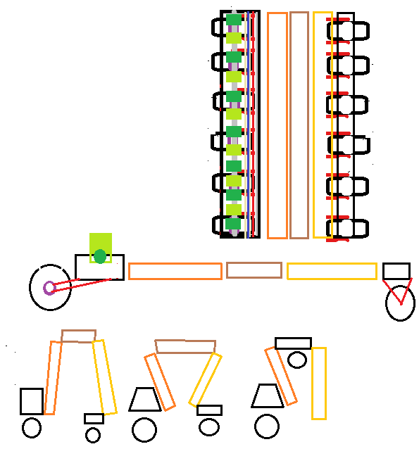

i think i finally have something....that could work for folding/unfolding, angling the enginebox/front drive wheels, raise and lower implements.
i think i am wanting to keep the "wheels" out of the mix" of it all. at least for now. *rolls eyes*
looking at the entire machine and seeing 3 sections 13.5 feet apart is bugging me. if i could go with 20 feet sections. a lot of extra complexity could be removed. for just dealing with the limited movement joints. and would only need say 8 cylinders instead of 12 cylinders.... but hhmmmss complexity vs larger and beefer cylinders... hhmmsss....
