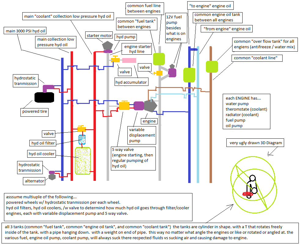

while most of the stuff will be computer controlled. some things it would be nice to have a manual over ride leveler on some things. example for upper / lower link cylinders near area were they would be need to connect to an implement.
perhaps near cylinders for the "balance wheels"
ability to move far left tire forward/backward, or far right tire forward/backward. to make attaching implements easier. besides getting back into the cab errr (truck) that that might be a optional package.... then again...
been thinking about different package option. for the main front drive wheels. and being able to swap them out for "tracks" kinda like the tracks you might find to replace car wheels for them far northern that see snow/ice majority of year....
trying to figure out how to deal with all the piping to get over the "flex joints" in the machine. more so hyd oil for the hydrostatic transmissions. i could see far left engine being on. and then wanting to move the far right tires. and needing large enough pipes to get oil from the far end to the other end.
thought about making the joints hydraulic joints. instead of greasing them. making them large enough on the (inside) to allow hyd oil to pass through them. but also hinge a few degrees.
another issue is how to lock the joints. when in transport mode. so the middle section does not drag across the pavement... this goes for implements that are attached as well. do some transport tires just drop down? or another set or 2 of balance wheels fold out? or does locking the flex joint / hing make things sturdy enough that entire machine becomes one solid mass. and you just need balance wheels / transport wheels on far ends of the machine?
hhmmmss never thought about weight per tire / axle limits that are out there.... arghs!!!! down with the bloody pirates!

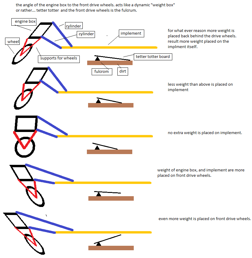

before i forgot, need to figure out a way to lower the "balance wheels" to below the engine box frame if possible. or the main frame that holds the engines. curving / denting them in some. to allow for balance wheels to swing out... instead of 2 limited hinges between each section of machine going with a single hinged spot. both to help with connecting / disconnecting multi sections together. but possibly give room for balance wheels.
traction, weight, compaction....
what originally started this idea off....was weight distribution. part of it was, just looking at current age tractors. and seeing this heavy box between 4 to 12 plus tires....
see attach diagram below...
continue onto next attach diagram below...
continue onto next attached diagram below...

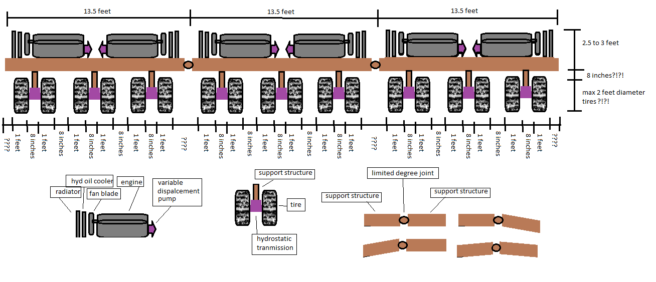

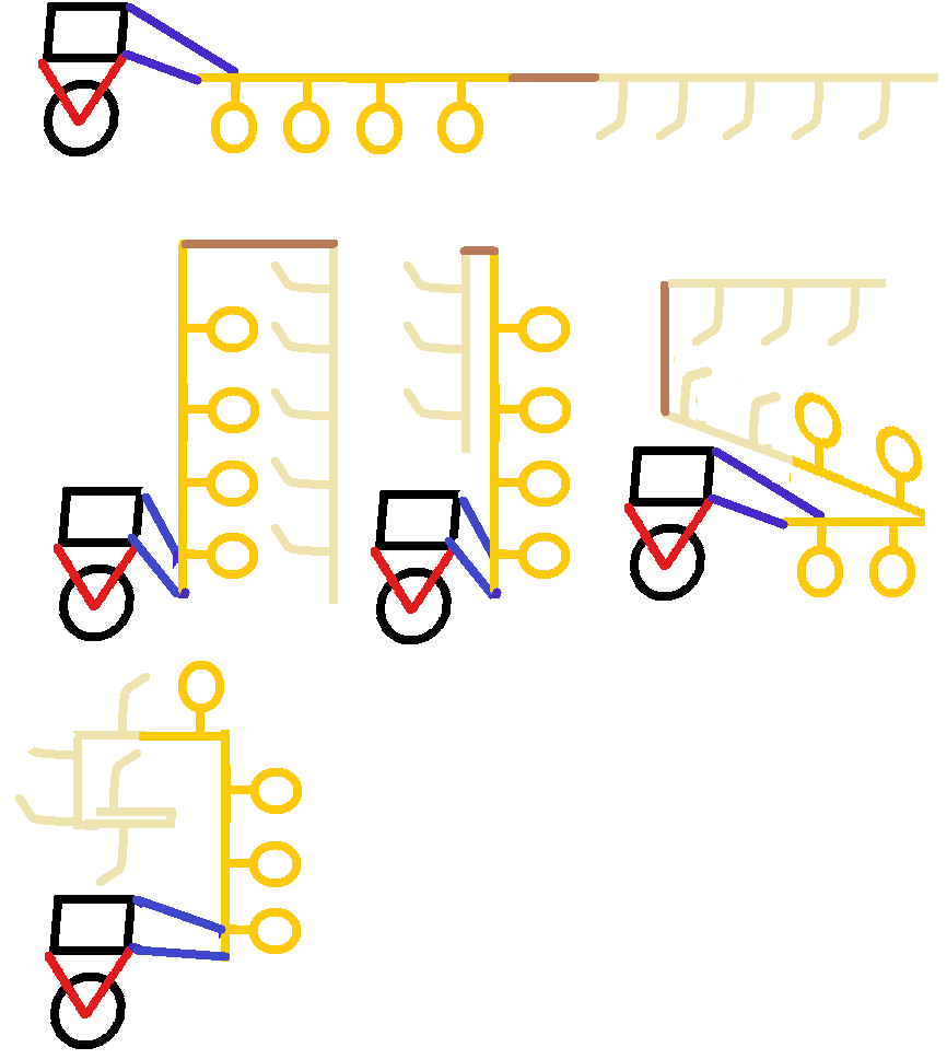

lost post that went with above diagram. didn't realize internet went out due to rain / power flickering. and hit reply button, and it was washed away :/

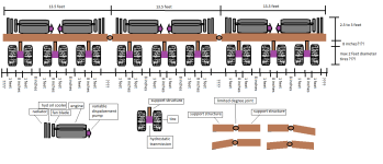

from 13.5 up to 30 feet length and now looking at 40 feet length. just to find room for transport wheels, and balance wheels.
drew some implement diagrams and how they would hook up, along with engine box tilt. and looks like space between front drive tires and main frame that engies and everything connects to. this space looks like i will need to be increased some. though moving frame (front and back) frames closer together might give some needed room.... it is not like an engine is actually a box. but has more of a half circle bottom on them.. i would just worry about "twisting" the frame over the distance if they get moved to close together. if not nearing that at 2 feet distance from outside front and outside back of main frame...
still undecided on "balance wheels" and transport wheels. been tempted to go at 3 to 4 feet width keeping engine box 2 feet, and giving an extra foot on front and extra foot on rear of engine box for transport wheels and balance wheels.
never thought about it. about tipping engine box to 45 degree angle over front balance wheels. and folding implement up right on top of the engine box. and use front balance wheels as one side for transport wheels. and dropping a couple wheels down on rear side of engine box for the other side for transport wheels.

yet more and more attempts.... to deal with front balance wheels
thought about moving front drive wheels further in front of the engine box. so entire engines could tip further forward. to a point were some transport tires could be lowered. and just carry the implements folded up on top of the engine box... and actual length and weight of implements all depended on how much balanced wheels unfolded out for "transport" to keep things from tipping over when going down the road...
getting to the point were there will be 2 sets of axles. like a typical tractor / car / truck. :/ trying to keep as much weight on the main drive wheels. as possible or weight transfer to implement... the whole quickly being able to swap between transport mode and field mode, and attach/un-attach implements. is proving more difficult than what i thought it would. then again never really thought about it. how many folks i am sure went over this time and time again....
i realize even current tractors still get front weights placed on the very front of them. even the big boys.... just to keep front tires on the ground. but this machine. is in idea "multi tractors" with just the rear tires, transmissions, and engines. and the front wheels just serve to keep the stinking machine from falling on its face. and also hopefully reduce the bucking bronco effect of compaction.
small tractors in 20HP to tractors 450HP range. all of them some were along the lines get some sort of front weight added to the front of the tractor. to keep the front end of tractor from coming off the ground. the larger the engine and lower gear the transmission is placed in. the more torque at rear tires. all this means being able to lift more weight on the front end of the tractor off the ground, if there is sufficient weight / drag from implements to do such a thing. but this machine is reducing over all "torque" at the rear axle. by spreading the torque across the entire length and multi wheels. this reducing the "counter weight" on the front that would be needed across the entire machine... but reducing amount of counter weight that is need on front of machine and also, reducing how far the counter weight sticks in front of the drive wheels. hhhmmsss....

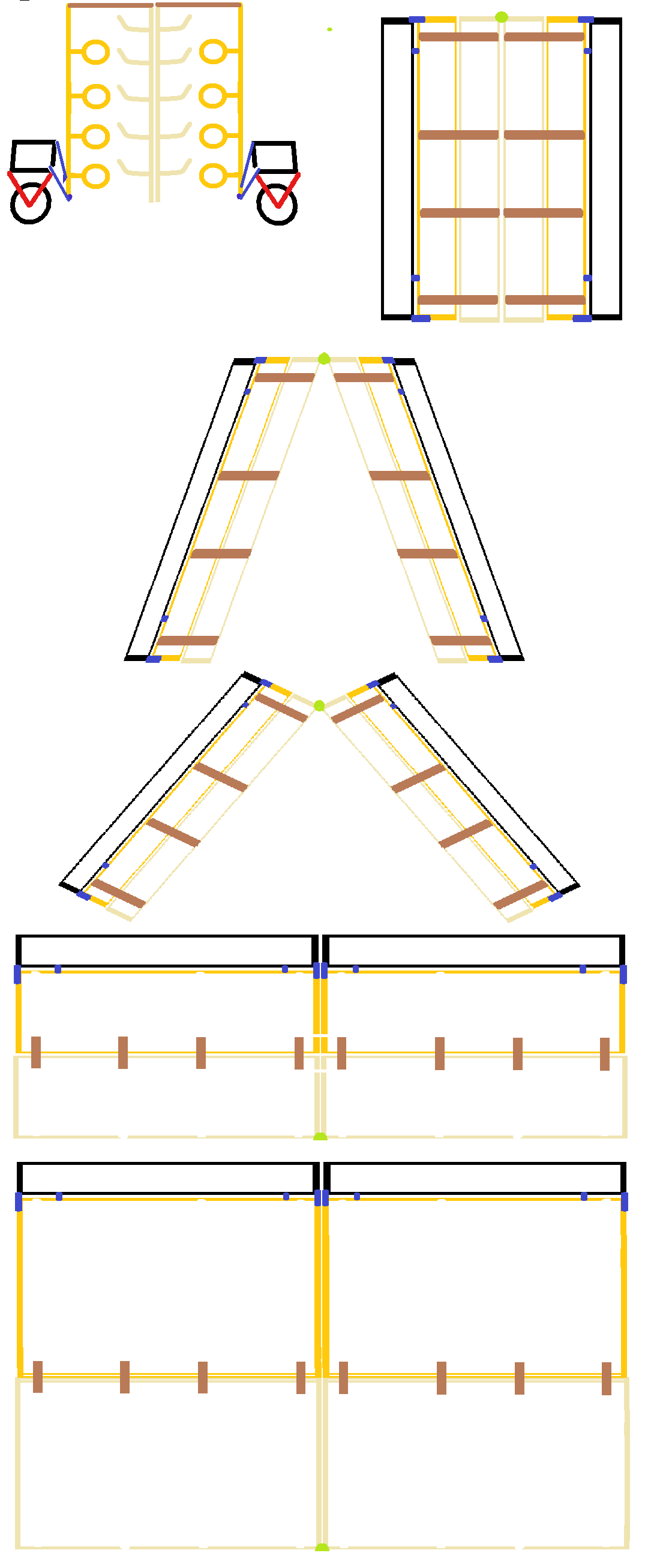

it has been bugging me for some time. and that is how this machine would actually "trailer" behind a large size truck or another smaller size pulling tractor. in previous version trying to stay with 2 feet width engine box. not really able to. but with engine box becoming wider / taller. there could be enough room. to drop down 3 or possibly 4 axles. on one side of the machine. and then have some sort of "tongue" or something that extends out for bumper hitch, or pintail, or 5th wheel like setup.
also if you had 2 or more of these machines being pulled other words....
truck <- first machine <- second machine <- third machine?!?!
normally wagons. have a solid axle in back, and then front axle pivots with tongue that attaches to back of truck. so the wagon "follows" the path of the truck tires.
in the old machine, i thought about tractor driving up along side of a trailer. and just roll up the side of the trailer for transport. been thinking kinda same idea but instead for the newer version of this machine possibly...but would really like to avoid a custom trailer, just to place machine on. to get it from field to field and back to farm. there is a good amount of combine heads, to seeders / no till drills around here that have there custom trailer. that they get loaded on. due to they, do not fold up or not enough to get them down the road...
main want is being able to connect multi of these machines side by side. to go down the field as one solid mass per say. and trying to disconnect and maneuver each machine onto its own trailer sounds like large time consumption task.
perhaps different towing packages. for machines. so one package is built for 3pt hitch for tractor, another for bumper pull another for pintail. but then a package that connects 2 machines together for in the field, and also being able to tow one behind the other...
is it even possible to tow say two 40 foot trailers, or even two 60 foot trailers. behind a single truck or tractor down the road at the same time?....
would there be optional CAB unit that has its own little engine, just to move it around the machines and to follow or stay in front of the machine. and then used to tow the machine? by using engines on the machine to power the CAB's larger tires? or rather engine on machine to power the transport wheels? eewww getting into them "huge long cranes" that has multi drive axles. with independent steering per axle. to get the crane through very tight corners...
hhmmsss..... i could almost 2 axles, 2 tires per axle per side for total of 8 tires. on far end of machine and the another set of on other far end of machine. that could spin 360 degrees. and be used both as "balance wheels" and as balance wheels. and wheels would have a hydrostatic tranmission. hhmmsss...
perhaps instead of duals floatation tires? hhmmss.....
who says duals? multi tracked unit....

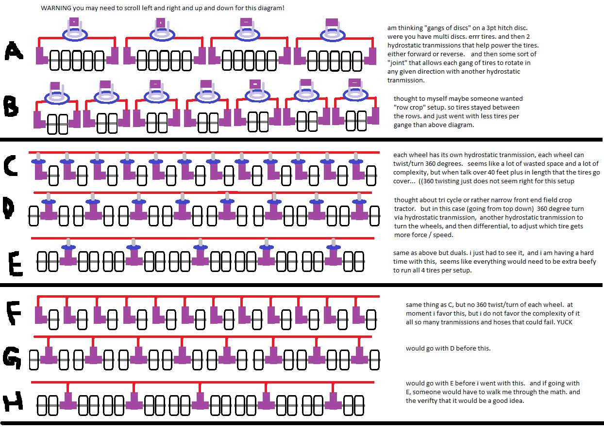

alrighty then! i am back to my sections of the machine. that can be down to 20 feet per section. not sure on min width per section. till wheels get figured out, and placements for links for implements. on all sides of machine. and length per section would be as long as someone wanted or multipules of min width per section.
argh! not again! either i could have "middle sections" and "end sections. or all in one sections that did not matter were they were placed... all in one sections sounds like a bloody costly adventure. wonder if i could make the "limited joints" between sections, along with "end links" for towing as select your package / addon on doing. and be able to bolt / unbolt. things. to switch things around if a customer wanted to... vs welding the end links and limited joints to each section...
hhhmmsss. limited joints.... main purpose is to keep implements and the sets of tires, from taking a sudden quick slope. and cause things to bind up on each other. and goal of limited joints. would be to keep that from happening.... since there is no "hyd cylinders" in current limited joints. why not place end links (for tow options or end implements) but also use these end links to create a "limited joint" by use of some solid bars between end links. of each section... it would make more sense. placing limited joint lower on each section. vs placing it high up on machine. the end links would already need to be beefed up, to some extent for towing or an implement being placed on the end links. hhmmsss....
before i jump to diagrams for limited joint and like... for implements that do not require a lot of extra HP to pull the implement through the ground or what not. perhaps adding in a "short section" that is called a "field cab" though field cabs cost $$$$, due to needing short width implements to cover width of cab would take up. along with just the comforts of a cab, (A/C, heating, all the controls, and buttons, etc...)
not sure if "cab" would have any sort of drive wheels under it. maybe instead of 8 wheels just 4 smaller wheels? or perhaps just a couple caster wheels that spun 360 degrees. just to help deal with weight... i could almost see the cab being able to do 360 degree turning. kinda like a tracked excavator cab. *eyes light up*

#57
13.5 feet diameter. from center axis per wheel set.. (OUCH) on total width for "transporting mode"
tires = 1.5 feet width, 2 feet in diameter.
6" spacing between tires,
6" between tire and hydrostatic transmissions.
6" all the way around for clearance.
3.5 feet for transmission
end result = 13.5 feet diameter or dead man circle for wheels. were nothing can be placed in that circle or interfere with 360 turning of wheels.
the major implements. that fit on the sides (in transport mode) are going to need lower links that stick out some...from the main frame. if taking that into account, might give a few inches there.
i suppose implements could be placed in "total raised" position. to give clearance over wheels. but *yikes*... just a bad seal in a hyd cylinder, or 0-ring/seal in a valve, and machine would come to a dangerous crashing halt. way to risky to many seals / 0-rings / gaskets. not to mention possible hyd accumulators added into the mix. totaled raised implements (beside being titled back) to dangerous...
perhaps making a "indent" into the frame for were wheels would turn. that would give extra clearance when implements are tilted up.
3.5 feet for transmission area seems pretty large... so is spacing between tires, and spacing between tire and transmission. the transmission does not have to be "box shape" i could possibly squeeze it down to 1.5 maybe 2 feet?!?! and squeeze distance between tires down to 2 to 3 inches, (errr clogs getting stuck in between tires?!?) and then distance between tire and transmission... hmmsss....
/ new tractor idea possibly....
#58
down to a 9.5 feet diameter of a dead man circle for wheels.
googling other implements past few days. widest i think i saw when fully folded up was 16.5 feet. leaving about 7 feet for implement to be placed on one or both sides... for transportation with the machine....
i would love to go back to the 13.5 feet diameter. but could i add 2 more axles. to the transmission. and some how pivot them at the transmission. so the raise up for field use for 4 to 8 inches up. and then lower them down for transportation. and still keep the 360 spin. and all wheel drive, with each half axle having independent forward/reverse
i am almost positive there is a special "gear type set" that would allow transport tires to angle up and down. and still get power to the transport tires.

20 feet width, with 8 feet long frame (not counting how far links stick out from frame.)
thinking about calling it
--STB (side train box) tractor
--STB (side train boggen) tractor
----kinda of an upside down box, if you have implements around all sides, you would have "flaps" like a box
or
--STT (side train tractor)
----thinking more along the lines of, multi units in a line, like a train, but moves side ways through field.
and of course
--STD (****** transmitted disease) tractor
----ok, i hope that name does not stick, kinda like FORD (found on road dead)
----saying STB or STT fast and could easily sound like STD :/
